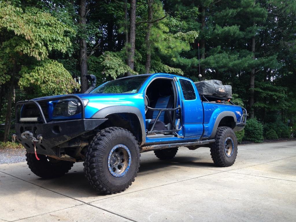

    Just keep in mind the switch at the bottom that triggers the dome light. make sure to turn off dome or any other accessory triggered by this so you don't drain the battery.
    I know the power mirrors, power window switch and speakers all have harness plugs that you can just pull and zip tie to the dash or wherever to keep them out of the way.
    could always get something like this :)
    http://www.4xinnovations.com/Tube-Doors_c_30.html

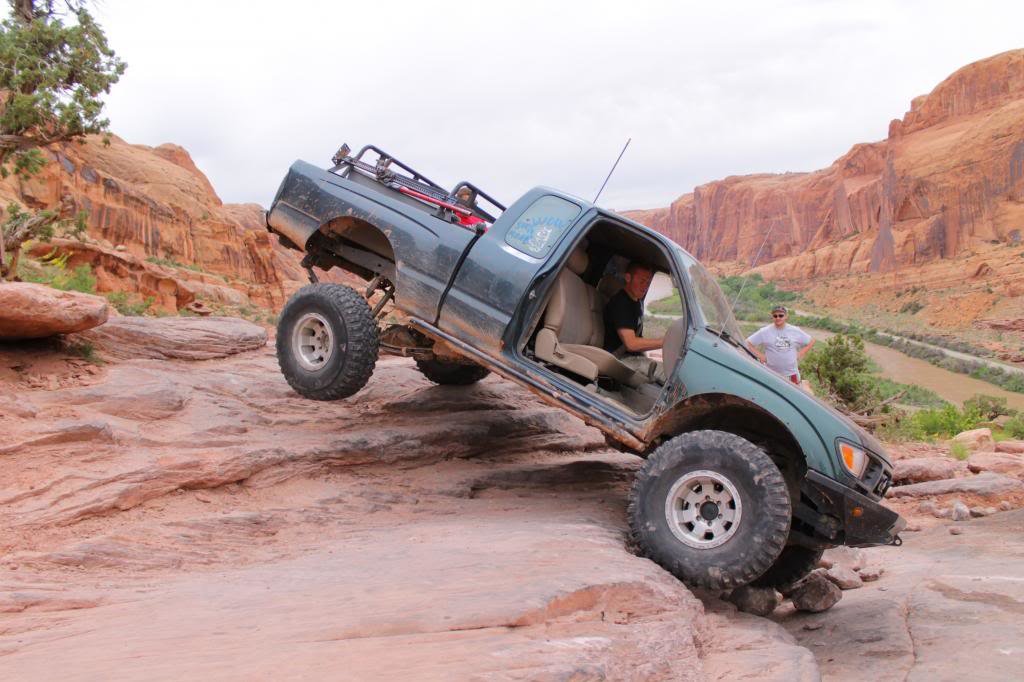

    Others on here have done it. I will search a little..
