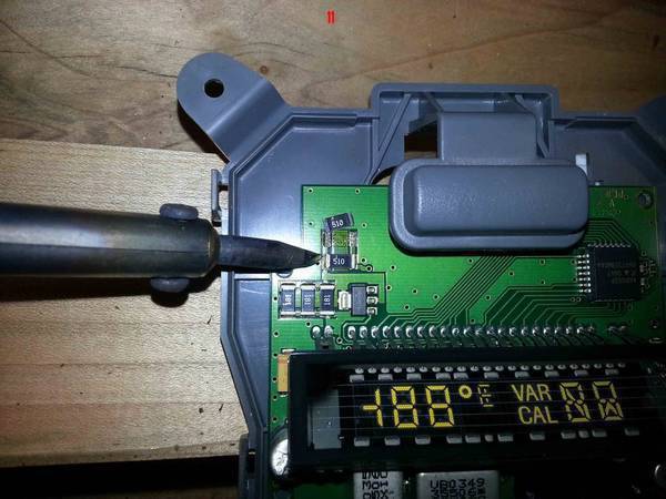

    I just fixed mine in 15 minutes.

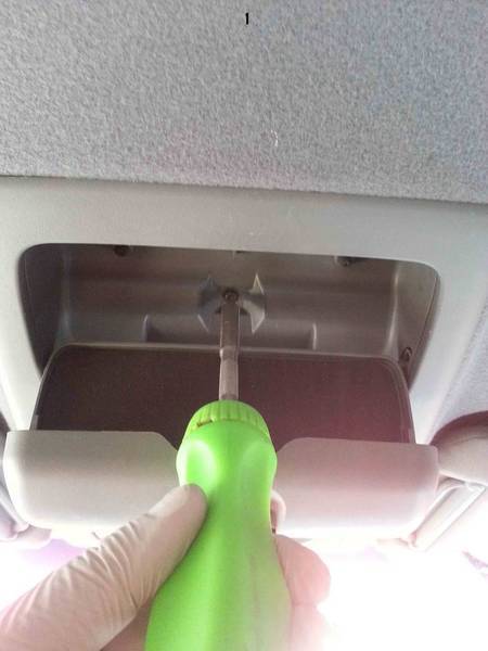

    A Philips in the sunglasses holder is the only screw. Then pull down on the very front to pop out the two metal clips. Unplug the two plugs and go inside to a good workstation.
    Your soldering gun, flux and solder are used here so clear out some space and plug in the solder gun (pens are better but any iron with a fine tip is good.) Solder guns from Harbor Freight are a crazy $2.
    Let it heat while you remove the 3 torx T-9 screws holding the meter assembly to the plate.
    Pull off the meter, remove the dark, transparent casing very cautiously. Any broken plastic could mean rattles you hate.
    Pull off the meter wires looped around the backing plate of the meter assembly. Lightly rotate the forward portion of the circuit board over the retaining tabs and free of the pushbutton. Be Careful and DON'T touch the board with bare hands.

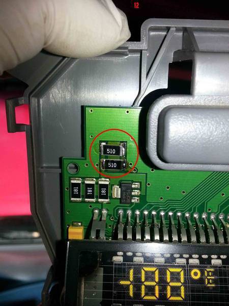

    Locate the two black rectangles (resistors or whatever usually marked "510") that sit near the rear DS side of the board.
    Carefully push the resistors back flush if they have risen at all, brush on the flux and heat the old solder a bit. Put some more flux (but you only need a very small amount) and melt a small amount of new solder on the broken joints and really just each side of both.
    Carefully replace in reverse. Mine worked without spending anything for new parts, but I already had all the tools cause I don't know how to relax. Just check the post time of my reply. You can remove the resistors and replace just by melting them off with the soldering iron. Good luck. I'm stoked!

    This began when I retrieved my nice fishing Oakleys from the sunglasses compartment. They had been baked, peeled, and broken from the heat. I don't even live in Arizona.
    Then I noticed a blank black screen where there should have been a temp and direction heading. Then I came here and did a little research.
    LIES! ALL LIES!
    This job took me 20! minutes, bunch of lying thieves around here, be warned. Ok--I did take about 5 minutes shooting these photos.
    Remove the one screw from inside the sunglasses holder:

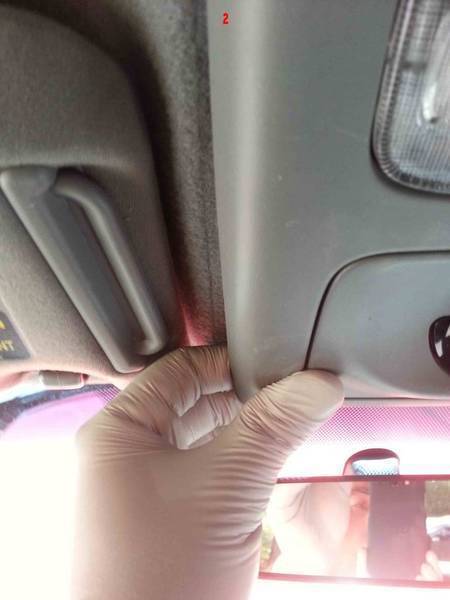

    Then pull down on the forward corners:
    These hook under the ceiling, they are why you pull on the front and not the back:

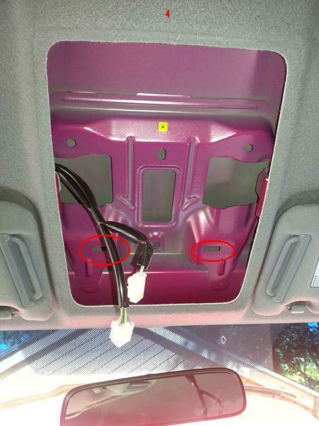

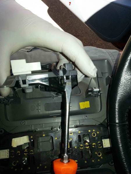

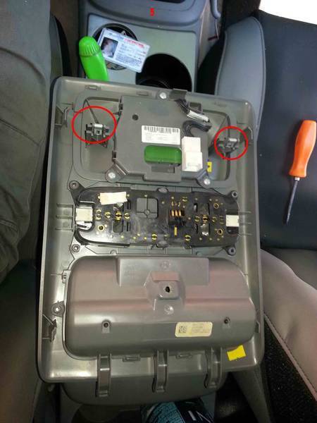

    Unplug the 2 plugs and separate the entire unit from the ceiling. The circles are where the metal hold-in tabs snap in. When I pulled mine they both flew off and landed on the floor.
    These are the metal hold-in tabs:

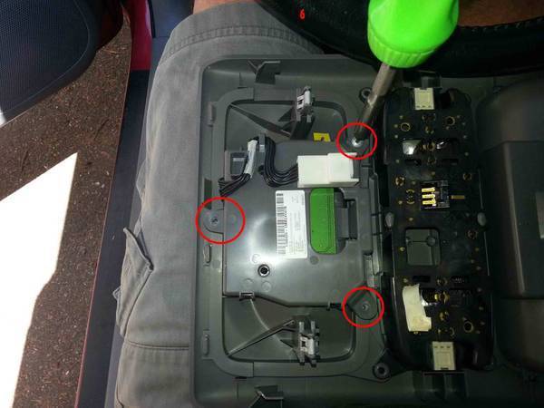

    Now unscrew the 3 torx screws from the back of the accessory display:
    Turn the unit over and carefully pry the plastic tabs out to remove the smoked plastic cover:

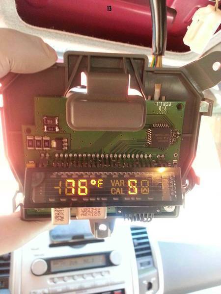

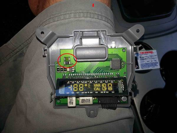

    The display unit revealed. Something is missing here, hmmm.

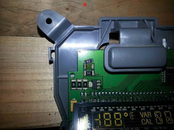

    So I knew I heard a rattle early on and searched the panel and truck floor and found this, it should go in the blank area above the other resistor.
    Resting above where it should go prior to soldering:
    I did heat up and put more solder on the one in place--just because:
    Not a clean, factory job, but it makes the current flow:
    Plug in and check just to make sure:
    Put everything back in reverse order and Voila! Job Done. Where is beer?
    Happy fixing stuff! :D
