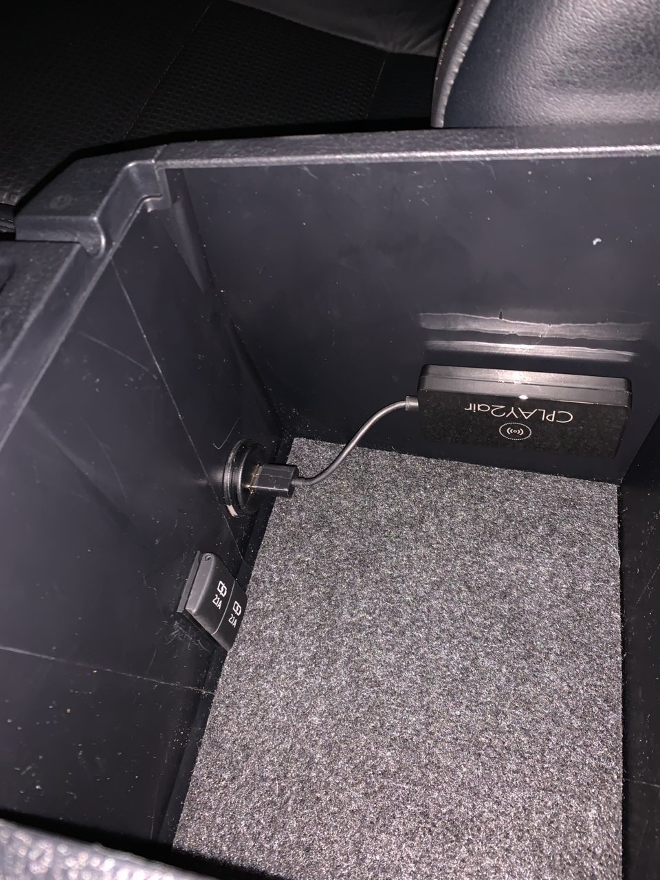

    Plenty of us have moved the media USB port from the dash to other parts of the vehicle. (Usually into the center console) There is a cable you can order from Alibaba that will plug into the back of your head unit, and you can then connect a USB extender to it and run it anywhere you want. This will disable the USB port in the center of dash usually used for Carplay/AA/Media.
    There are a few threads on it, just search for media port relocation.
    https://www.tacomaworld.com/threads/2020-tacoma-media-port-relocation.648547/
    I moved mine into the center console to use with an AAWireless device for wireless Android Auto.
    https://www.tacomaworld.com/threads/plug-n-play-wireless-androidauto.683867/page-2#post-25629302

    I did this as well but with a CPLAY2air

  20. Jan 13, 2022 at 4:05 PM
    #20
    Sparks81
    Sparks81 Member
    Jan 2, 2020
    #314930
    16
    2020 DCSB OR
    The stock USB ports? Yes, those covers are stock. If you mean the one I installed for the media port relocation, I did remove the cover.
