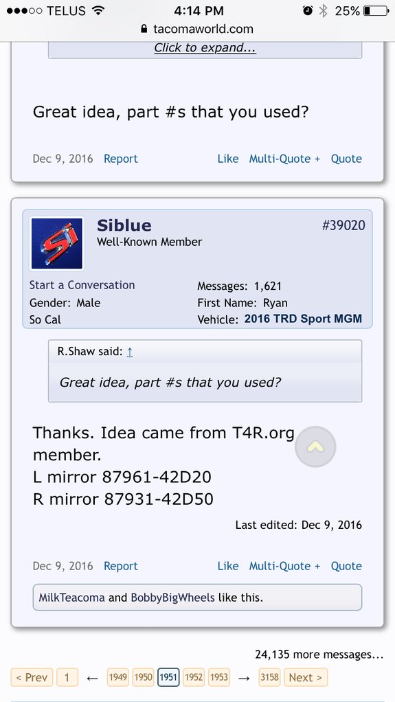

    You all got part numbers for said mirror glass?
    I'm failing at the google game today.

    CZ5ANM Taco
    CZ5ANM Taco Well-Known Member
    Apr 1, 2016
    #183036
    540
    BC, Canada
    2016 DCSB Manual 35x11.5s
    Front Suspension King Ext Fronts 700# Icon UCA delta joints JD fab spindle gussets All Pro cam tabs DuroBumps Warfab steering sleeves Rear Suspension Old Man Emu leafs -Radflo Ext travel rears Timbrens ubolt flip kit SCS stealth 6 Wheels 35x11.5 Maxxis Razr [ 34.5 x 9.75 on 8.5 rim not on truck] Heavy Stuff Relentless front bumper Smitty 3rd Gen winch Big County Customs skid plates Arc One industries rear HC bumper RCI sliders Misc Arb dual compressor Arb rear locker Pelfreybilt fuse panel tray Cali raised ditch light mounts Cali raised bed stiffeners 5th Gen 4runner LED fog lights Racks Retraxone XR tonneau Yakima load bars Sherpa Roof Rack Camping Smittybilt Tent Dometic CFX50 fridge
    There you go
    Enjoy
    Search tacoma world for tacoma stuff Not google lol
    Heater still works too in glass if equipped
