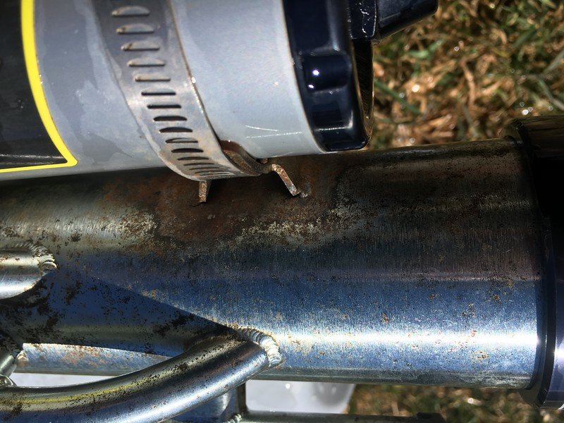

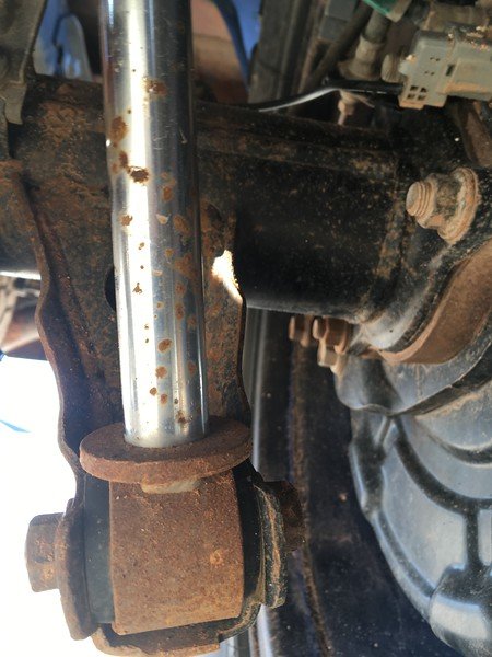

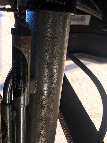

    Got the ADS put on a few weeks ago. I'll update in a couple years. =P
    The 3-year old Bilstiens that came off the truck looked like they were salvaged from the bottom of the ocean.

    Holy fuck-amoly.
    This puts a serious deterrent on purchasing ADS now. As many have already mentioned, I have heard that the coating etc stands up to winter elements better than the "Big 3".
    Have you reached out to the vendor (assuming Mobtown is not a vendor) or ADS themselves? Curious to know what happened here.

    Joe, please reach out to ADS on our behalf. I think this is something we need to understand before others invest thousands in ADS suspension.
    Like I mentioned in the other thread, I’m about a month away from buying ADS suspension and if MD will do this to your truck I imagine KY/IN/OH will be just as bad.
    Any chance the fluid film prolonged contact of salt with the metal and that’s what caused the issue? Just thinking out loud

    "It looks like you guys live in a very salty conditions they are actually fairing pretty well, the big thing with getting longevity out of our 2 step coating process is getting that corrosive salt spray off of the shocks asap. All of the bodies we make are zinc plated and then ceracoated for a double protection process all of that hardware should have been zinc plated as well. Salt is very aggressive and if left on any of the components for too long it will eat thru all of the processes that we put on, regular cleaning and even waxing or surface protectants will help prolong our coatings but if not taken care of they can only protect for so long
    Thank you
    Tyler Jameson
    Ads Racing Shocks
    520-748-0005"

    The only issue is that literally nothing else on my truck is rusting except their parts. Heck even the reservoir isn't corroding. The zinc plating and cerakote doesn't seemed to have helped at all. I don't live in a particularly salty state. Yes, they use salt, but literally only like 3x this winter. We don't get a lot of snow. If I lived in Michigan or further north, I think these shocks would have corroded off my truck already. My comment to everyone, if they put salt on the roads at all in your area, your ADS shocks will look like mine.

    Well, I can't speak for how other brands would have fared. I was told both from the vendor I purchased from and from others that ADS "specially" coats them to resistance corrosion better than every other brand. Maybe that's true, but then damn I'd hate to see what any other brand would have looked like after just one winter in a relatively mild state.

    This is detering me as well I live in Canada these would last long, but i guess having a film keep the salt glued to it until the film doesnt work and then alot of glued on salt is ready to act all at once ...maybe thats what happend...

    Didn’t seem to be a problem on anything else except the shock body.

    I dont live in the rust belt, but I do live in snow country that has grit/sand/salt on the roads for a couple months and run boots front and rear on my kings and Icons so the shafts dont get pitted by gravel/sand. The fronts are just kartec coilover covers and the rears are just standard acorodians that i cut the bottoms off and they just dangle over the bottom eye. I used to have to reseal the shocks every 20k, now I am over twice that and they all are leak free and shafts look perfect.
    I think i would just run roost shields if i lived in the MW to protect the shafts. Once they start to go it gets more expensive to rebuild.
