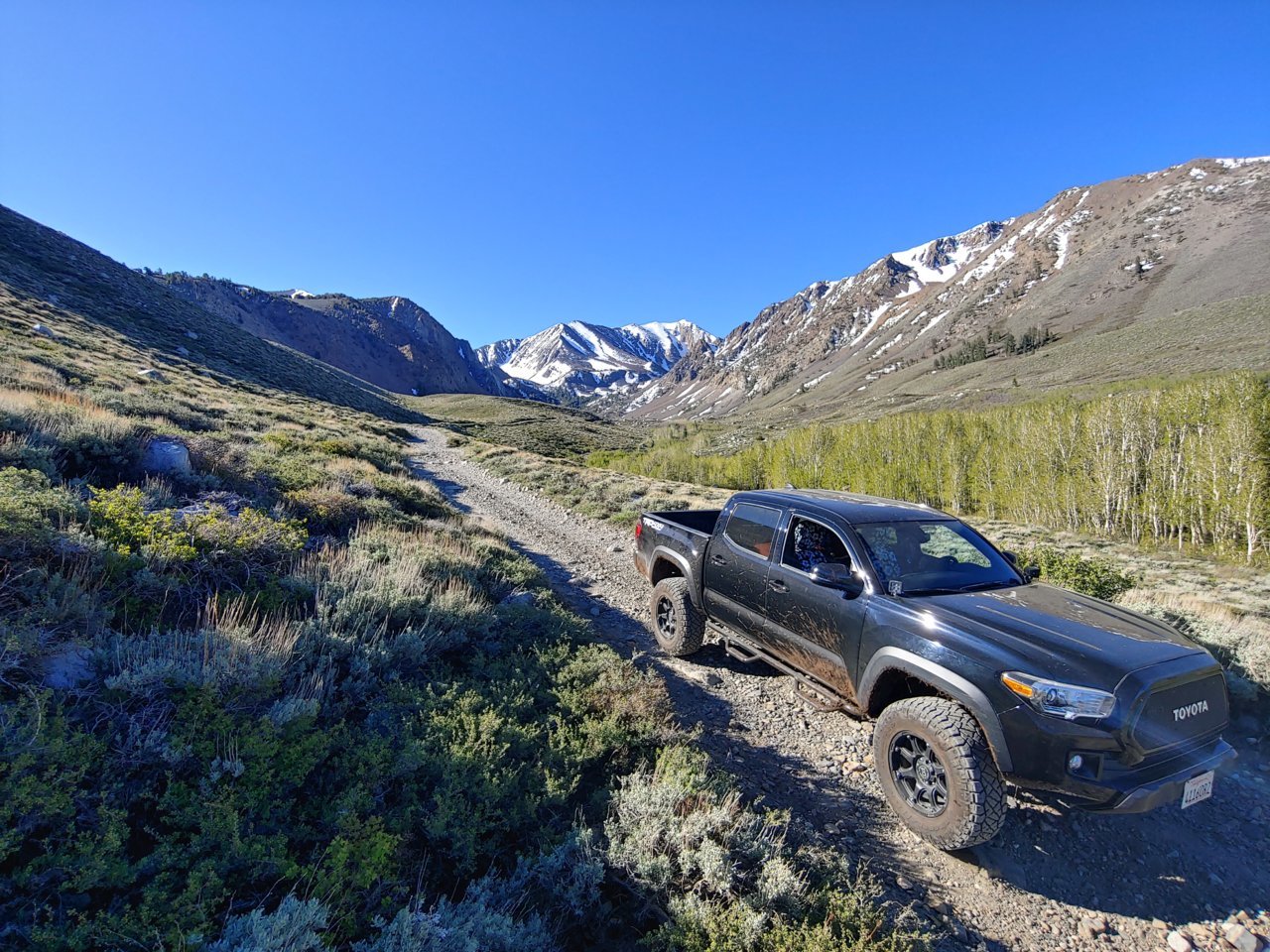

    I have your option # 1. Works well for the use you suggested.20200525_081513_HDR.jpg

    Looks familiar ↓ :thumbsup:
