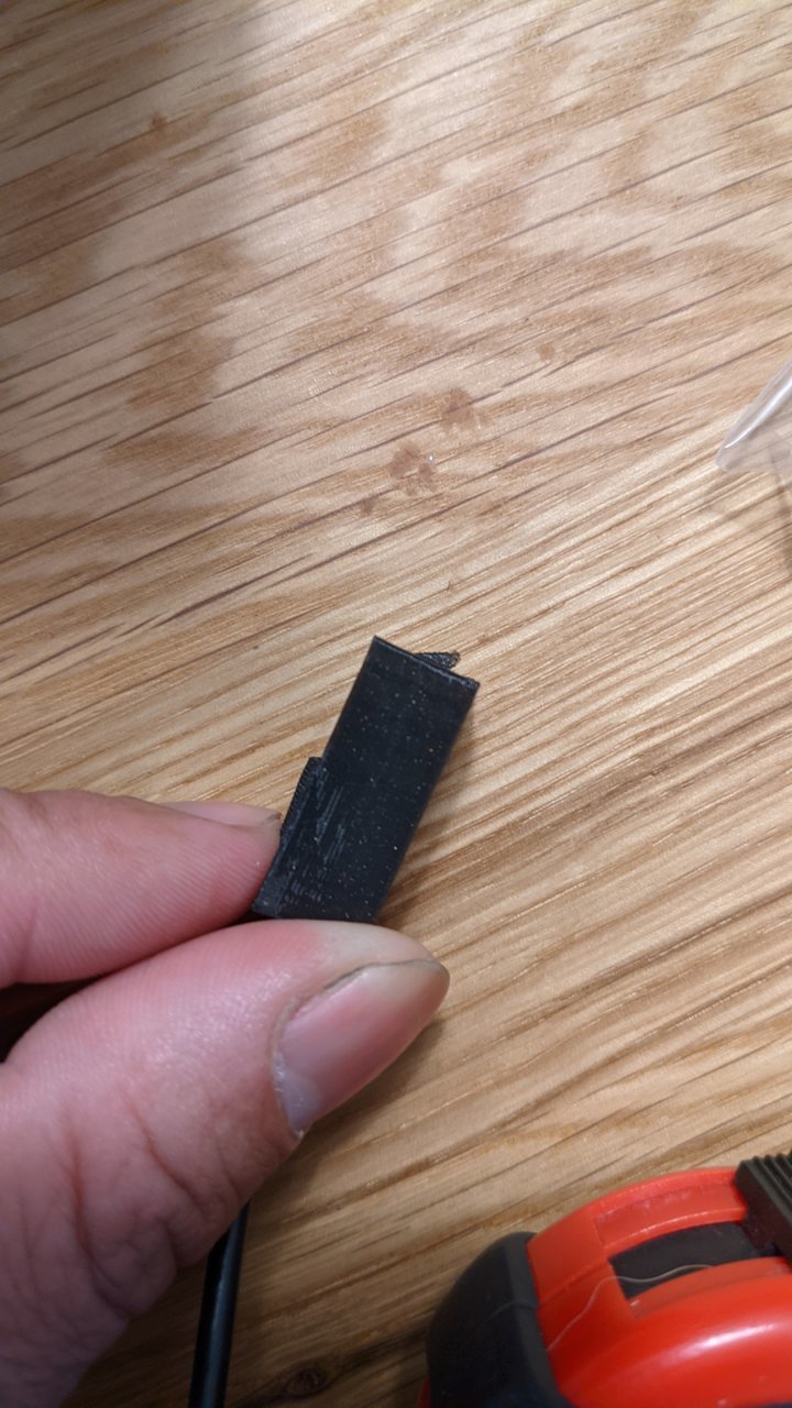

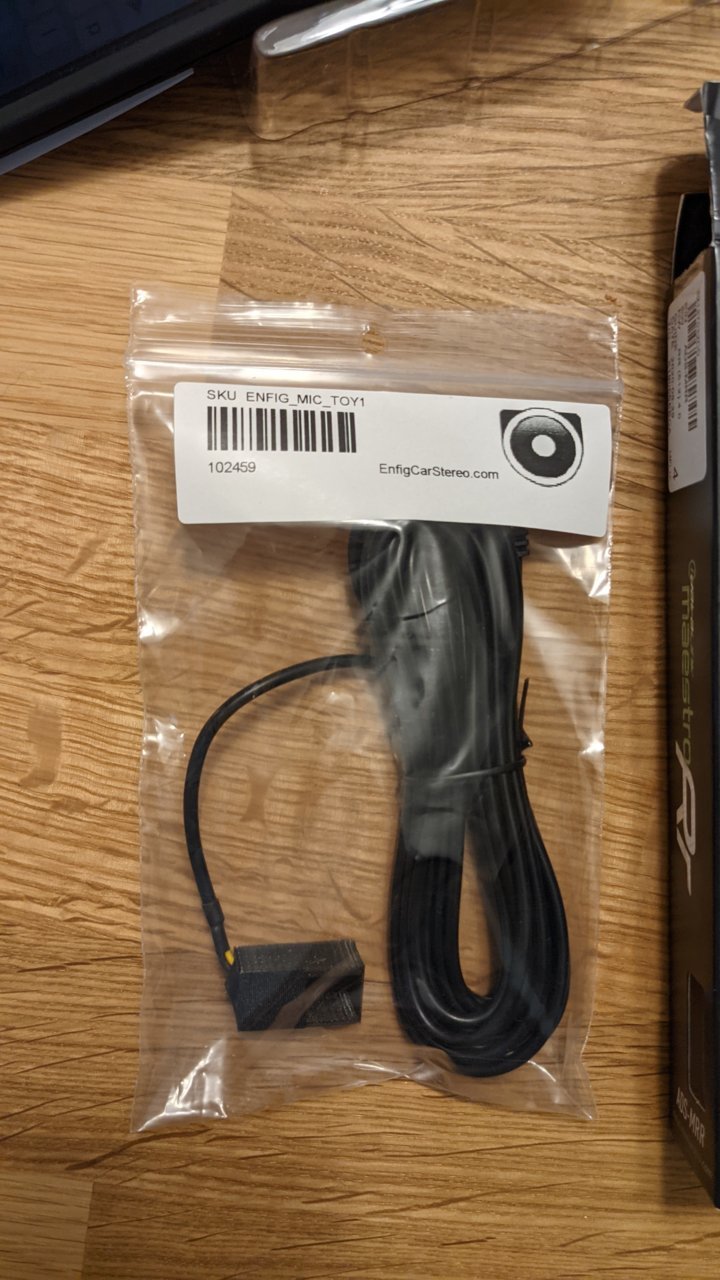

    Just as a note for everybody else watching on here. Ordered that mic last night and this morning someone from enfig called me, asking if I was interested in the tacoma specific model. I of course said yes. He said that with the adapter that it was the same price, and he just recently started making them due to some interest, and I believe that it was mainly from this site. The reason he knew that I had a tacoma was that I put in the "Where did you learn about us" box, tacomaworld.com (That's probably the only time I've ever seen that box used for anything). He told me my order would be in the mail for pickup by the mailman tomorrow morning.
    The guy over there told me that it is currently unlisted, and will be listed once their web guy finishes up with his site redesign. I asked him how others can get it right now and he said that people should call at the phone number listed on their contact page, and he'd be glad to help. https://enfigcarstereo.com/contact.html
    Overall, great experience with them over there, and even though it is a 3d printed part, I'm glad to support a company based in the USA.
    I will upload photos of the new housing and packaging once I receive them.

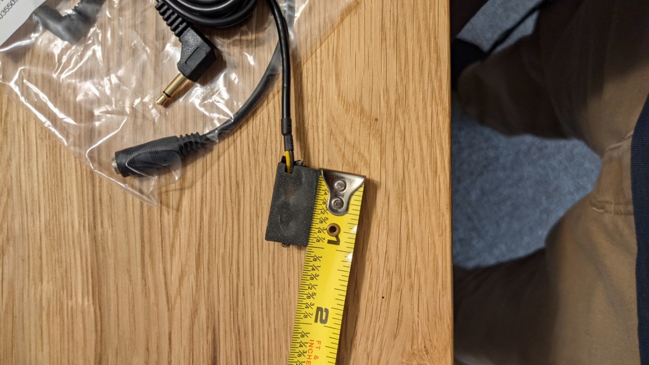

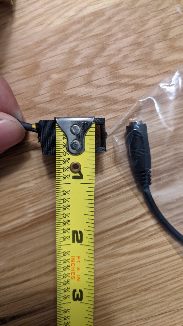

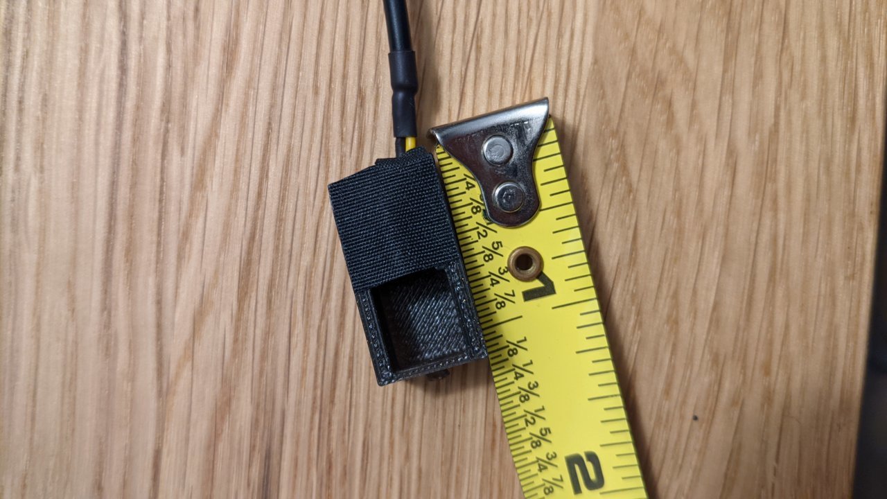

    Got the mic, installed the head unit, but couldn't install the mic in time. It is just chilling on top of my dash for now, but I did take some photos for you all. I'll finish the install after my cross country.

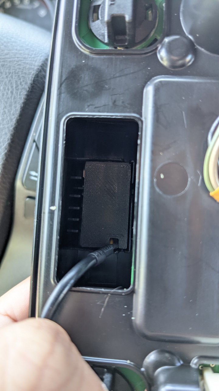

    Just got around to installing the mic in the proper location. It actually snaps into the OEM mic clip holes. Very secure, and takes up the whole hole from the OEM mic. Just have to route the cable, and I'm done.
