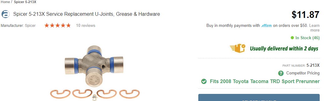

    I replaced my U-joints with the 5-213X, which had zerk in center, which I prefer after my misadventure with Moog ujoints.

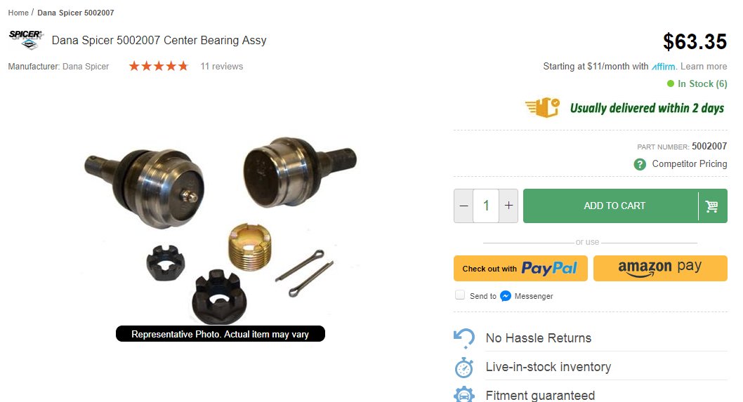

    you tha man @beavis87 , I'll grab the one from JEGS. Not sure about that photo from autoplicity, I had seen that one too. upload_2018-7-10_14-44-6.jpg
  15. Jul 10, 2018 at 1:09 PM
    #55
    beavis87
    beavis87 [OP] Well-Known Member
    May 24, 2015
    #155964
    391
    El Paso
    '10 Silver TRD OR
    Yeah, that happens but you'll probably get the right part; maybe someone can inform of the mismatched picture.

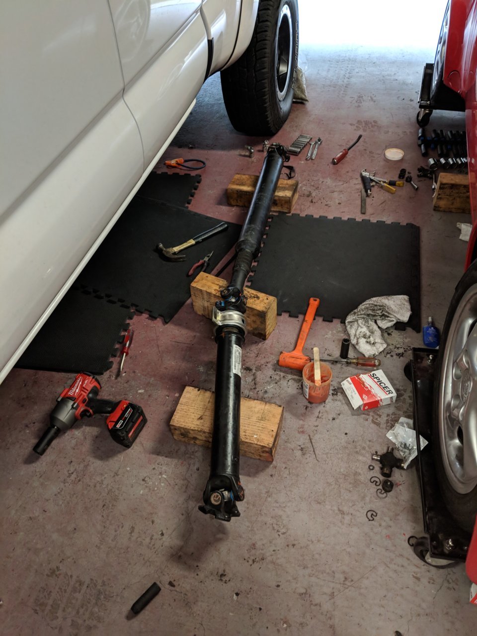

    last month, i used Spicer 5002007 from Drivetrain American for ~$73 and it fit just fine on my 2010 4x4. the original one i replace was worn and no longer centered (~147k miles roughly).
    I also replaced the 3 u-joints on the main drive shaft at the same time.
    I didn't have any vibes besides a small shake around 10-15 MPH but it took me really paying attention to notice. After the new carrier barrier and u-joints, it seemed to have improved slightly but again, it was almost neglible to begin with.

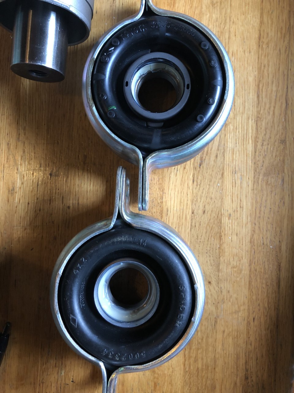

    Here’s a photo of the two spicer support bearings. The 5002007 has a dust shield to protect the bearing.
    Lots of guys are installing the 5002334 on the 4x4 drive shaft with success, but are giving up that protection.
    I found the 4x4 model on eBay, Jegs kept pushing my order back week after week and I canceled.

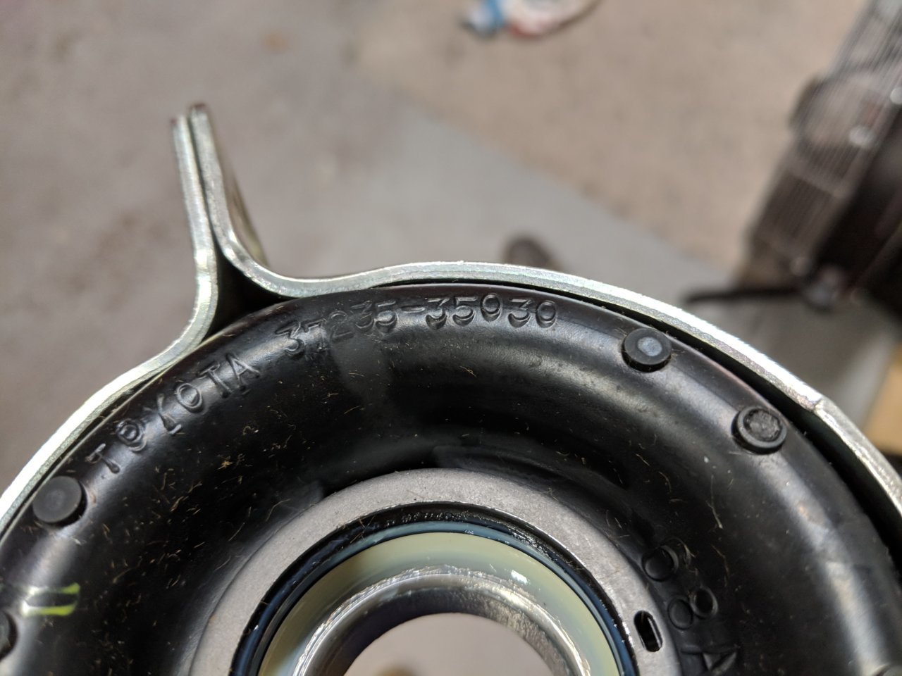

    I thought I'd add something to this relating to the part numbers and I could also use some help.
    I have a 06 Tundra DC SR5 4X4, 4.7. I need a center bearing and was looking at the Spicer parts which got me here to this forum.
    I see in the pictures 5002007 has Toyota part number 372235-35030 on it. It was mentioned that maybe it was a Toyota overseas number.
    I looked at the original bearing on my truck and it also has 372235-35030 on it.
    According to Drivetrain America using my VIN I should use 5002334 but based on the pictures and what's on the truck now I am wondering if I should use 5002007.
    Thanks for any advice.

    If it was me, i'd replace with the same part. Seems like the drive train is pretty sensitive to vibes.
    On the flip side, this thread indicates the two are the same except for an extra seal (?) so maybe the 4x4 (5002007) is an upgrade for you.
    The way i look at it, if it lasted that long, just use the same part and replace again down the road around the same mileage interval, instead of risking something that may cause vibes or other problems.
    Mine lasted to 147k and i think it could have gone another year or ~15-20k miles.
