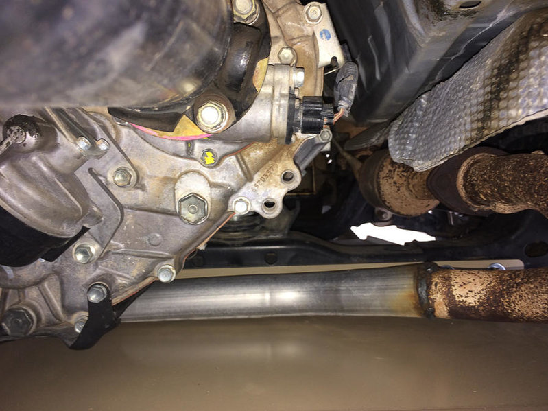

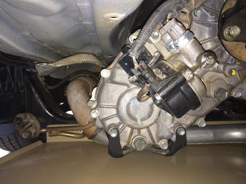

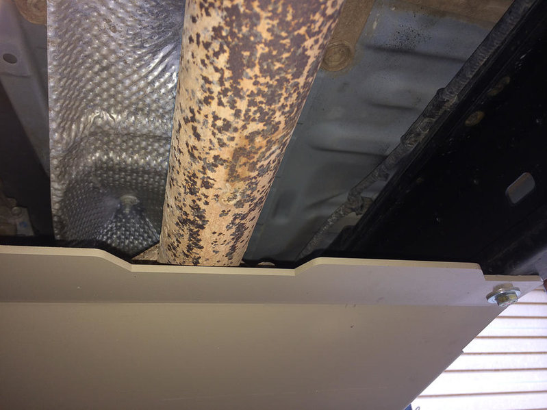

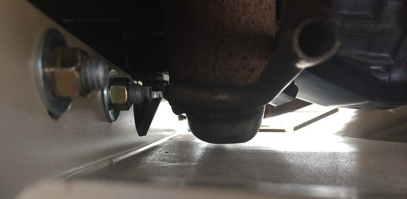

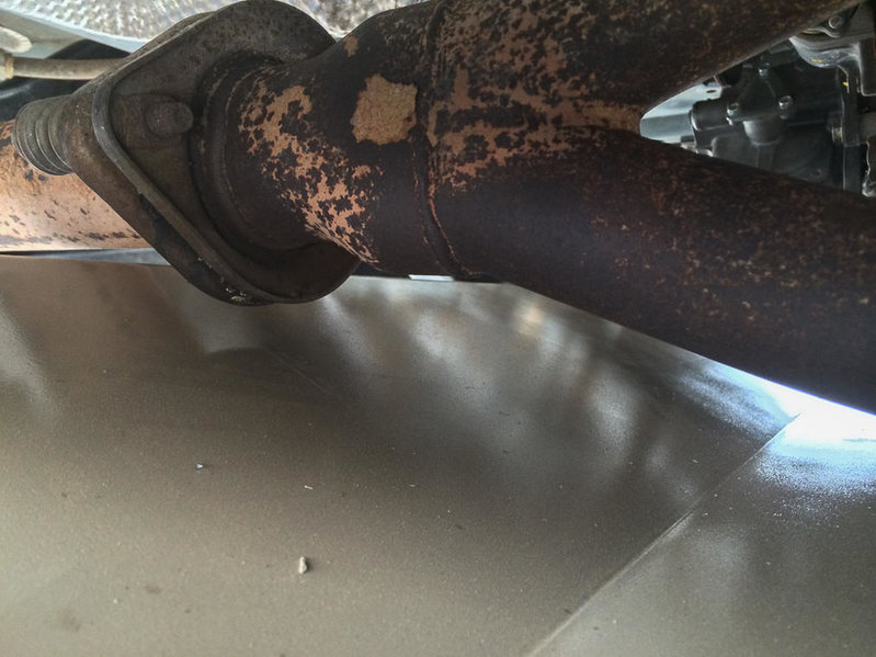

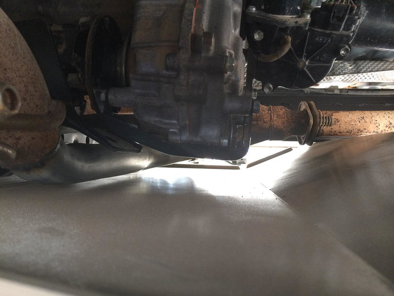

    To expand on the Pelfreybilt reviews, some comments on the Pelfrey Transfer Case Skid:
    I have been running the IFS and Mid skids from Pelfreybilt for some time, but just recently added the Transfer case Skid.
    The Pelfreybilt Transfer Case skid is available in two versions, either with a cutout and boxed area to clear the stock exhaust crossover, or as a flat bottom skid for those that have re-located the exhaust crossover such that it will provide enough clearance for a flat skid. Make sure you communicate and order the version you want. I have re-routed my exhaust, so I installed the flat bottom version.
    The Transfer case skid provides excellent skid coverage for the vulnerable transfer case. The flat bottom TC skid, along with the mid skid provide a nice flat bottom for a big area of the truck.
    The skid is 3/16" raw or powdercoated steel, as with the other Pelfreybilt skids, but unlike the others, installation is not strictly bolt-on. Drilling of one 7/16" hole in the bottom flange of the frame is required on both sides of the vehicle. Drilling the frame is not difficult but is a time consuming chore when drilling upside down. Do yourself a favor and use some good sharp cobalt drill bits and start small, say 3/16" and work up in size till you reach 7/16".
    One feature I like about the Pelfreybilt design for the TC skid is that a separate crossmember is not used. The 3/16" steel plate ramps up at the rear and also flares outward and ties directly into the frame with bolts. This seems to me to avoid the potential for the crossmember to get hung up on a rock. Also the ramp at the rear may help avoid getting hung up on a rock if you are backing up. Probably not going to happen, but some simple design features reduce the likelihood.
    I am very satisfied with the TC skid as I am with the other the Pelfreybilt skids. Together the three skids make a great skid plate system. As a final comment, the customer service from Pelfreybilt is exceptional, and should be considered when selecting skids.
    Here are a few photos of the flat Pelfreybilt TC skid and how it sits when installed so you can plan your exhaust reroute.
