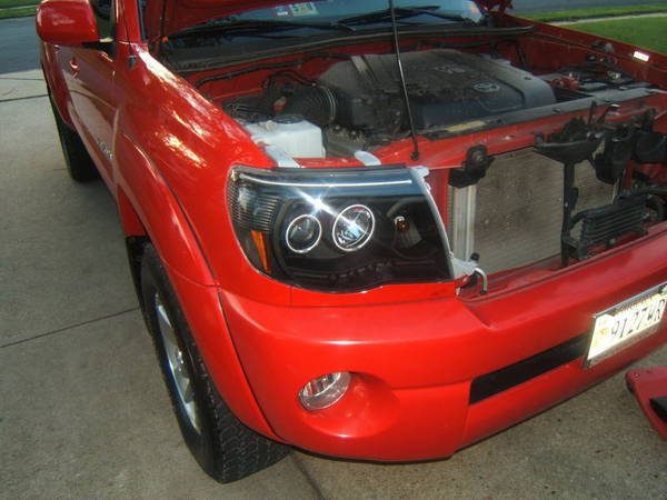

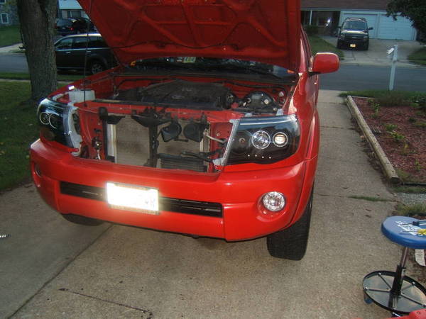

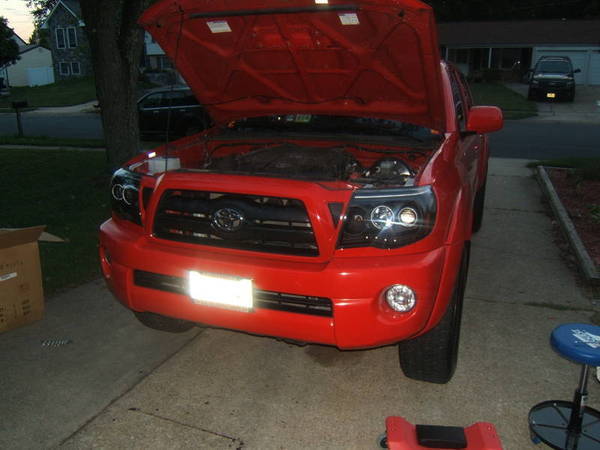

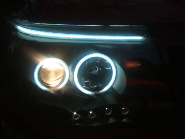

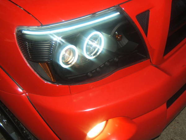

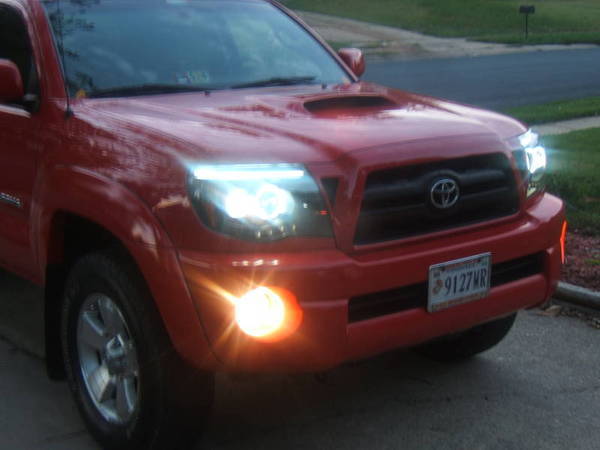

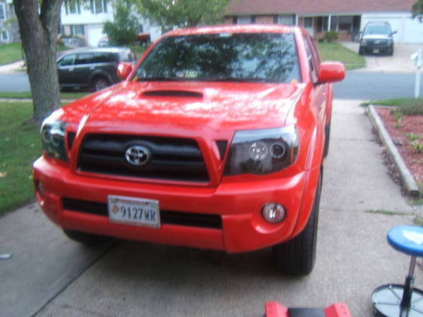

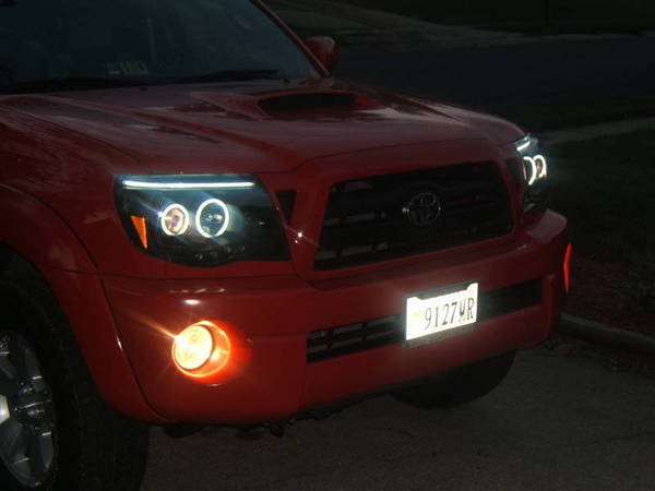

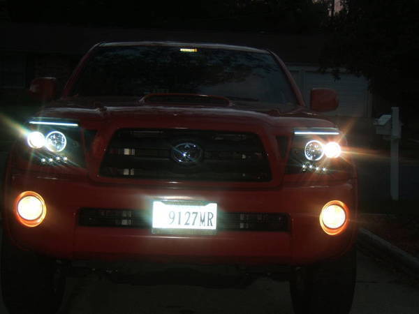

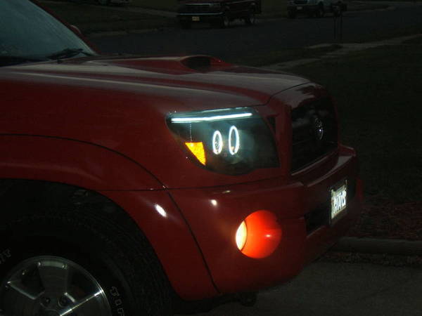

    Then, I added the headlights:

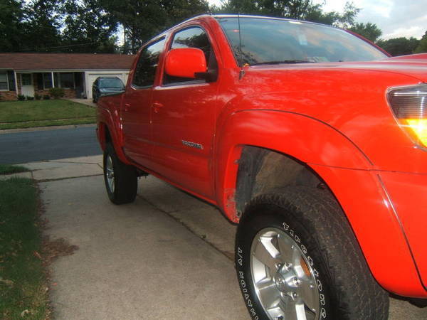

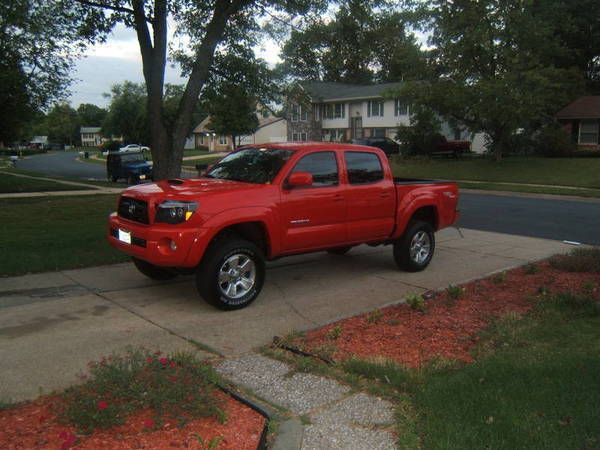

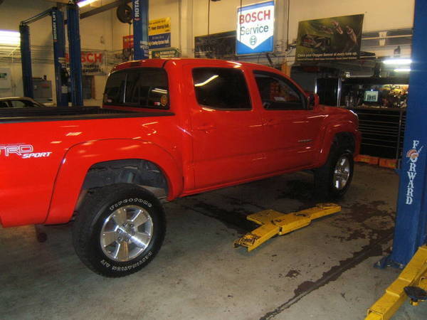

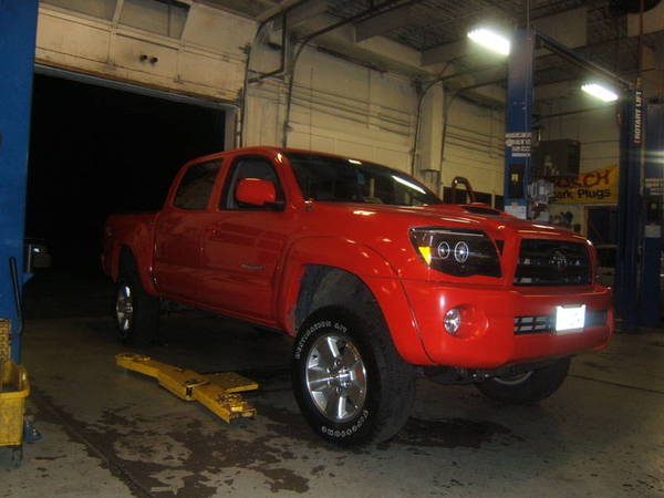

    Then, the 3" Tuff Country Lift:

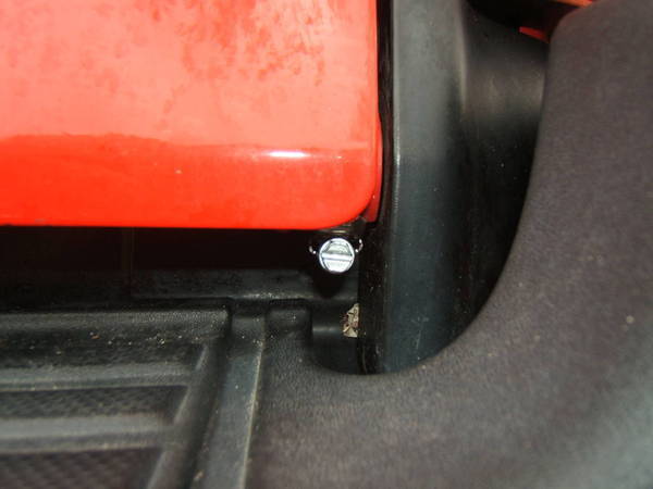

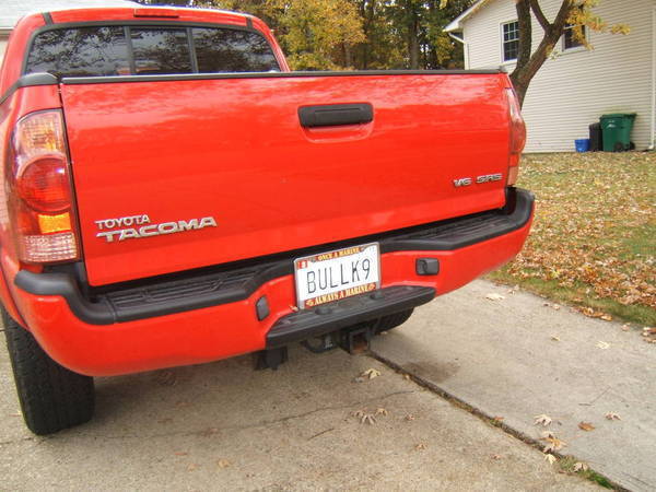

    Most recently, I added the tailgate theft mod:

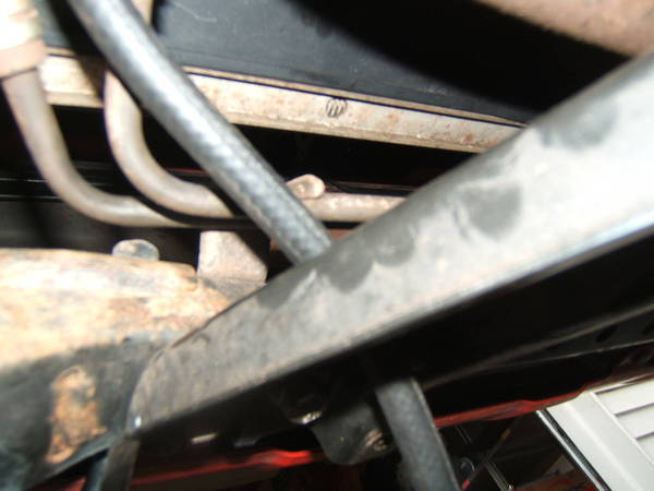

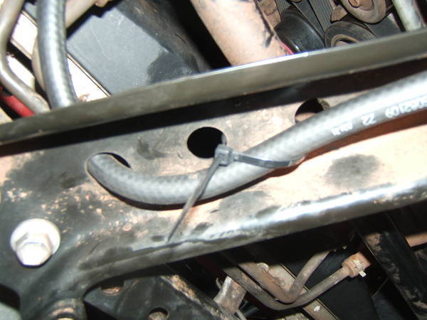

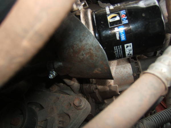

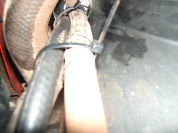

    And the permanent oil filter drain plug:

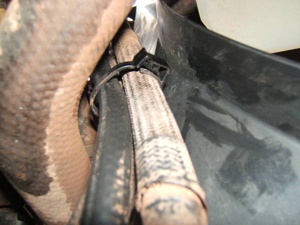

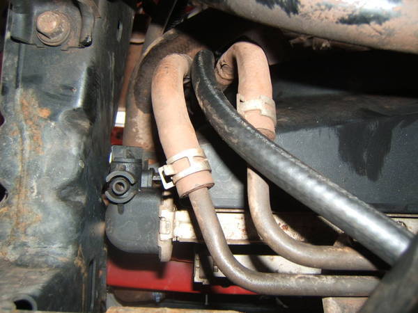

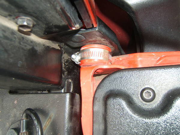

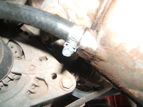

    Connected the Fuel line using a hose clamp:
    Another view from side:
    Ran the hose next to the fan, with two other hoses:
    Zip tied them together:
    Zip tie from under the truck (you will need to remove skid plate):
    Run hose through the frame hole that is under the skid plate:
    To finish, I ran the hose under that frame bracket and zip tied it along the way.
    Nonetheless, all you need to do is zip tie the drain hose out of the way, reattach the skid plate, and trim the hose. And now, when I change the oil, I don't have to worry about attaching a hose to that oil filter drain plug or spilling oil in the engine.... :)
    Took off some badging (which you cannot really see here)... and I added a USMC badging on the side (pics to follow soon).

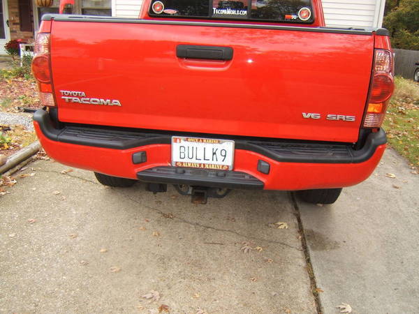

    Then I added my personalized plates:

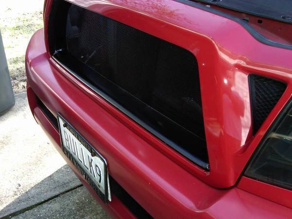

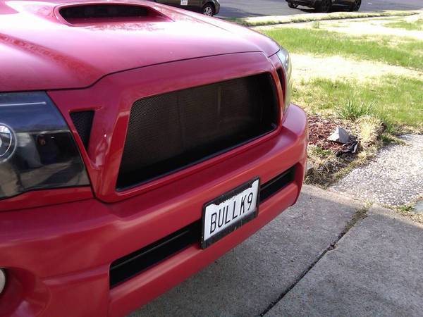

    UPDATE 4/1/2010:

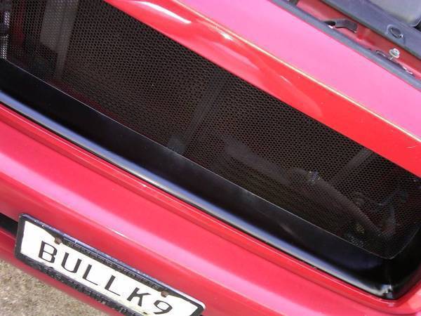

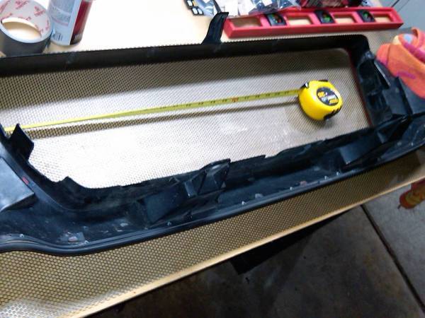

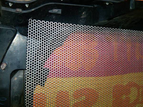

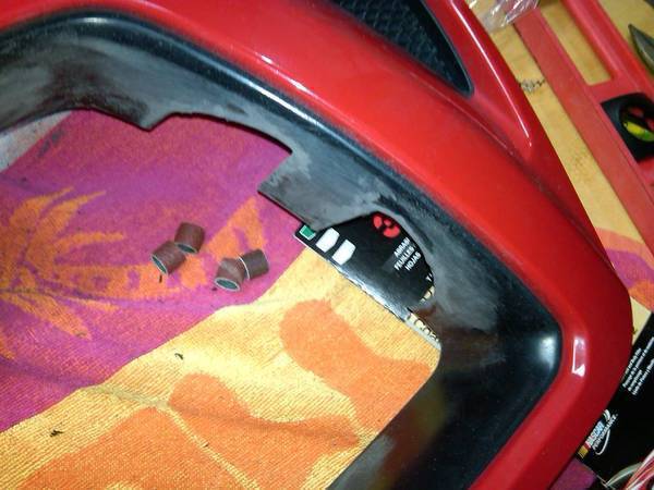

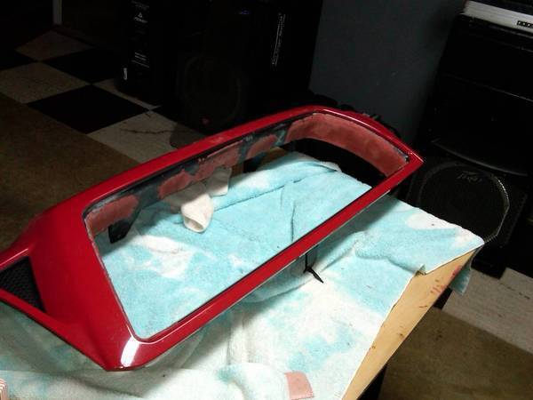

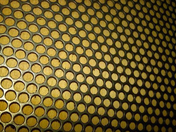

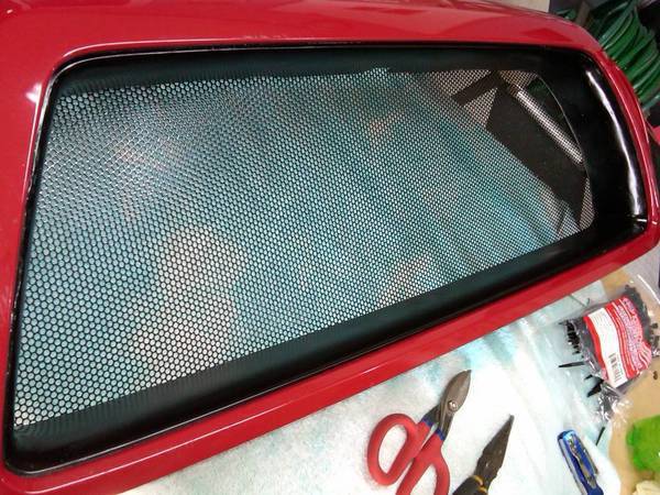

    So the weather has finally warmed up again... Aside from retitling the bathroom floor last night and today - I decided it was time to start my satoshi grill mod... I also got my weathertech floor liners in today, and I'll be installing them when I get a chance to clean out the interior well enough to be worthy of the weathertechs. Anyway, so after calling around to several metal places today... I finally found a guy here in Waldorf that was willing to sell me a piece of perforated galvanized steel mesh for 20 bucks (it was a contract company, so I was psyched he worked with me. I'll update with some pics after it's all done. He also asked for one of my DJ cards for a company picnic... Nothing like being at the right place at the right time!

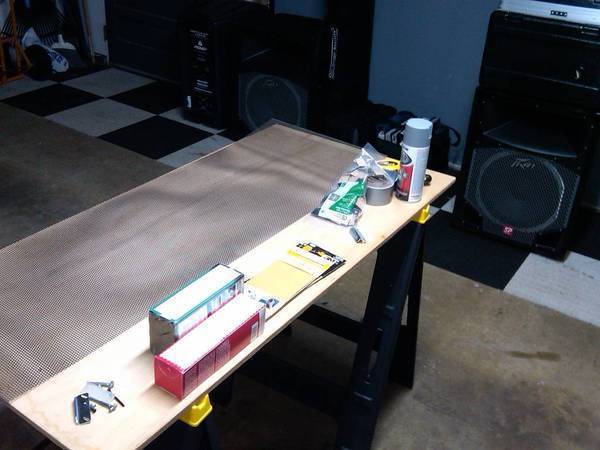

    Step 1, setup the table:

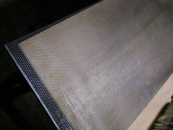

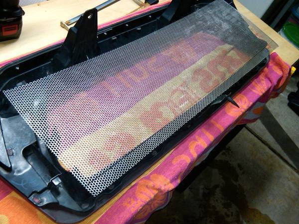

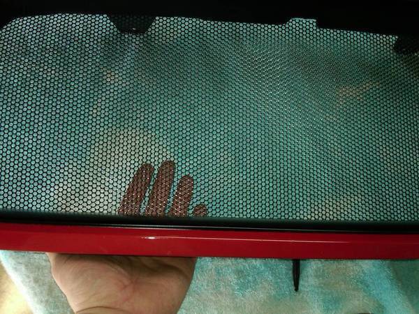

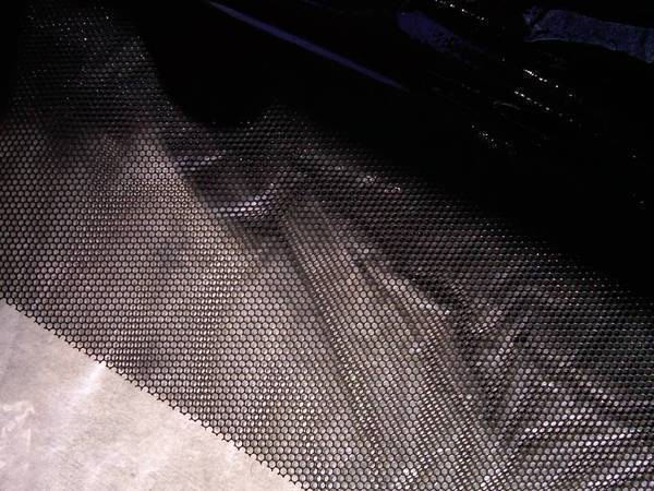

    Step 2, take pics of the mesh. This is galvanized steel... good stuff:

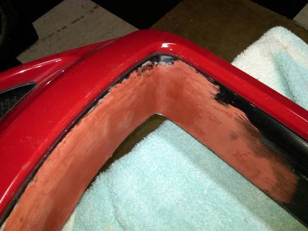

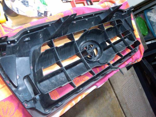

    Step 3, position the grill for measurement and destruction on your wife's favorite beach towel:
    Step 4, destruction and measurements (remember to measure twice and cut once:

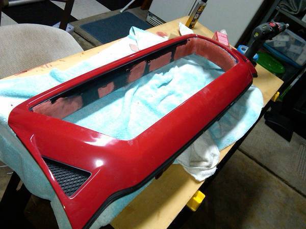

    Step 5, after you dry fit your mesh, SAND and SAND some more:

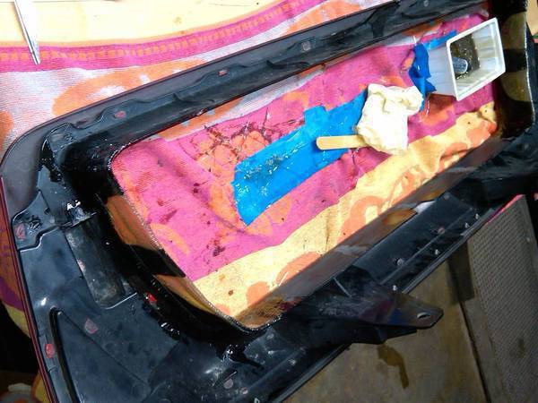

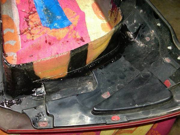

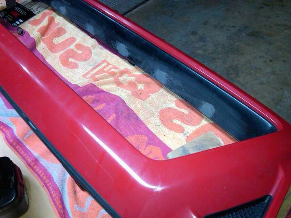

    Step 6, ruin aforementioned towel making a mess while doing your first fiberglass job:
    Step 7, Sand and Sand some more... Then add body filler and sand again:

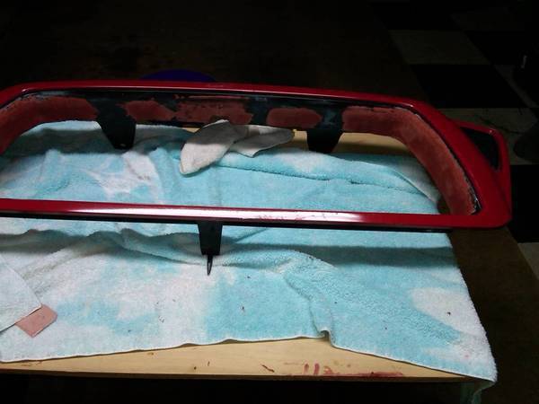

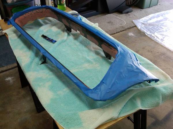

    Step 8, tape it off:

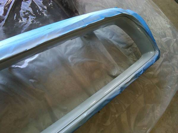

    Step 9, prime it:
    Step 10, while the primer dries... Spray your grill:

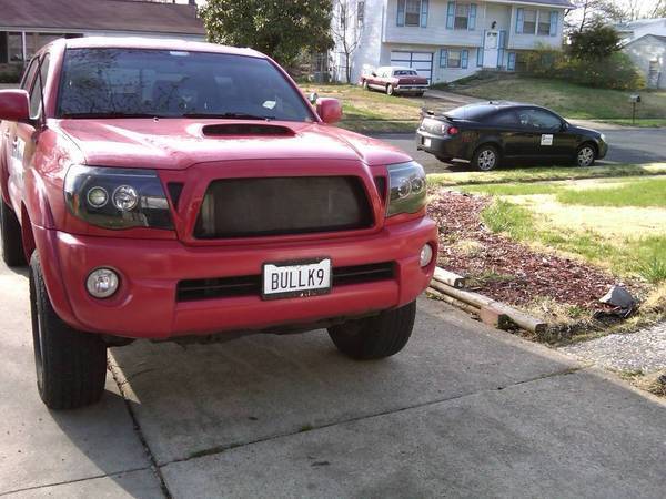

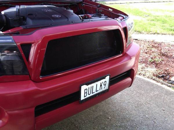

    Step 11, while grill dries - spray what you primed. Let dry and attach grill to grill surround:

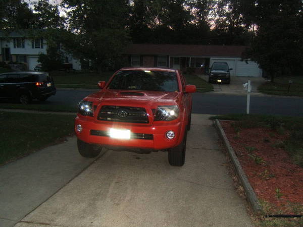

    Step 12, reattach to truck and view finished product:
    And, since I was already out there - I decided it was time to go ahead and install the WeatherTechs:

    what are the headlights called and where can i get them from
  11. Dec 22, 2009 at 7:43 AM
    Agent475
    Agent475 [OP] "Mark It Zero"
    Aug 28, 2008
    #8829
    2,856
    Waldorf, MD
    2006 Red TRD Sport
    Hood Struts, 3" Tuff Country Lift, Shortie Antenna, WeatherTechs, Tinted front windows, custom TRD seat covers, custom pedals, debadged, custom USMC badging, quasi-functional hoodscoop (i.e. I cut it open), black front Yota emblem, Tailgate Theft-Prevention mod, Horn Relocation mod, Old Man Emu Carrier Bearing Drop, Brighter Backup Lights Mod, Smittybilt Reciever Hitch Tow Point, currently working on Satoshi Grill Mod
    Eagle Eye Projector Headlights
    www.octanemotorsports.com is where I bought mine.
    Enjoy!

    Satoshi Grill mod in progress... Yes, at 0230 :) Fiberglass should be dry now...
  13. Apr 2, 2010 at 3:16 PM
    Agent475
    Aug 28, 2008
    #8829
    2,856
    Waldorf, MD
    2006 Red TRD Sport
    Satoshi complete...

    what were the measurements on the steel? cause i asked a friend who could get me the steel and he wanted to kno the thickness of the steel and the sizes of the perforated holes?
    would u happen to know all that? lol

    Honestly, I have no clue and I am in Iraq right now, so I cannot go measure them. But I ordered them from ToyTec and they are Old Man Emu carrier bearing spacers. About 1/4" thick if I recall correctly.

    Any clogging in the hose after a few oil changes?
    Also, how do you like those halo projector head lights?
