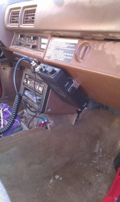

    I wired in a CB setup. Uniden Pro 510XL, door jamb mount inside the tailgate, and a Wilson 4' antenna. Works perfect, didn't even have to touch the tunable tip on the antenna: 1.1:1 on Channels 1 and 40, 1.0:1 on Channel 19. I have a heavy duty antenna spring on the way so I will have to check it again but it should be fine.

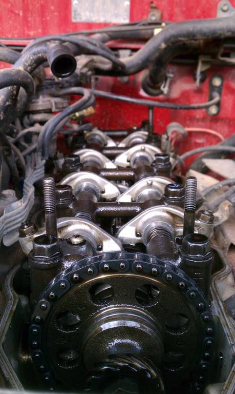

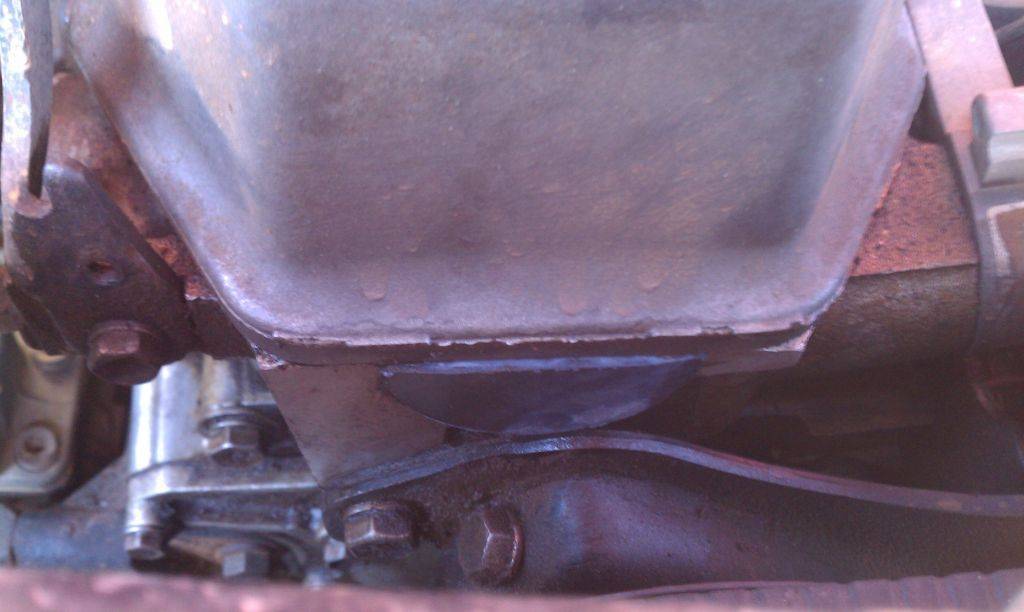

    I finally fixed the leaky valve cover with a new gasket set, and adjusted the valves while it was apart.
    Here is where it was leaking, around the halfmoon.
    I also checked the timing chain guides and everything looks good :cool:
