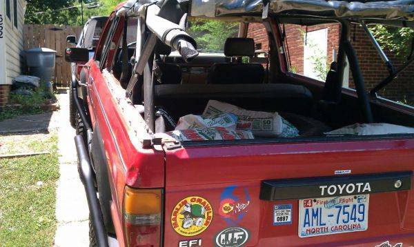

    I put 400 lbs. of sand in the back to help the rear springs break in. I'll drive it like this for a few weeks and see what happens. I also finally got around to painting the tubing but my photos won't upload for some reason. I used Rustoleum flat black. I'll post up later.

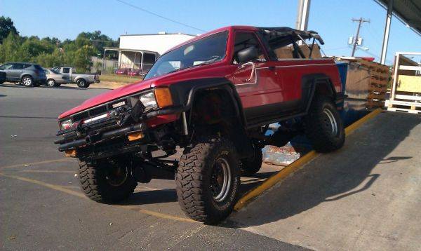

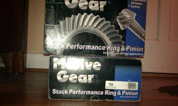

    So I picked up the new front shaft today but they failed to tell me that the T-case flange holes will not line up with the shaft. No big deal, they are going to take care of that for me next week.
    Then I met up with Jerret and bought the 5.29 Motive Gears from him
    I'm one of those people that just can't make up their mind and after some debate I have decided to save a little dough and get Spartan lockers front and rear. I will pick up some 35x12.50" Goodyear MTR's in a few weeks and hopefully have the gears set up by the end of July.
    I found a dirt pile to play around on. I have been driving around with the 400 lbs. of sand bags in the back since Monday and the springs are starting to soften up. I will leave them in for a couple more weeks and see how it sits.
    Pretty good rear flex:
