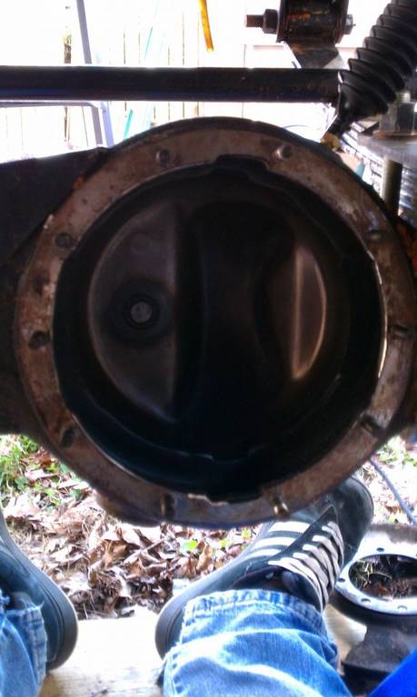

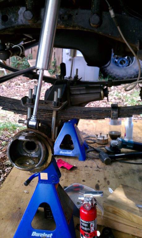

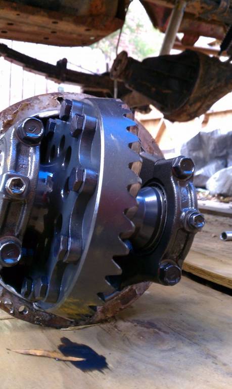

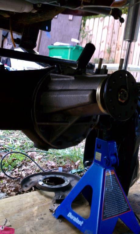

    Anway.... More progress today on my POS that I waste money on :D
    Got HP front installed. Unfortunately it did not drop right in, I had to spend 5 min. with a grinder to clearance the housing. I elongated the top and bottom notches for the ring gear to slide in, and I had to clearance 4 spots on the sides to clear the bearing cases.
    Set in place and finger-tightened, waiting for the RTV to start setting up.
    Got the spooled 3rd swapped with the Spartan locked 3rd.
    I got the driveshafts out and removed the driveline e-brake, so the t-case is almost ready to come out.

    Big fatass ring gears are always nice to see.
