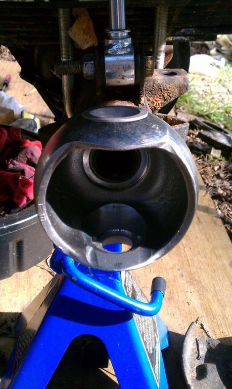

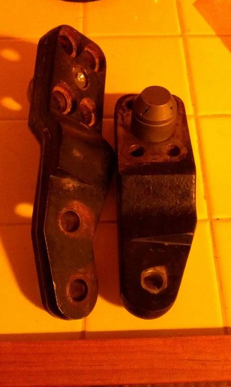

    Got the steering pins swapped out yesterday

    The upper and lower pins have grease fittings.

    Oh, sorry I didn't realize what you meant. All of my pins have needle zerks.

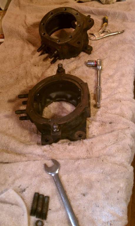

    I got the frame painted, now I just need to top coat it. I will probably use Rustoleum satin black.
    Then I spent 2 hours scrubbing the knuckles with Purple Power and wire brushes, hosed them off, and wiped 'em down. I'm going to paint them red and install the ARP steering arm studs
    Here yah go Slimwood, nice and clean ready for paint :D

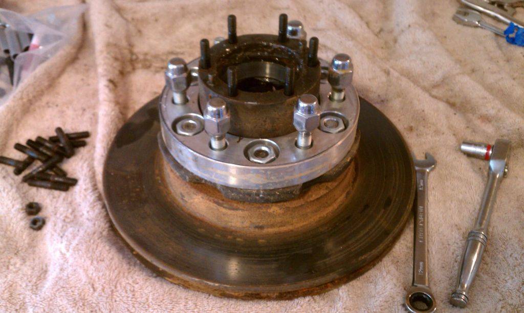

    Swapped in the TB eliminator steering pin bushings into the ball thingies, and put in the new inner seals
    Put in the ARP hub studs
    Painted the knuckles and put in the ARP studs

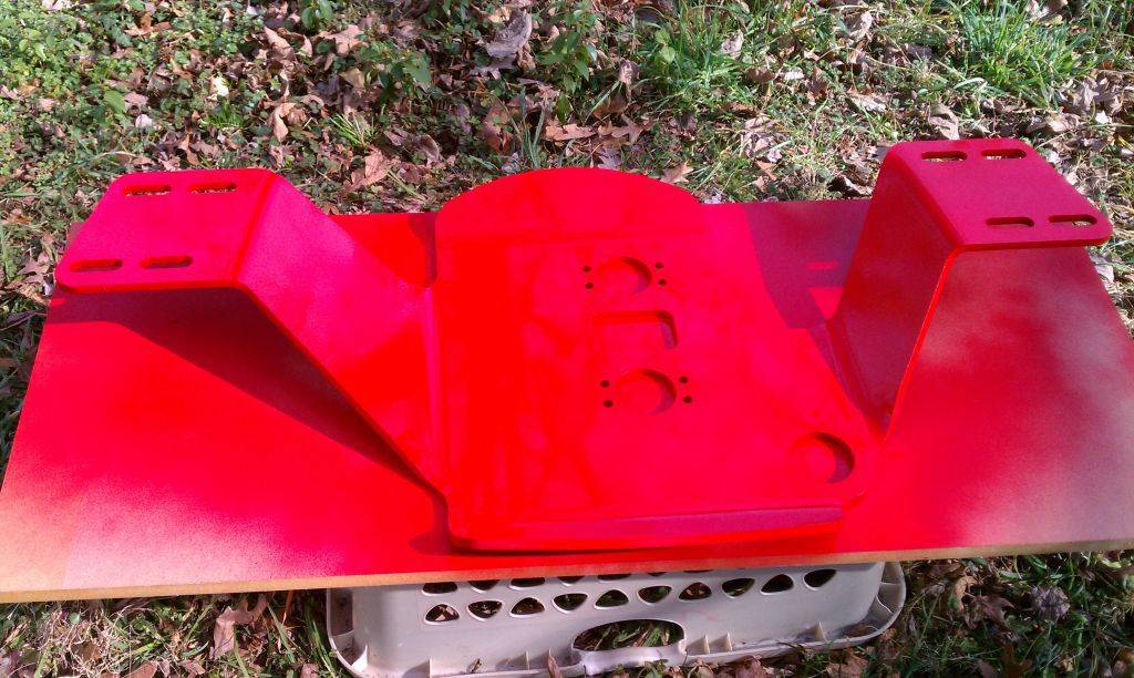

    And painted the dual case crossmember

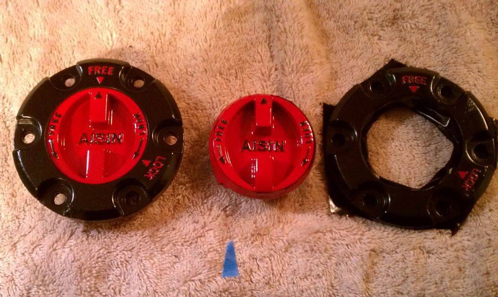

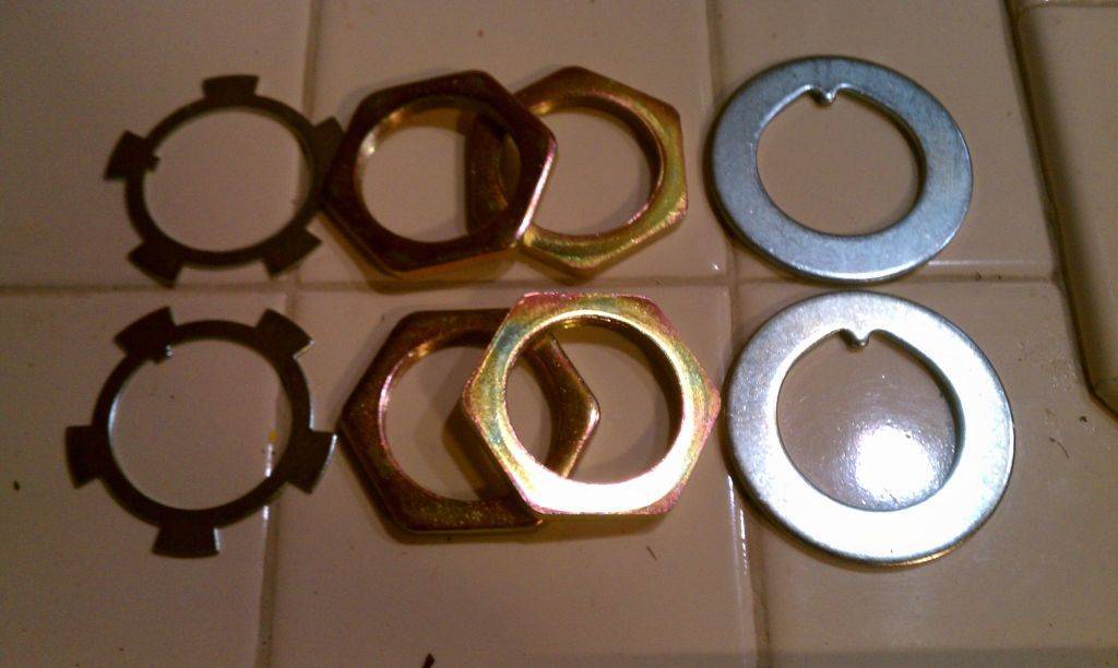

    I got the new spindle nut sets from rockauto today. Awesome place to deal with. I mainly needed the index washers to the right in the pic.
    I'm cleaning up the hub dials now, going to put some fresh paint on 'em.

    So baller. I stopped shaking long enough to hand paint the letters :D
    2 different hub dials, I think one is from an IFS hub :notsure:

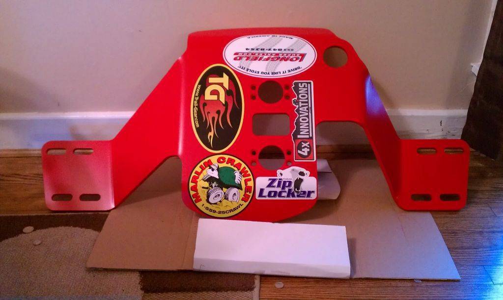

    LOL. I think I'll paint the diff guard red, and maybe add a red toyota stencil to the truss :cool:

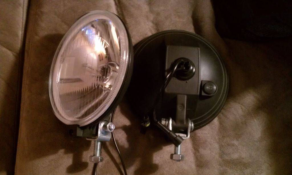

    So bored :bored:
    It is nasty outside so I worked on my lights. I had a set of Hella 500 driving beams on the front. I swapped those with my 500 fogs, and converted the driving beams to HID. Now I need to find where to mount them and run the wire. I might mount them to the cowl in front of the windshield.

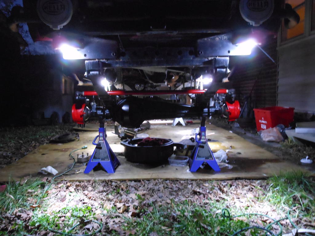

    And dressed up my crossmember.
