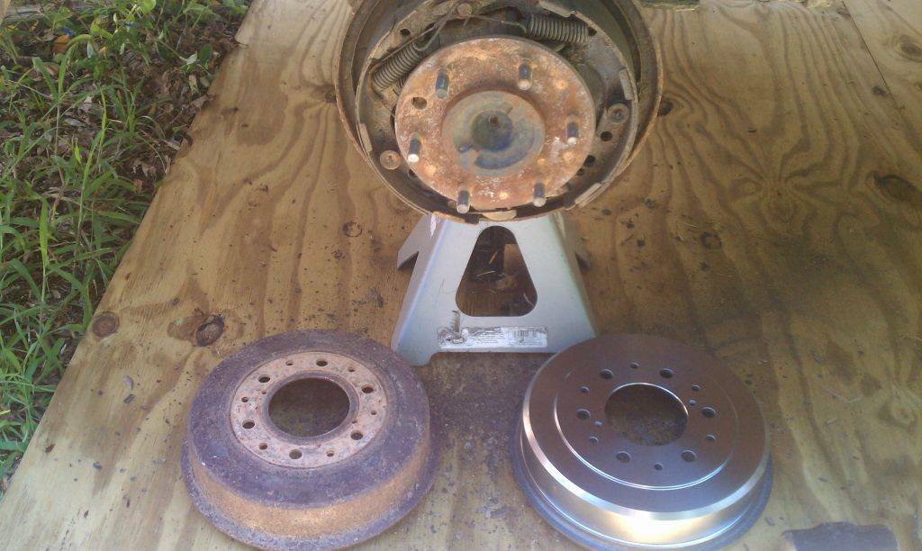

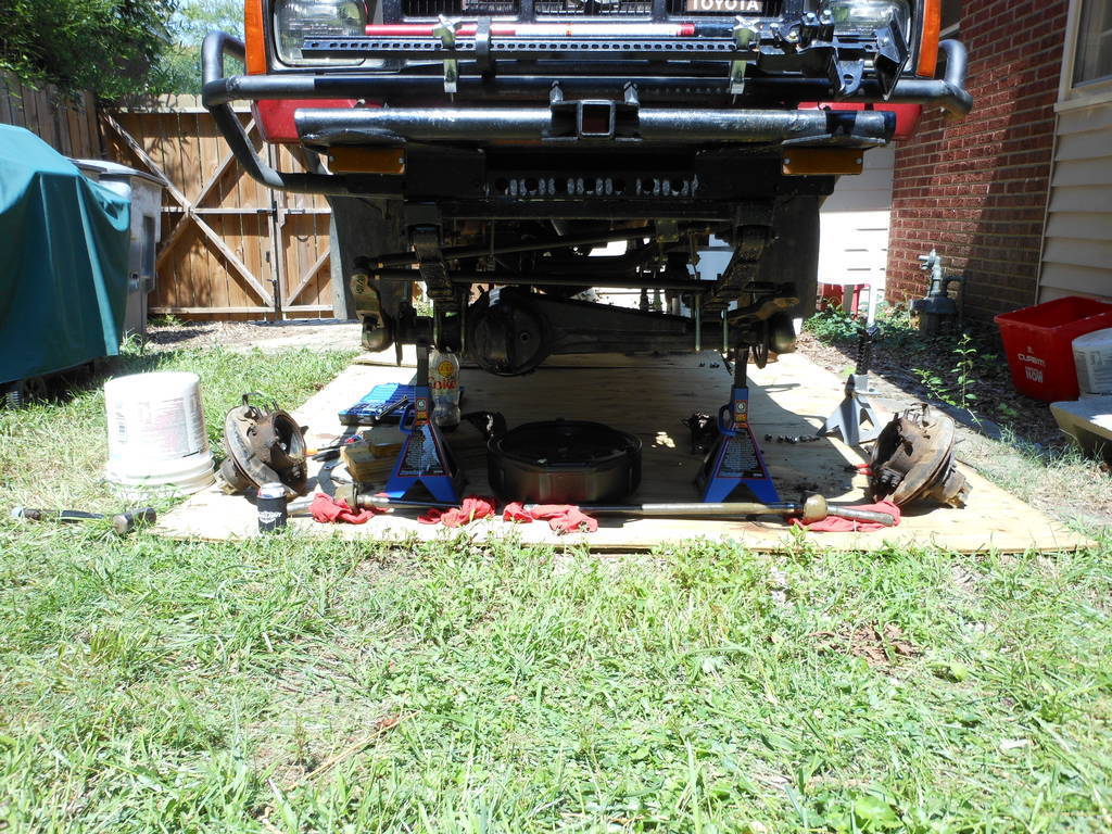

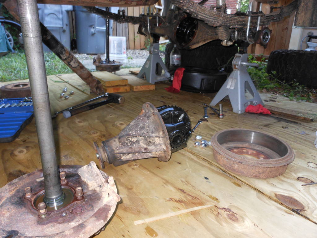

    Work has finally slowed down so I have some more free time which is nice. Unfortunately I pinched my left sciatic nerve and it causes a lot of pain in my lower back and down my leg so I can't do a whole lot. I managed to get the runner in MJP2 mode so I can pull the 3rd's and work on the brakes while the 3rd's get regeared and locked.
    So I pulled the rear drums off and the brakes don't look as bad as I imagined but they do need some attention. The driver side drum came off with a couple taps of the mini sledge, but I had to beat and pry on the passenger side for almost 30 min.
    Here is the old drum vs. new

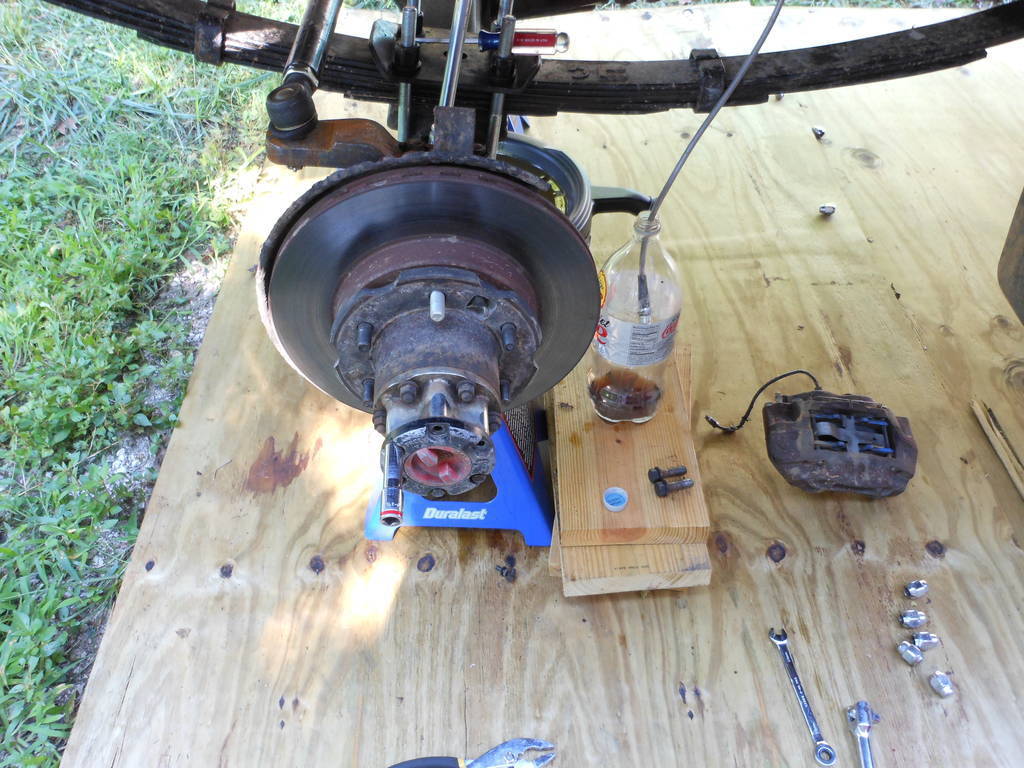

    This is as far as I got before the pain got too much. The brake bleeders are seized and I'm not sure what to do about that. I was thinking just break them off and drill out whats left and install new ones. I will try to get back out there later if I'm not hurting too much.

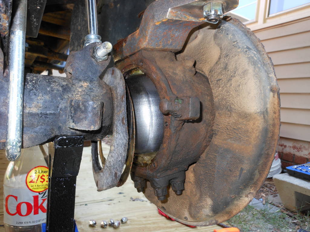

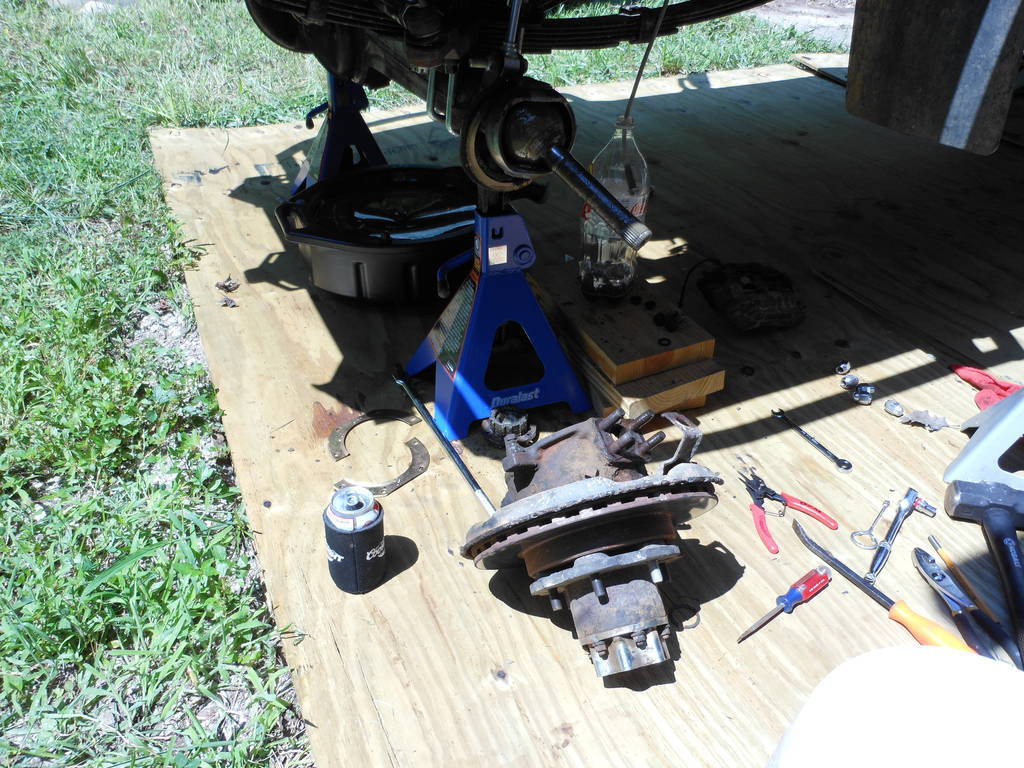

    I did my morning back and leg stretches and got to work. I got the front birf's removed with not too much trouble. I'm ready to pull the front 3rd but I think I will work on the rear tomorrow after work and get both 3rd's ready to pull when I can get a helping hand.
    Carolina Truggies packed in some nasty looking butt mud grease. It must be a Jeep thing.

    We wouldn't understand.

    The diff oil was the same color. I'm guessing some of the grease got into the housing during reassembly.

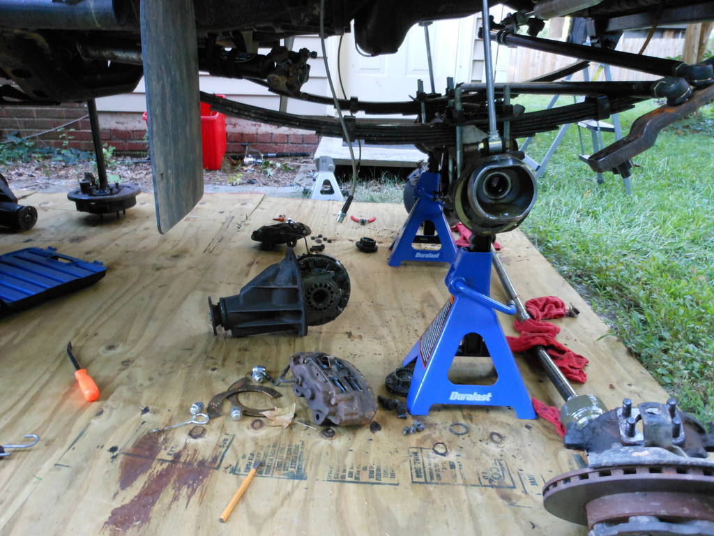

    I called a buddy over and we got the 3rd's removed without any trouble. Although I am sore as fuck now. Damn this pinched nerve hurts. Going to call up ECGS about getting my 5.29's setup with lockers.
