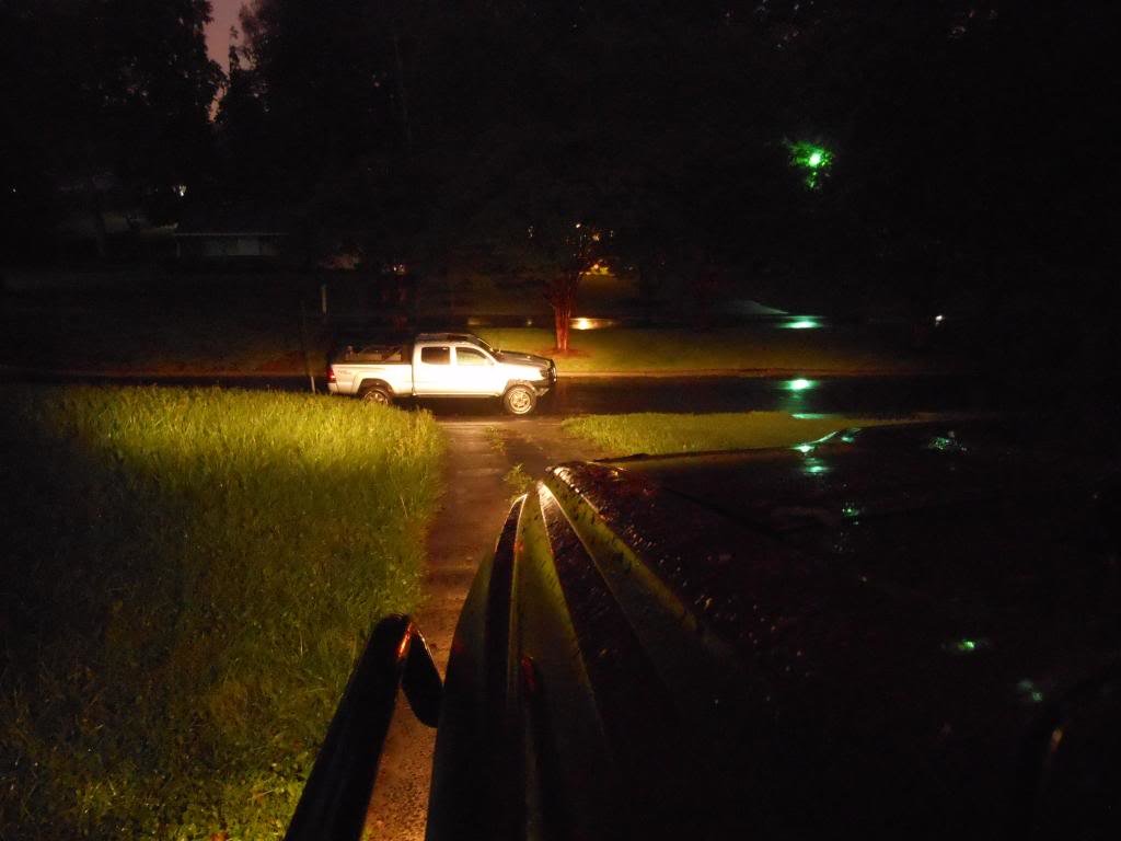

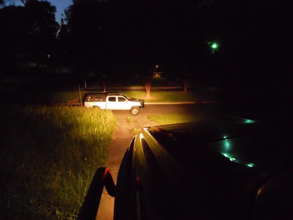

    I snapped a pic of the Roundeyes H4 conversion light output. I still need to mess with the aiming.
    Sealed beams;
    Roundeyes;
    They seem like a good improvement (like I said, I still need to do some aiming), but they should really shine when I upgrade the wiring. I will get another pic when the upgrade harness is installed.

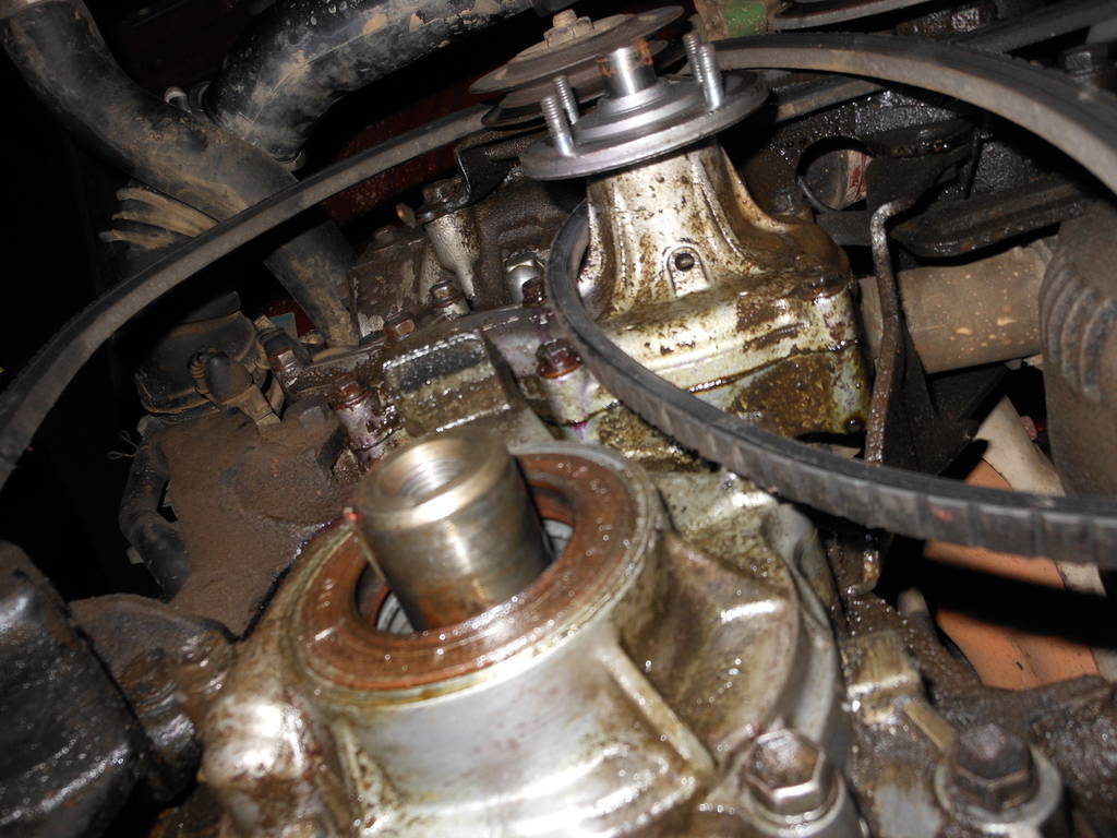

    This bish has started leaving puddles everywhere I park it. I believe it is the front crankshaft oil seal :yay:

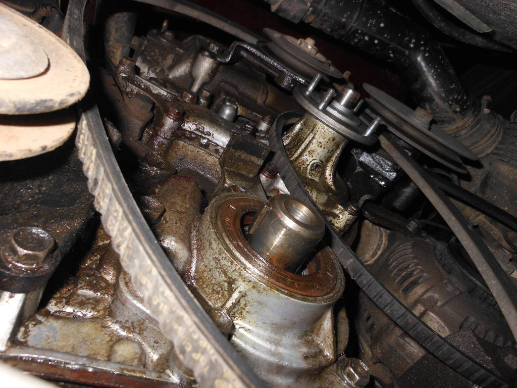

    I got the pulley bolt off, I'm guessing it was removed not long ago. I'm going to use a late model seal, which is smaller and has a different seal lip location away from the crankshaft groove from the stock '85 seal.

    LOL :brianr: I have not wanted to go to the trouble to fix a drip when I am going to replace the friggin motor next winter. But now dah bish is leaving puddles so fuck it, now I have plenty of room to install the new alternator too :D

    My crank pulley pulled off with a few good tugs

    Are there grooves in the crank pulley where the seal rides at?
