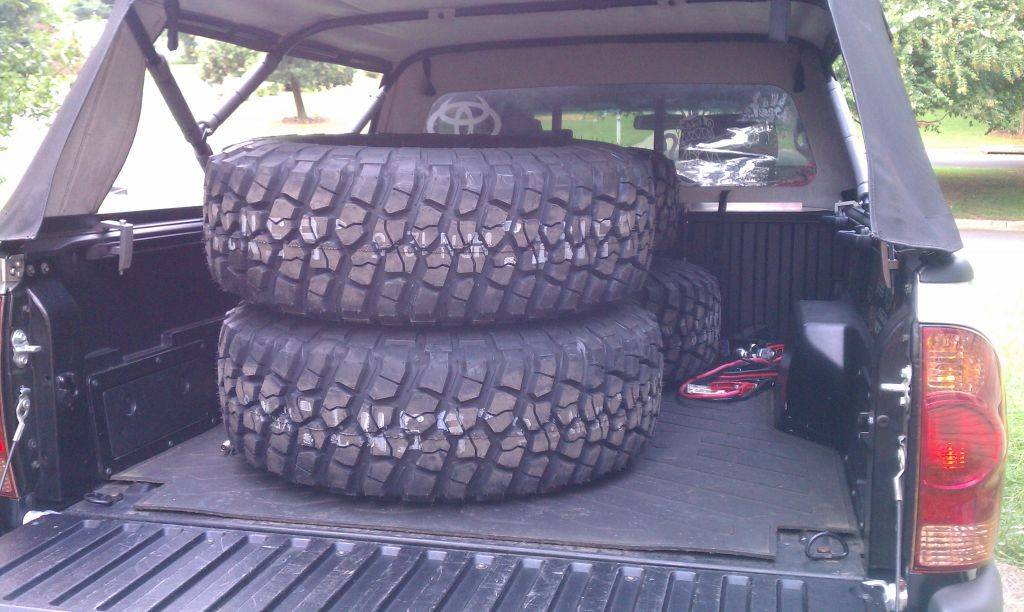

    I layed out of work today because my back and leg is in pretty bad pain. I should have made my buddy do all the work yesterday. Oh well, I went to 4wp up the street and ordered my tires. I went with 35x12.5x15 KM2's cause they were on sale and the guy behind the counter (Aaron I think?) gave me a discount because I am in there all the time and he also has an old Yota. So those will be mounted later this week.

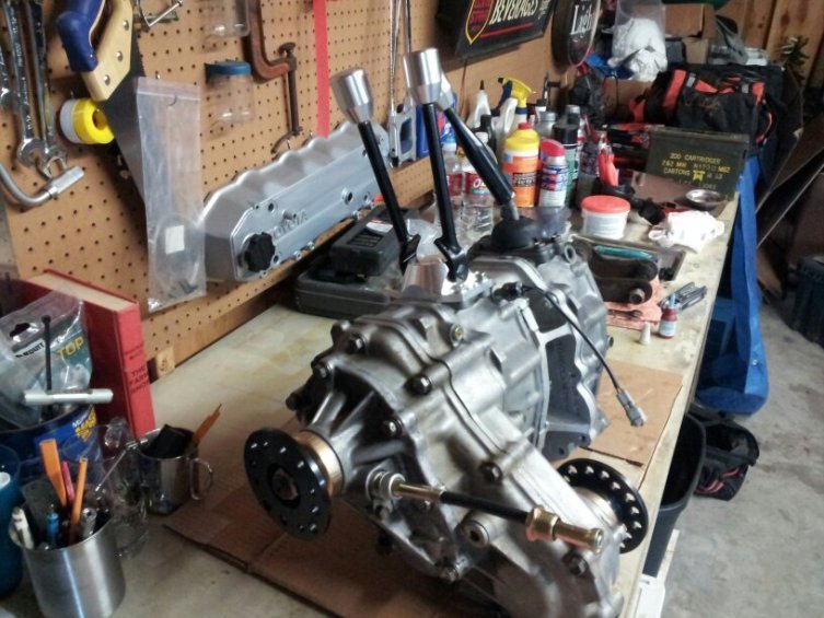

  10. Aug 29, 2012 at 1:47 PM
    #90
    ajohnson
    ajohnson [OP] Glamour Shot
    Apr 19, 2009
    #16145
    8,496
    Andy
    Charlotte, NC
    07 DCLB TRD Sport Prerunner 4x4
    Things and stuff and such
    Alright I think I have the LSPV delete figured out. It seems I can just block off the return line at the T-fitting in the passenger front wheel well, remove the entire LSPV assembly, and connect the rear pressure line directly to the flex line. I was making it seem harder than it is.

    KM2's were on sale and I got a hook up on price and road hazard. Some of these 4wp guys aren't bad but their labor sucks.

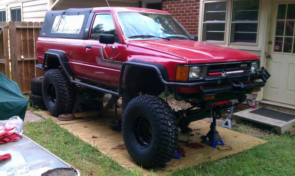

  12. Aug 29, 2012 at 4:55 PM
    #92
    Max-4_Yota
    Max-4_Yota The Welfare Cadilac
    Dec 10, 2009

  13. Aug 29, 2012 at 4:57 PM
    #93
    ajohnson
    Apr 19, 2009
    #16145
    8,496
    Andy
    Charlotte, NC
    Thanks man! I can't wait to get it back on all 4. Still have the brakes to work on while the diffs are out.
