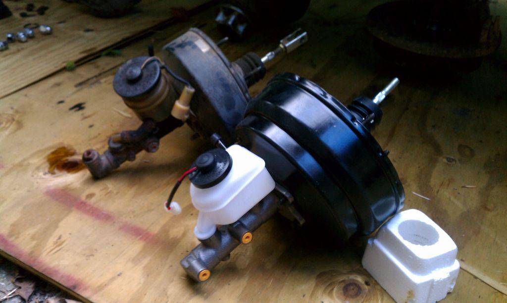

    Forget to mention buddy, don't know if you saw further back in the thread but I got a dual diaphram booster and 1" bore master cylinder as well. Started getting that ready today.
    I went to a couple places after work looking for a plug to block the LSPV return line at the T-fitting up front but to no avail. I decided to get something done but didn't feel like crawling under the truck and messing with the LSPV. Instead I got the old booster and master out to mount up the new pieces.
    The new booster is from rockauto.com and the master cylinder is from Marlin Crawler.
    Here is a side by side pic
    There is a significant size difference between the boosters. The masters don't look much different but that is a 1" bore vs. the old 7/8" bore cylinder.

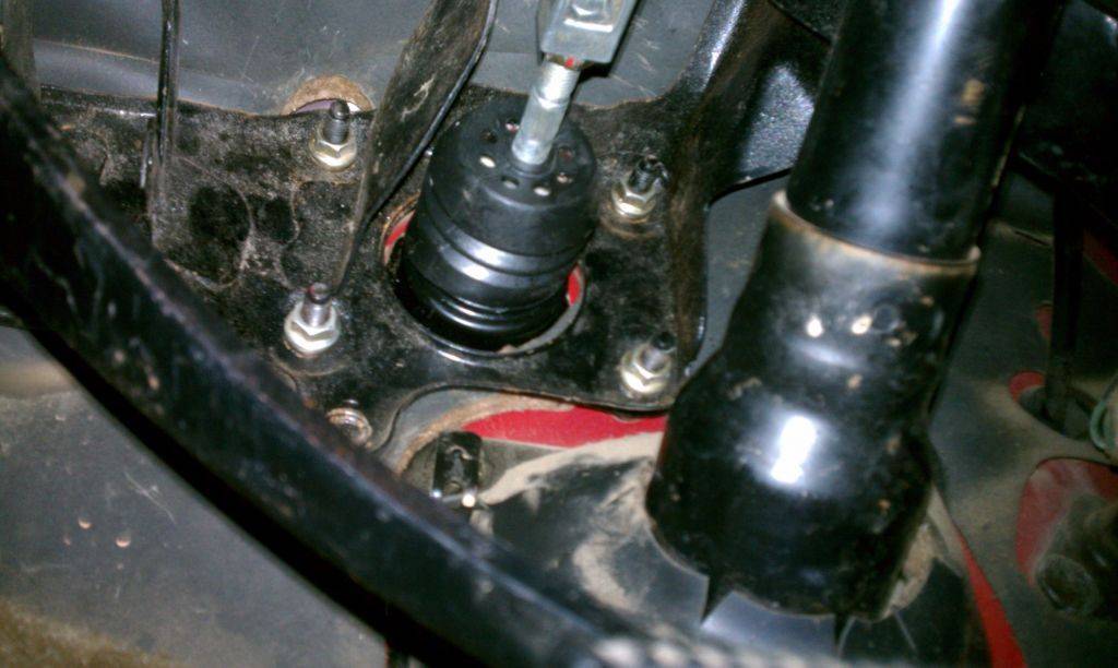

    Here is the space I had to work with behind the dash. Pretty tight but I managed to fit my hand in there after a few choice words (giggity).

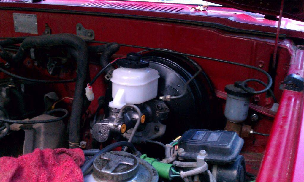

    The master is loosely mounted (still need to bench bleed it) for now until I finish the rest of the system.

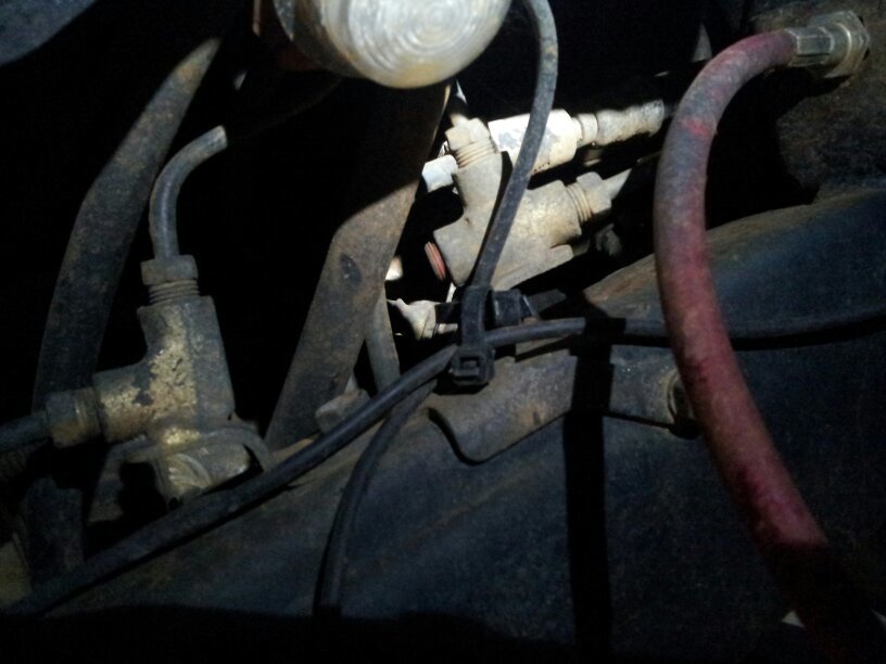

    Here is the pic of where i plugged the port for the lspv. You candy see the red ring of lock tite on the plug at the back of the tee.
    Hope it helps out.

    ^ Yup! Thats exactly what I am going to do. Thanks dude! Where did you get the plug? The places I went to today didn't have anything metric :mad:

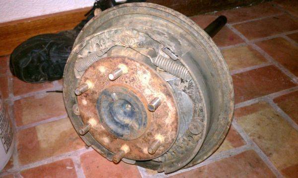

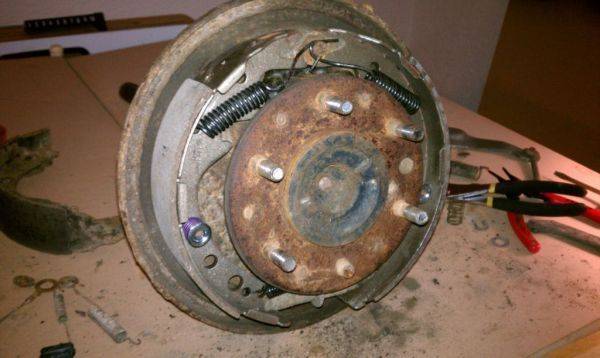

    The weather is shitty for the next few days so I dragged the rear axles in the house to mess with the brakes. I finally realized that the bleeders are built into the wheel cylinders and thank god, I thought I was gonna need new backing plates which are discontinued.
    New wheel cylinders, shoes, hardware, and drums. I discarded all the e-brake crap which is useless now with the driveline e-brake.
    before
    after
    This is just a temporary but much needed fix. I will upgrade to discs at some point.
