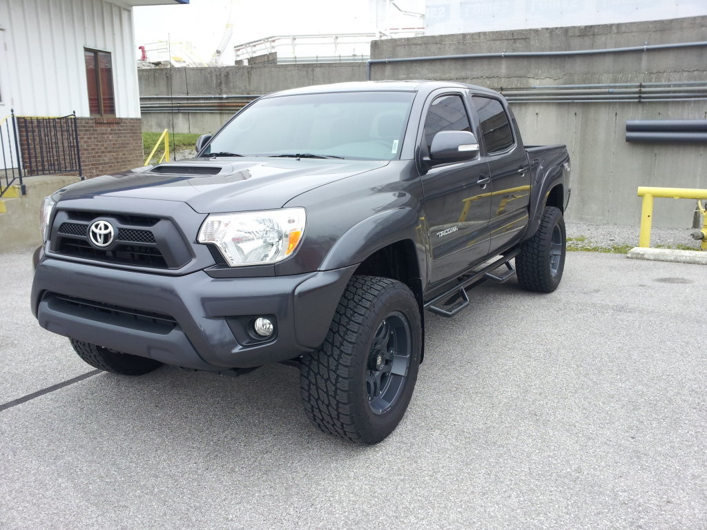

    I have a question about the alignment that I am about to have done on my truck. I found these specs on TW and was wondering if it is what I should go with when I go to the shop. I did see where 0 camber was preferred instead of the setting that it was adjusted to.
    Camber: Actual = .8*, Before =.9*, Specified range = -.3 - 1.2*
    Caster: Actual = 1.4*, Before =.4*, Specified range = 1.4* - 2.9*
    Toe: Actual = .03*, Before = -.01*, Specified range = -.02* - .09*
    SAI: Actual = 10.9*, Before = 10.8* Specified range = 11.2* - 12.7*
    Included Angle: Actual = 11.8*, Before = 11.7*, Specified range = 11.0* - 14.0*
    Front Right:
    Caster: Actual = 1.5*, Before =.4*, Specified range = 1.4* - 2.9*
    Toe: Actual = .05*, Before = -.01*, Specified range = -.02* - .09*
    SAI: Actual = 11.4*, Before = 11.3* Specified range = 11.2* - 12.7*
    Included Angle: Actual = 12.2*, Before = 12.2*, Specified range = 11.0* - 14.0*
    My truck as it sits now gets squirrelly at highway speeds when there is cribbing in the asphalt. Will a fresh alignment with specs similar to the numbers above help with this?
    Thanks
    Btw the truck is a 2013 DCS 4x4 with 285 65 18's Billies set at 1.75 and an AAL
