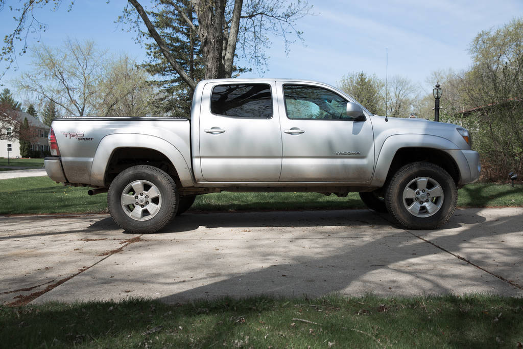

    I have dakars with OME suspension and it rides much better than stock and rides great with 200-300 pounds of gear or trailer... I would say with no load they give you a sport ride but not harsh... I also run the dunes with no bottoming. So they are much better than stock, a mandatory upgrade..
    Removing a leaf does make them softer but carry less weight and lower ride height and if you have a cap you can add an additional leaf to maintain ride height or run the stock pack for a softer ride.... And some people remove an overload spring if they don't tow but want more flex..
    They are a great do it all leaf spring, good ride, great for towing and good for running off road...
    Get the leafs that give you lift you need, good flex and carry the weight you need and type of use(overall use, rock crawler, desert truck). Dakars work perfect for me right now for overall use, but if I didn't tow I would look at a spring with better flex and no overload spring...

    Estimated Dakar lift
    1. full pack 3"
    2. 1 leaf removed 2"
    3. add a leaf 4"
    sag with a 300 pound load is around 1 1/4"

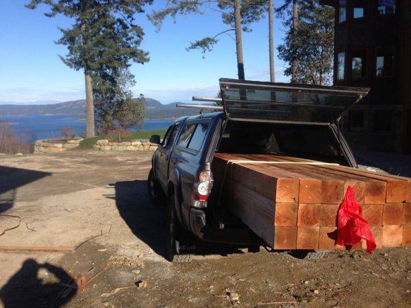

    There's a thread

    Not sure if serious
