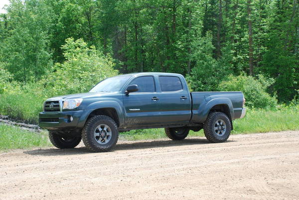

    I got a full 3" lift front & back.
    885s up front trim packer no spacer. Dakars in rear.
    Didn't measure center hub to fender before lift, did fender to ground before and after.
    After I did center hub to fender 24 1/4" with full tank of gas.
    Great ride on & off road.
    Still need to get my wheel well fillers.
