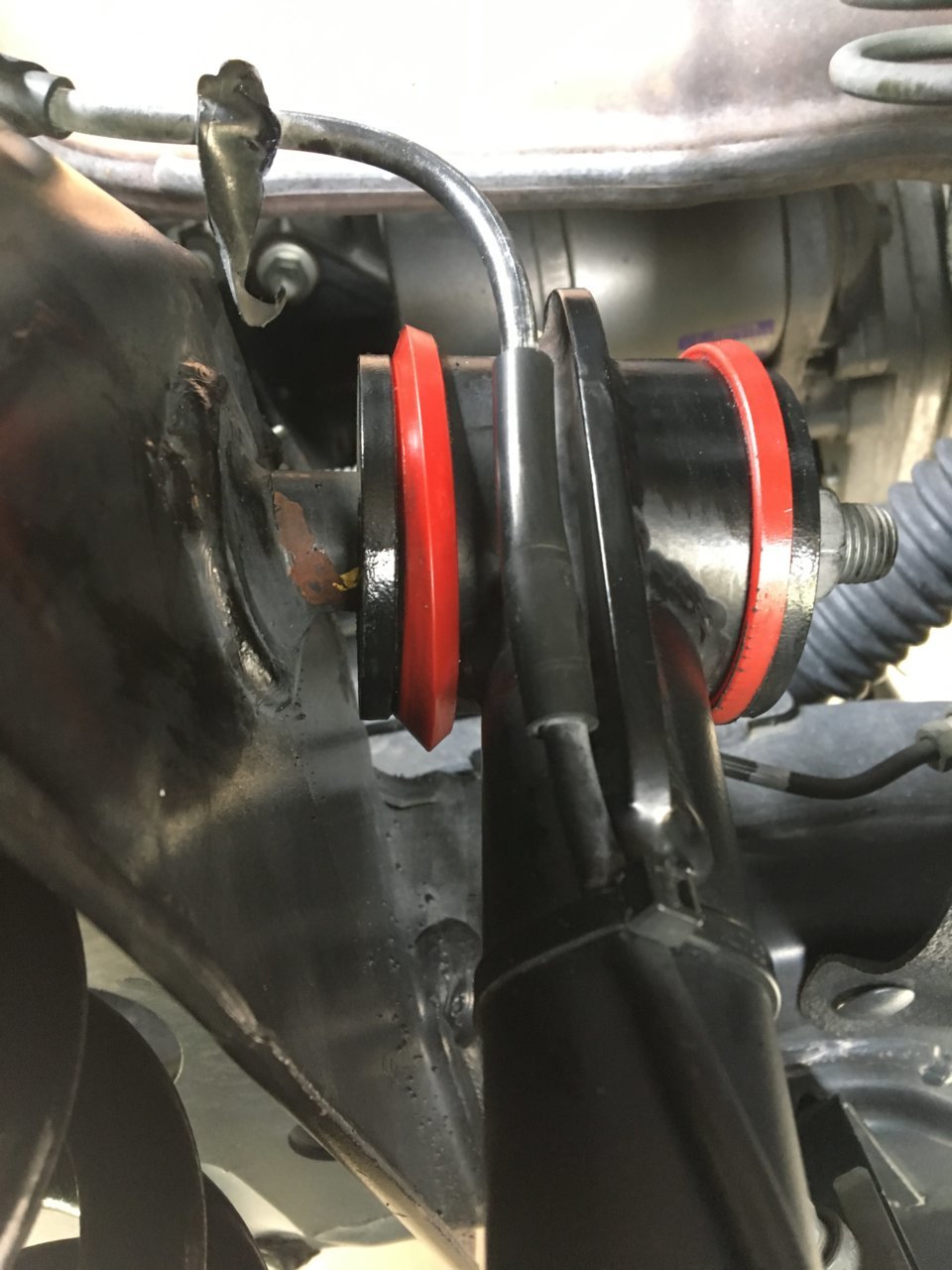

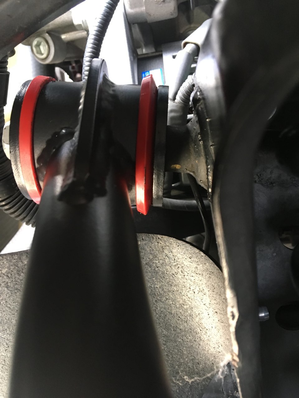

    I just greased my UCA’s and the bushings now look like they are coming out. Is that normal??

    NJ
    Current: '21 Bronco Badlands. Previous: '06 TRD Access Cab, v6, 6-speed
    And no, that's not normal

    It seems like the grease is pushing the bushings out. They where fine before I started to pump grease in.

    IIRC, supposed to loosen the UCA bolt before greasing. Could be wrong though.

    yep. same thing happened to my TC's when I greased without loosening the bolt.

    was just going to say this.

    Thanks guys. I’ll do that.
