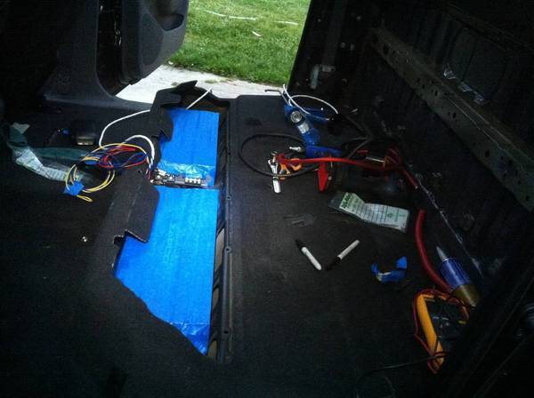

    Ya, that's not going to be easy to put under the back seat. I would say if you plan on keeping that amp the easiest place would be to mount it on the back wall and only use one subwoofer.
    I will say, if you are determined it could go under the back seat... might need some serious modifications though. There are a handful of companies that make narrow amps that fit back there. I went with Zapco: http://www.zapco.com/zapcoproducts.html
    These builds might help you:
    http://www.tacomaworld.com/forum/audio-video/27521-my-09-tacoma-double-cab-stereo-install.html
    http://www.tacomaworld.com/forum/audio-video/120479-06-doublecab-sound-system.html
    My Zapco Z amps test fit:

    I mounted behind the back seat like most people.

    Amps under the rear seat looks so nice , not sure if I want to deal with something that custom though . To bad the passenger front seat has that bar ...
    That one setup posted above with the fans on the side and etc is just amazing !
    I like the idea of fiberglass work but last time I did it , I way under estimated the cost and time that goes into Working with fiberglass . Not going that route again since I plan on have a simple setup . One shallow mount 8 or 10 nothing crazy .
