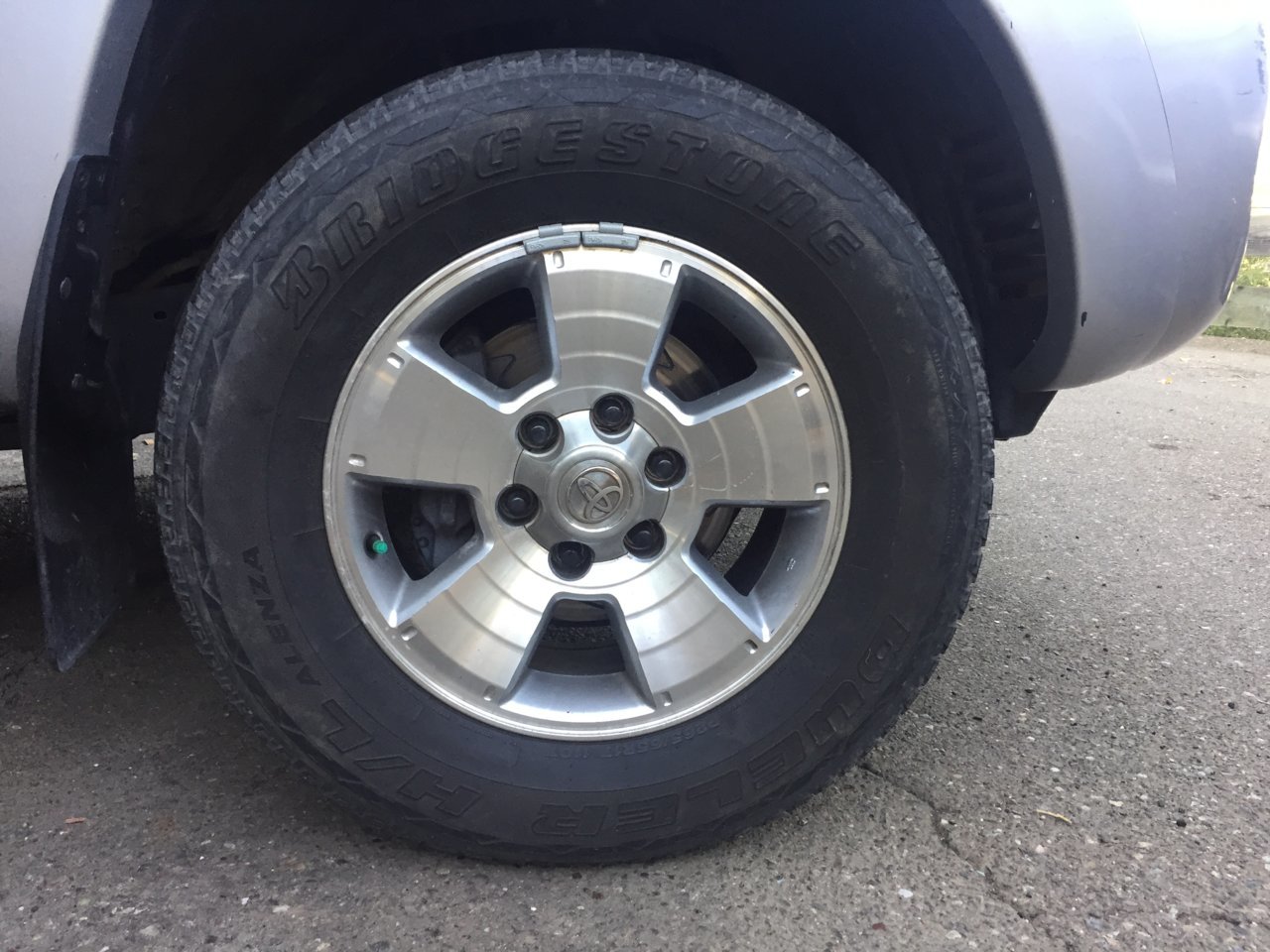

    Wait, a 14WA kit won't fit my stock '05 Tacoma TRD 4x4 17" wheels?
    Edit: Never mind. Re-read Nudavinci's install thread and saw I need 1" spacers to make it work.

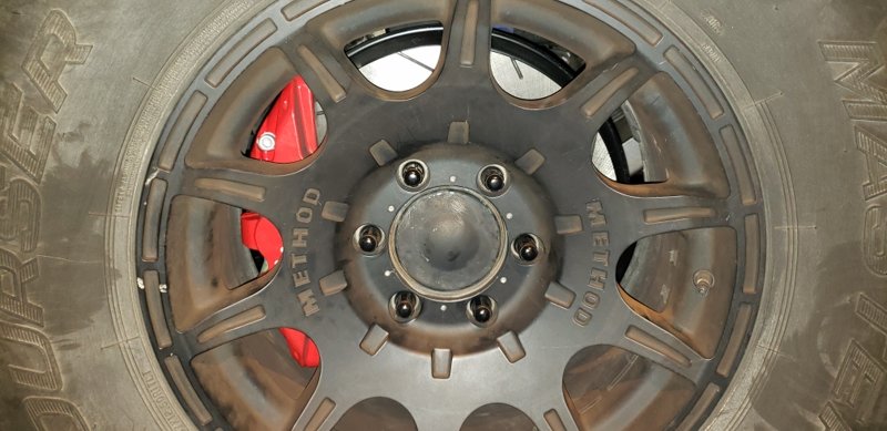

    Mainly the Wilwood calipers are yuuuuuuge. These are meant to fit with 15" rotors as well. I had a difficult time positioning 95lbs of wheel and tire so I wouldn't bash the powdercoat off them

    It fits a lot of wheels. I ran the T4R for a couple years and did hop on the willwood setup. if your running stock and want a good stance you will have spacers anyway. Both are great setups

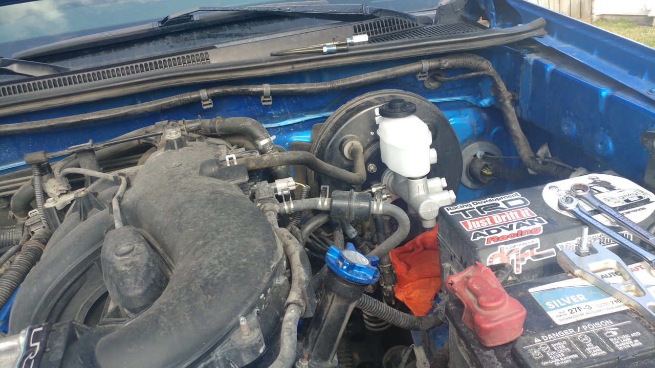

    How did you bleed the brakes and what master cylinder setup do you have?

    Many different methods. Haha. But the best method I know of is vacuum bleeding with pumping the pedal. I have the vacuum booster style master setup.

    Yeah if you use tech stream you can cycle the abs pump vs you needed to drive the vehicle and make it work to bleed it. Its a nightmare.

    For clarification this is the pita system to bleed. If its the one like on the 4runner thats super easy.

    at least you can upgrade the master. Can't do that with the electronic master. yah at my brothers shop we used a computer to bleed it. Made things so much easier since it controls the master. Need to have him do it or get my hands on some version of techstream.

    I've never had a problem bleeding these (I've replaced lots of these Masters and other components, as I work for Toyota).

    On a taco with a vacuum booster I've never need to active the abs to bleed, but I do use my vacuum method. In the meantime I'll be putting the stock calipers back on.
