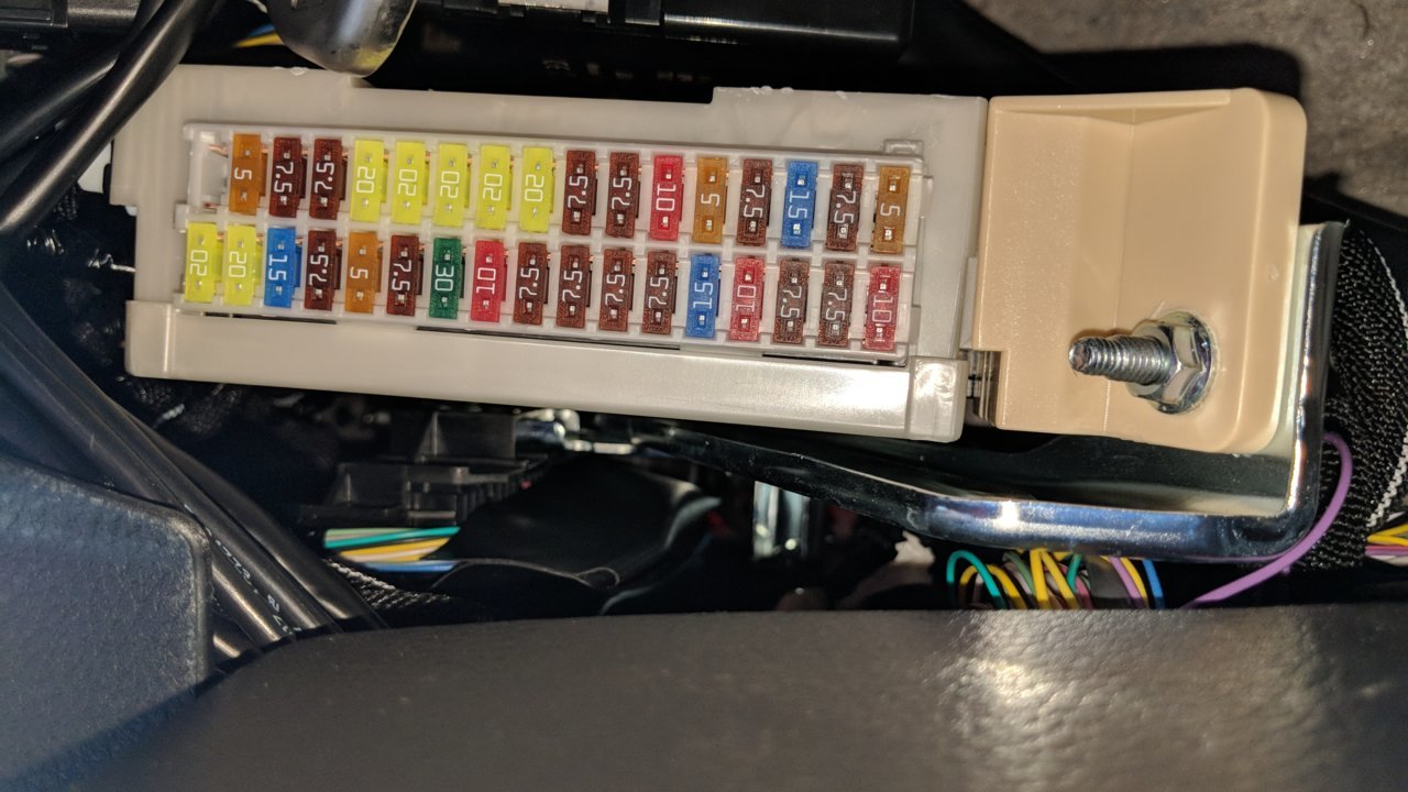

    Quick question. I have a 2018 TRD SPORT 4X2 and I'm thinking of tapping into my fuse box to power some seat heaters I will be purchasing. I noticed there is a fuse in the 4x4 slot, s/htr slot, and s/roof slot. My question is, why is there a fuse in those slots even though I don't have a 4x4, heated seats, or a sun roof? Is it already pre-wired for those and I can use those slots to power my installation of heated seats?

    Fuse box likely has all fuses despite not having the features, check if there is voltage at each fuse and if its constant or only when key on, yes use a add a fuse in place of the fuse there and wire away.

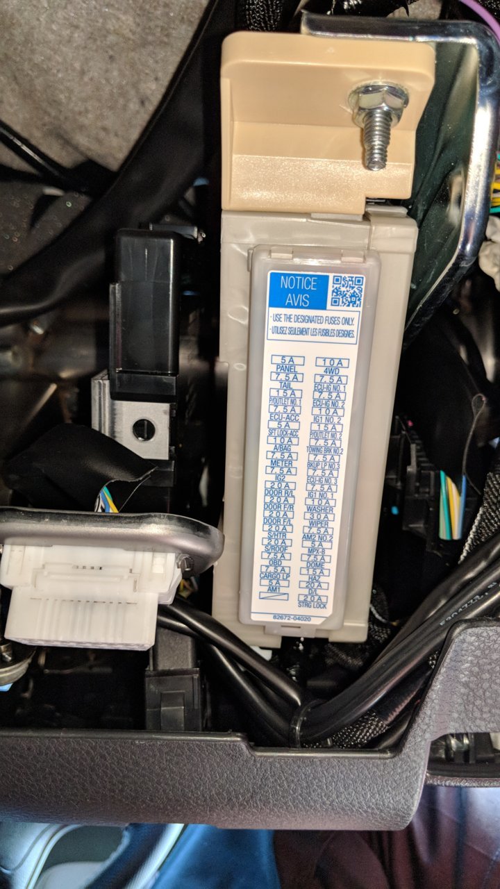

    I've been trying to connect a radar detector into that fuse panel under the steering wheel without much success. Either doesn't work at all or what was on the fuse stops working and I get all kinds of warnings in the console. If you do get this working and could show a picture it would help me out. Thanks.

    If you are using a add a fuse the fuse that originally went in the slot you are using should be in the slot closer to the fuse box, do you want it to be on at all times or only when key is one, the way to check this is with a voltmeter lead touching the contact with the other lead on ground. What fuse slot did you use? What warnings come up?

    Errors say something about "Check charging system", they eventually go away. I was trying to have it powered when the key is on so I didn't have to turn it on/off manually. I am using an add a fuse connector on the tail light fuse which made the radar detector work correctly but the tail lights would not go on. If I remove everything it goes back to working.
    What do you mean by "in the slot closer to the fuse box"?

    Ill post a pic later, move the add a fuse to another fuse and see if that changes it.

    I figured out the issue I was having. The second fuse wasn't seated correctly. I feel stupid but all is working now. Thanks for your help.
