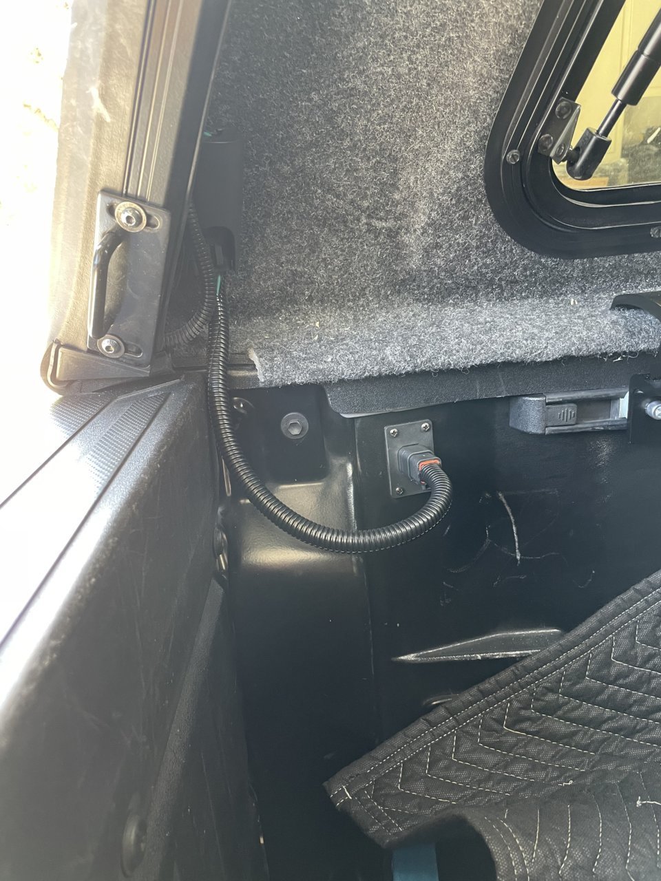

    Also, I can make a whole system using deutsch flanged connectors. They come in 3,4,6,8, and 12 (and I have a guy who will be making me a 2 in black). So things like cargo light, lock/unlock (I make taps for that too), bedlight taps (if you have a cargo light you want to use and have it come on/off with the bed lights. 2020+ don’t even need to actually have bed lights for that option).
    here is an example: from @rmac010
