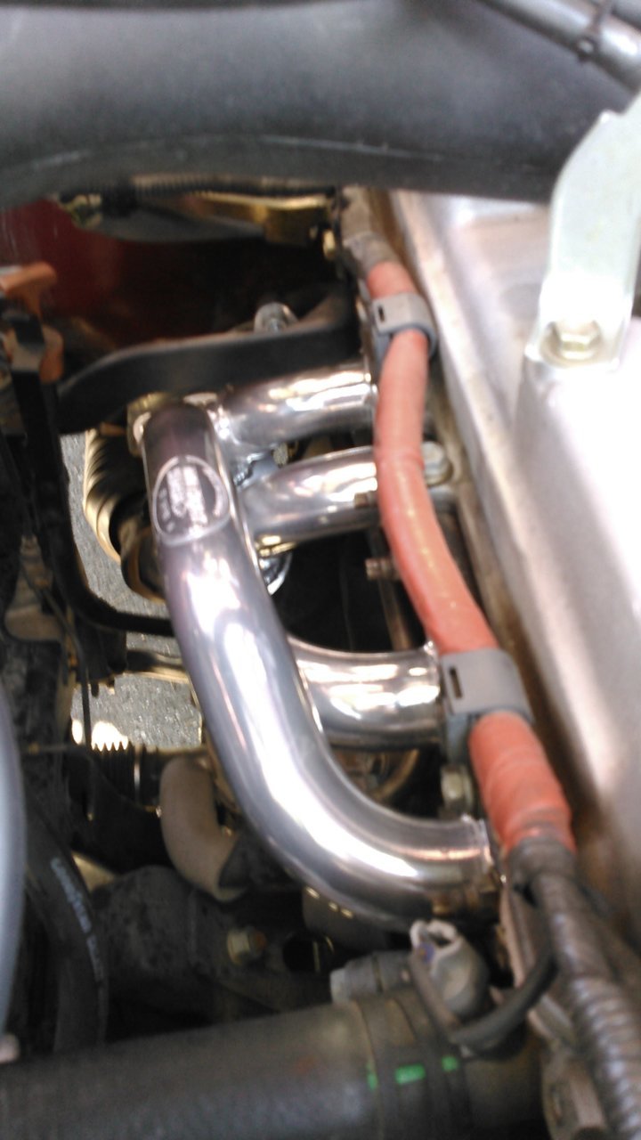

    If you're ordering the same header as mine from Doug Thorley , there's no need for exh wrap . The header comes high temp nickle coated inside and outside. This means there's little to no heat transfer coming off the header . This allows for a much cooler engine compartment
    Still looks that good after 3 years !!!

    Sure does Chuck! Thanks for that! It looks like there are 2 similar part #'s but fairly certain they are in fact different and not just typos THY-511Y-1-C and THY-511-C, the former being yours but listing says ceramic coated. I just put in an offer on ebay for it. Did you replace that cat? I'm in NY so good ole emissions for me...!

    Yes I'm running the Calif CARB compliant # THY-511Y-1-C and its a ceramic coating with a nickel finish
    I had performance muffler shop install mine and being at that time the mileage was only 57k original miles so the cat was in excellent shape
    By mistake I ordered the # THY-511-C header and It had the same coating as the correct header that's on my motor
    You'll like this header as it's a TRI Y design meaning cyl's #1-3 share a merge collector and cyl's #2-4 share the other and this design helps build low end torque

    @pc24 I forgot to mention the header flange gasket that comes with the header will seal against the cyl head exhaust ports with no issues . The muffler shop that installed the header did recommended for a better set up would be by using the OEM exhaust manifold gasket and that is what I did !!
    This OEM gasket is much thicker and better than the Doug Thorley supplied gasket and seals much better . So I would if I were you is get the OEM exhaust manifold gasket from your local parts store

    Uhh :facepalm: it's a Ceramic coated Nickle finish , not chrome . It will last much longer than a uncoated crack prone small Primary tube OEM exh manifold !!:thumbsup: . Also a ceramic coated header will drastically reduce under hood temps !!!!!
    And the Doug Thorley header is a true TRI Y Design with larger Primary tubes and merge collectors . I'm running a supercharger and this header helps scavenge exh gasses and stops reversion which makes more torque down low in rpm band
