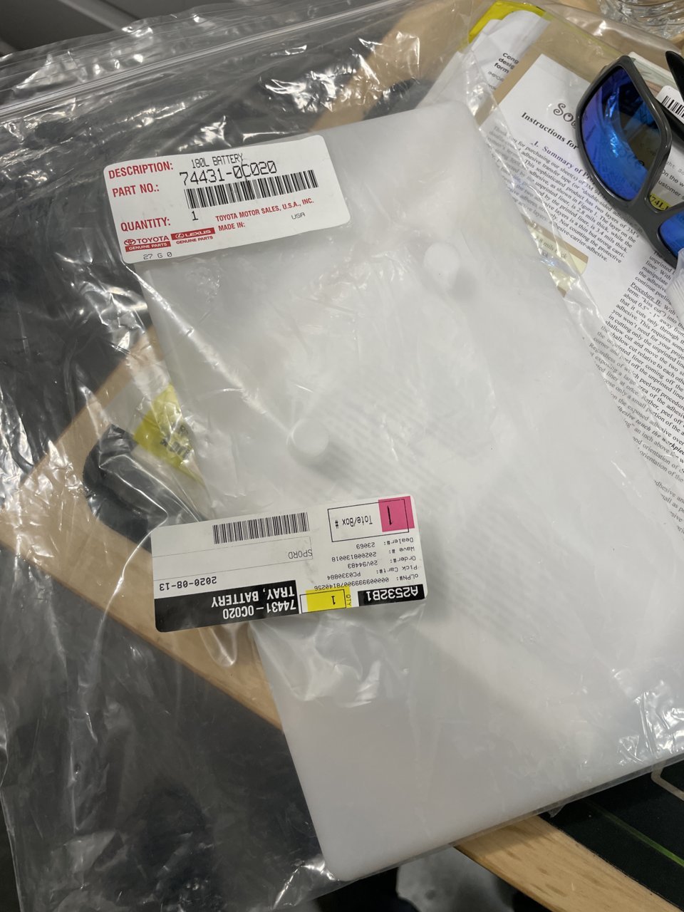

    I’m confused now. I bought 74431-0C020 and it’s like you said Tupperware. Ive actually not even looked at my stock tray close enough and assumed it was the same when I bought it. Just was getting stuff together for when the time comes

  11. Mar 8, 2021 at 7:41 PM

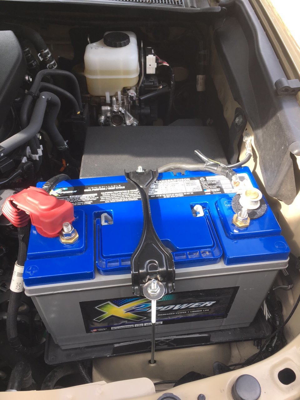

    Nope, been running’s 31 for a couple of years now. Damn thing weighs a ton but no damage to the tray or supporting structure.
