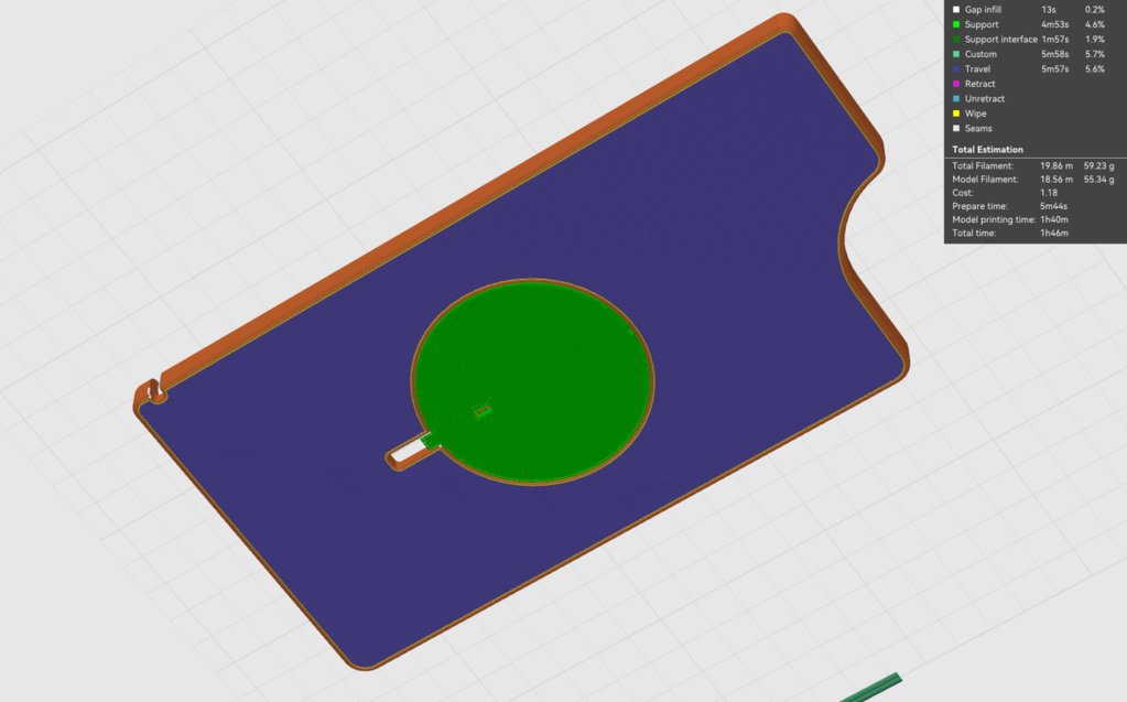

    You don't need to support the entire hole. You can support just the portion the cable comes through and bridge the rest. Much easier cleanup and that part is covered by the adapter anyways.

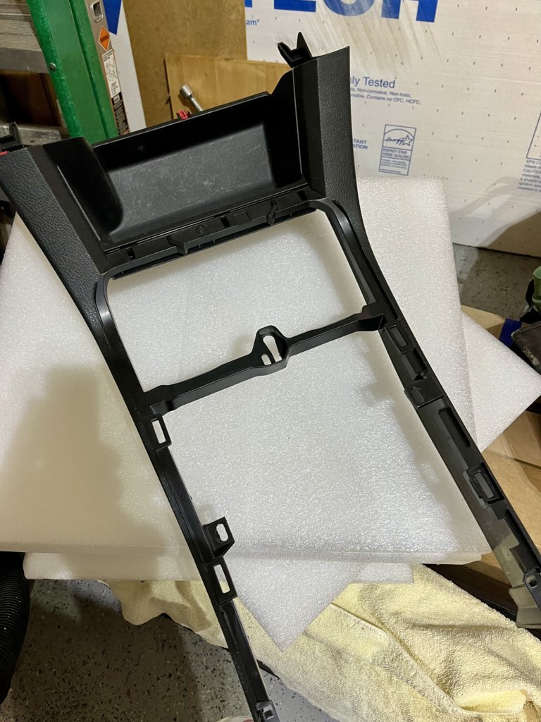

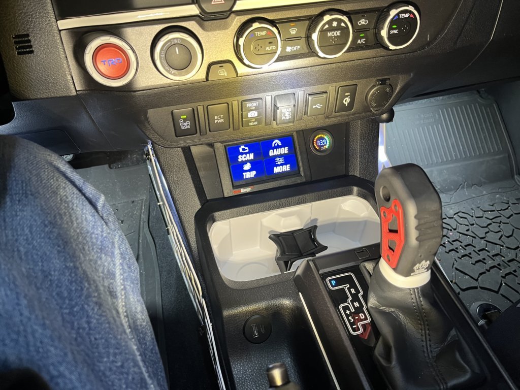

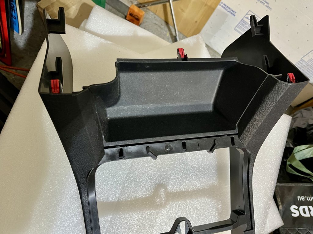

    I had a member 3d print a piece to replace the charger. I then put a scan-gauge 3 and volt meter in it. I also purchased a replacement part without the charger on eBay in case my plan didn’t work. Pics below.
