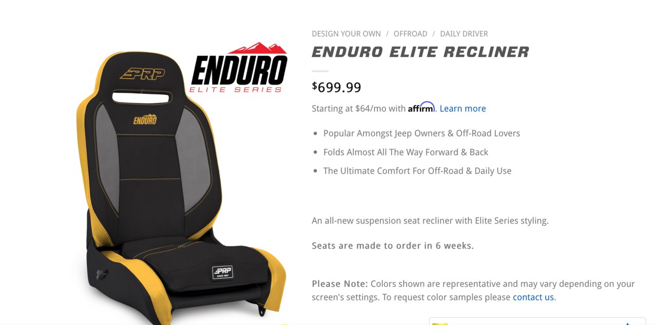

    I just started my search/ data collection for aftermarket seats. I had a set of Corbeau suspension seats in my XJ that I did like a lot. At this point I'm looking for larger side bolsters. Right now my first pick is the PRP Enduro Elite Reclining Suspension seat, it's part of their daily driver line. PRP has the option for custom colors with is fun. What I can't find is the slide mount specific for a tacoma, might have to fab something up or Frankenstein up a mount using the stock mounts. Here is a screen shot of the PRP seat I'm liking the most. prp seat.jpg

    When it comes to the airbag that is mounted on the outside of the front seats, do you know if the light on the dash is going to be screaming at you? The loss of an airbag is a big deal to me when swapping seats, however my everyday comfort trumps it. BUT…. If it’s loss of airbag AND my dash is light up 24/7, that might sway me from continuing much further. Checking out the local Sparco showroom later on today to pick their brains and will pass on any good info I hear

    The air bag will defiantly be an issue, there might be a work around out there. I have to keep searching. Yes please, any info you can share would be great.
    There are some sweet factory seats with side airbags we might be able to swap in. I know someone here is fitting a set of factory Nissan Juke Nismo seats in with side airbags. Saw the thread here recently.

    Airbags and sensors will be an issue.
