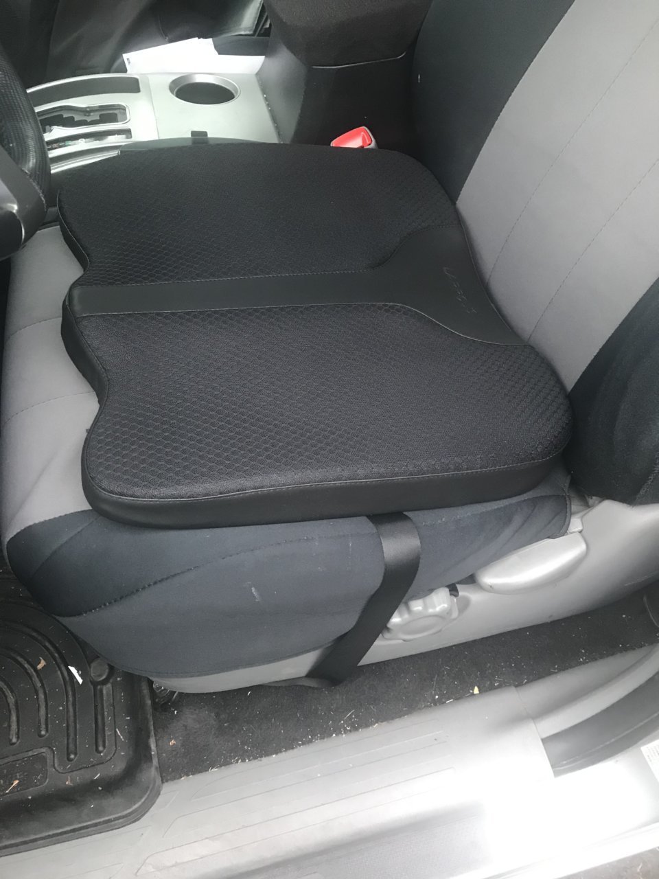

    I don't like the idea of lifting seat and increasing the moment arm in the event of a crash...pretty certain insurance companies would drool over that mod if the were found liable and found the mod... just my $.02
    I tried my 3" memory foam cushion I use in my kayak last night for a three mile drive...Big difference, but too much lift for me (5'9").
    I ordered a slanted car cushion off Amazon today. Will report back on how that works. It measures 2.16" back and 1.70" front.

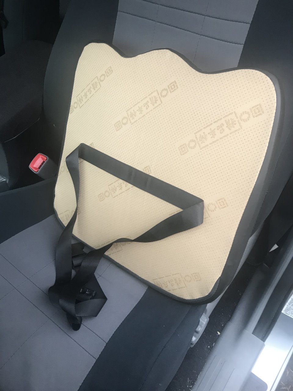

    The memory phone seat cushion arrived on Saturday. So far so good with 100 mile drive that afternoon. You will sit taller, wife even noticed and gave me some grief. I gave here a sensible chuckle. Cushion comes with a strap for under the seat but it did not move around on my and I did not attach the strap. I'm 5'9" and it is an improvement. I would recommend for others in my range or shorter.
