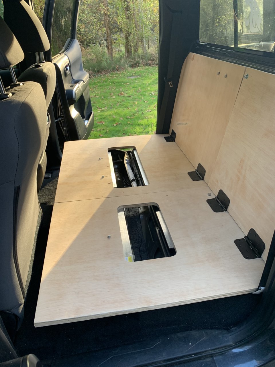

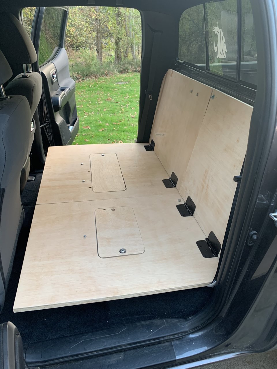

    One thing I wish I would have done which would have made it a lot easier is to use cardboard templates. Use the cardboard to get the size right and hole locations and you should be good to go. I had to open up some holes and use giant washers because my hole locations were slightly off. Hit me up if you have any questions.

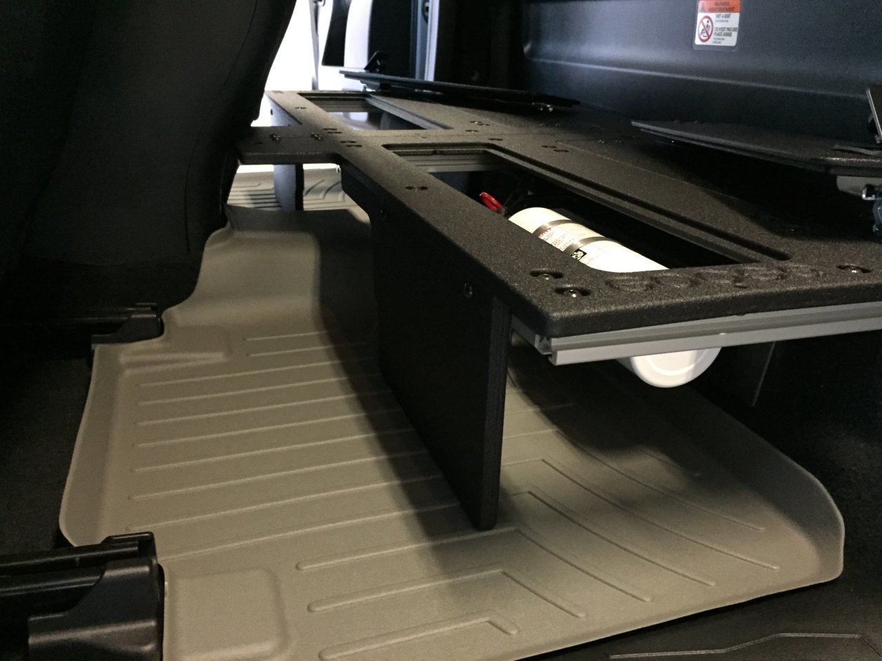

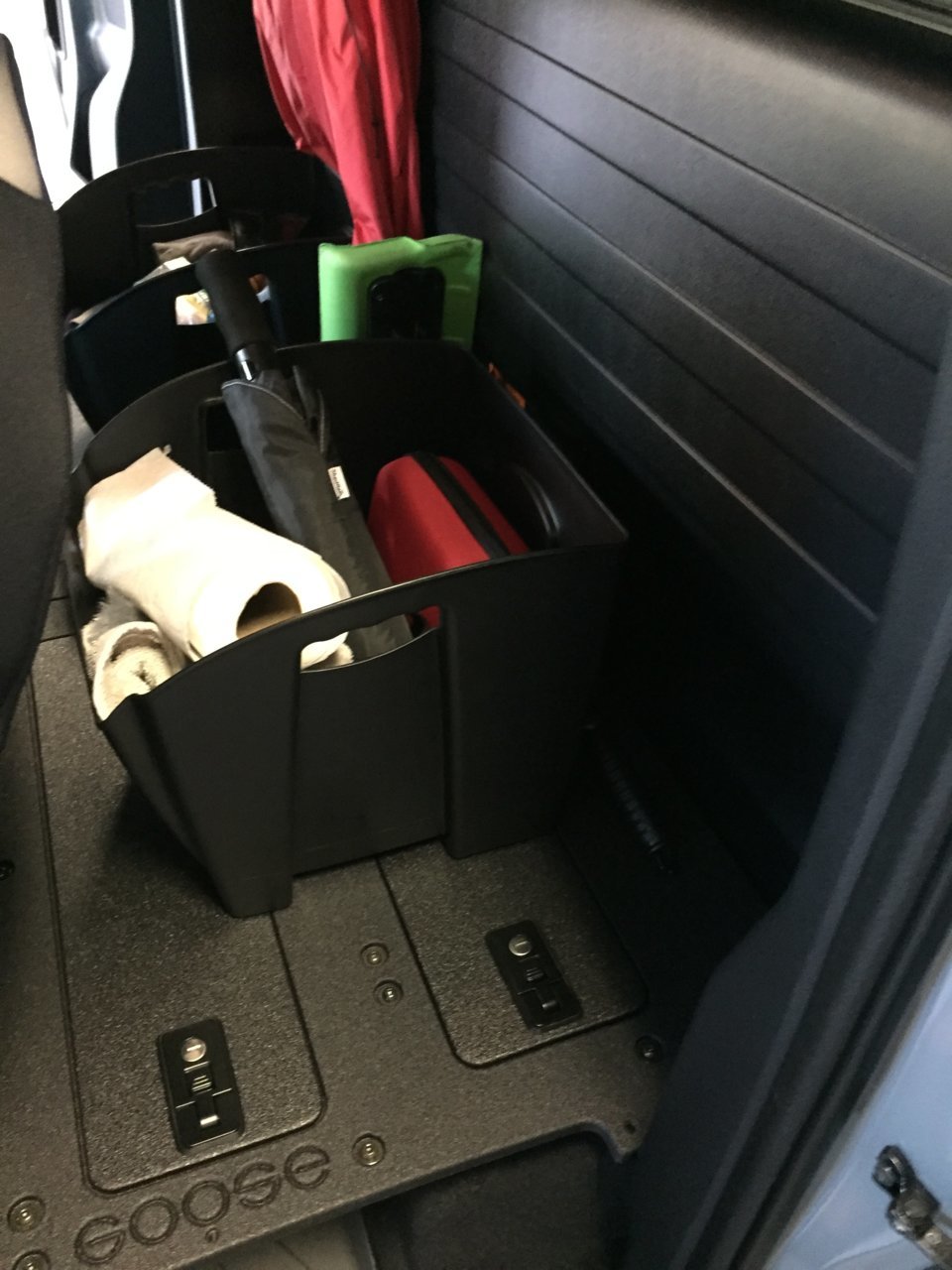

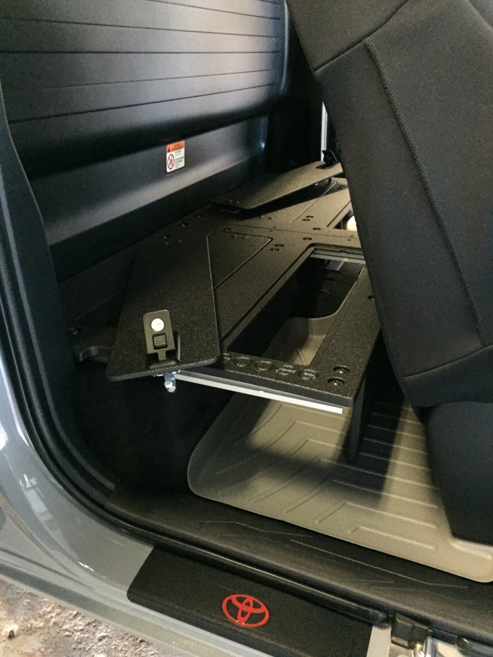

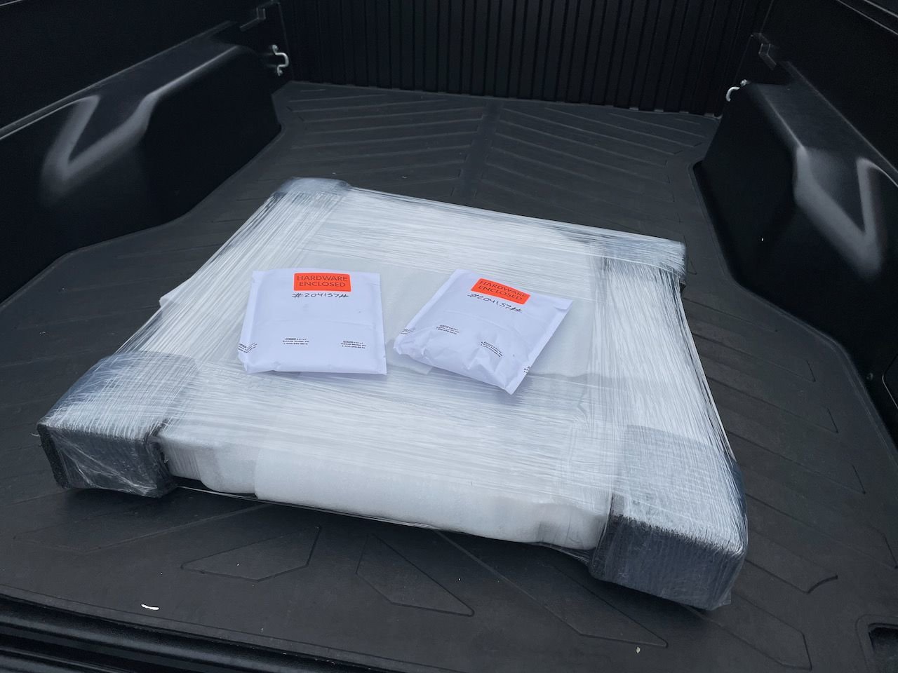

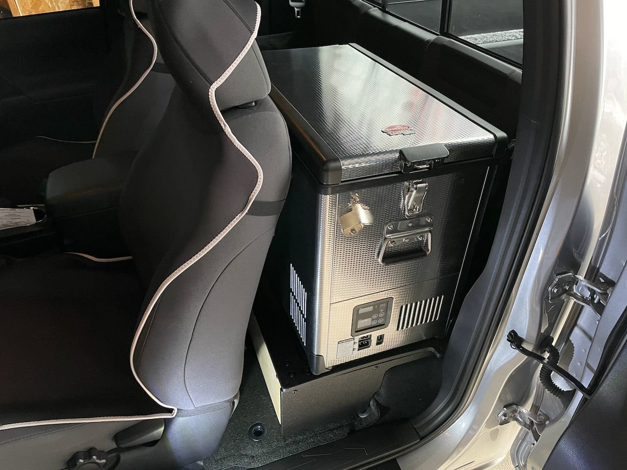

    My Goosegear showed up Friday so I installed it this weekend in my TRD OR AC. These must mostly get installed by shops or they just haven't sold many as there were no instructions. But I just did test fits and figured it out. Under the floor pieces, Goosegear uses aluminum rails for attaching the walls to (there are two walls per side that support the floor over foot areas), and I had to loosen one aluminum rails to fit one of the two walls on the floor. It's really well designed and the walls can easily be adjusted/ moved around.
    I did use this thread on how to remove the rear seats which was helpful.
    The floor was well packaged within a shipping box.
    There were extra bolts, and in fact the provided bolts that go in the back corners holes of the cab (that were used by the seats) were not long enough or the right size? However the floor is well secured in the center and not going anywhere. I will look for longer bolts that do fit at Lowes!
    Anyway, the fit and finish is perfect and it looks great! You can buy/ install just one side or both. If you do buy/ install both sides, there is a plate that bolts between the two sides for added structure.
    There are plenty of additional holes they've put in around the floor to attach whatever you about anywhere that you want. That's a nice option, however if you bolt on something on top of the floor, there goes access to the storage compartments.
    The storage compartment's locked doors are nice and easy to use and I like at least option to lock them. Of course if someone has enough time, they'll just take an axe to it!
    I also did test fit my Snomaster 42L fridge. It fits perfectly with a few inches of room around it for air flow. The lid opens just fine (and the lid easily slides off if needed). I am going to install a dual battery system next. Although yes the starter battery can power the fridge overnight, however I have land that I'm going to be often camping on and I may need to power the fridge more than just overnight between starting my Tacoma.
    From experience with having this same fridge in a Jeep that I also own that does have a dual battery setup, a Group 34 AGM will power the fridge for two plus days (depending on outside temperatures, etc.).
    There is plenty of open room on the other side. A dog bed will probably go here!
