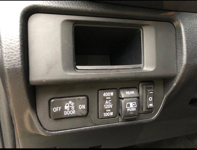

    Is there a 3 position rocker switch that will work with this??? For front, off and rear camera. It would solve my mounting location issue and I can order the kit!

    Any DPDT rocker switch with on-off-on capabilities will work. I just don’t offer them, because IMO they don’t match the OEM/Factory look.

    So I found this thread, about same issue, and a solution...
    https://www.tacomaworld.com/threads/finally-found-a-decent-spdt-switch-for-the-dashboard.183868/
    Here’s the switch, see any issues getting it work with the anytime front and rear camera kit?
    https://www.digikey.com/product-detail/en/nkk-switches/WR13ATN/WR13ATN-ND/2107124

    Yes, it should work. Here is a link another user purchased and installed.

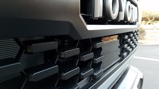

    thanks. if memory serves, these had something to do with the 2018 pro grills? Love to see a pic of how this works/looks with a camera. agree on the 3d printer idea :). Be a nice add-on for your kit!

    Yeah, the 2018 TSS sensor mounts to the back of it.

    So you'd drill a hole in this and flush mount the camera? Does it just (more or less) press fit into the grill in that space, and/or do you know if it works in the 2017 (my guess it would).
    with it flush mounted... I wonder if the angle will be downward enough?

    The center piece in the grill now just pops out and this pops into it's place.
    I'm not sure what the viewing angle would be like. Something I'll have to place with.

    Thought I would share this with everyone because I have a grill that’s not plastic when I drilled into it and installed the camera I wasn’t happy with the look. I was having a beer and came up with this idea to hide the fact that I drilled into it, and the hole looked a little mangled. I just thought maybe it could become useful in case anyone wanted to do this with a aftermarket grille. I’ll probably end up making another one just because I have one small tool mark from where I had to hold the beer cap with a pair of vise grips while I was drilling a hole. However It turns out if you have a Dremel tool and a beer cap everything will be ok.
