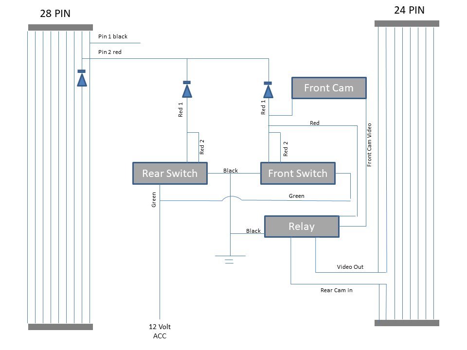

    8,223
    Anybody got a copy of the front and rear camera schematic?
    I can't seem to find mine...:anonymous:
    @Logistics91

    8,223
    Really appreciate that!

    I made it for JJ. Let me know if you have any questions.
