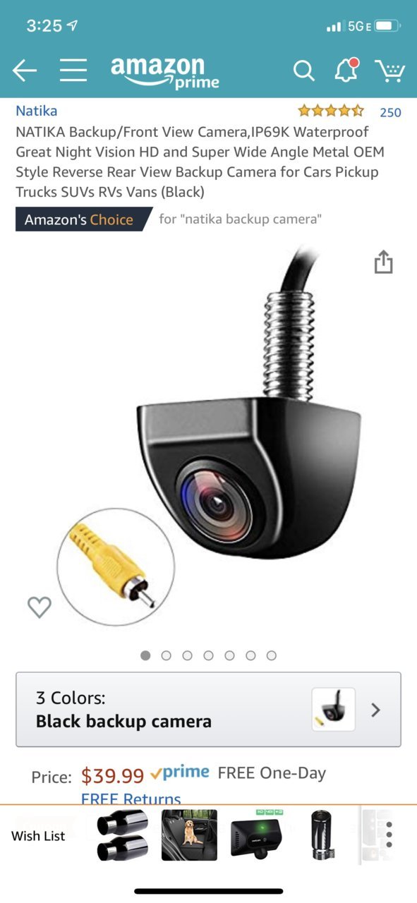

    TW fam, I need help, just installed my kit and I have two issues:
    1) All I can see is the front facing camera now, no radio, no backup camera, nothing but my front camera
    2) My carmera switch light won't turn off, even when I turn off the truck.. Had to disconnect it so it wouldn't drain my battery..
    Please help SOS..SOS.. SOS.. I want this to work so bad and I'm so bummed its not..Thanks in advance

    Which camera system did you install?

    To clarify which anytime camera system, there are a couple

    Sorry about that.
    Natika IP69K

    Did you use the system from post 1 on this thread, which hasn’t been sold for sometime, or www.anytimebackupcamera.com, or the one that uses steering wheel controls? The brains of the device is what I mean, which company.

    Got it work guys. Thanks
