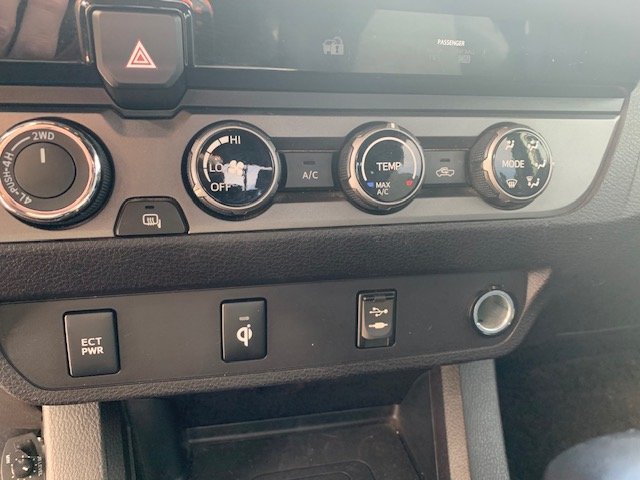

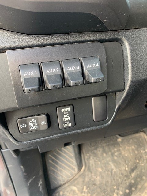

    So I am planning on purchasing this but I believe the camera toggle switch is the same size as the inverter and not the open slot on the right of it. Any pics of where else it will fit? I could put it on one of my AUX switches but there wouldn't be a toggle then.

    Depending on how much money you want to spend, meso customs has their custom switch panels back in stock, or at least they did a couple of days ago.
    Depending on if you use your wireless charging thingy, (I personally don't) you could put it where that switch is.
