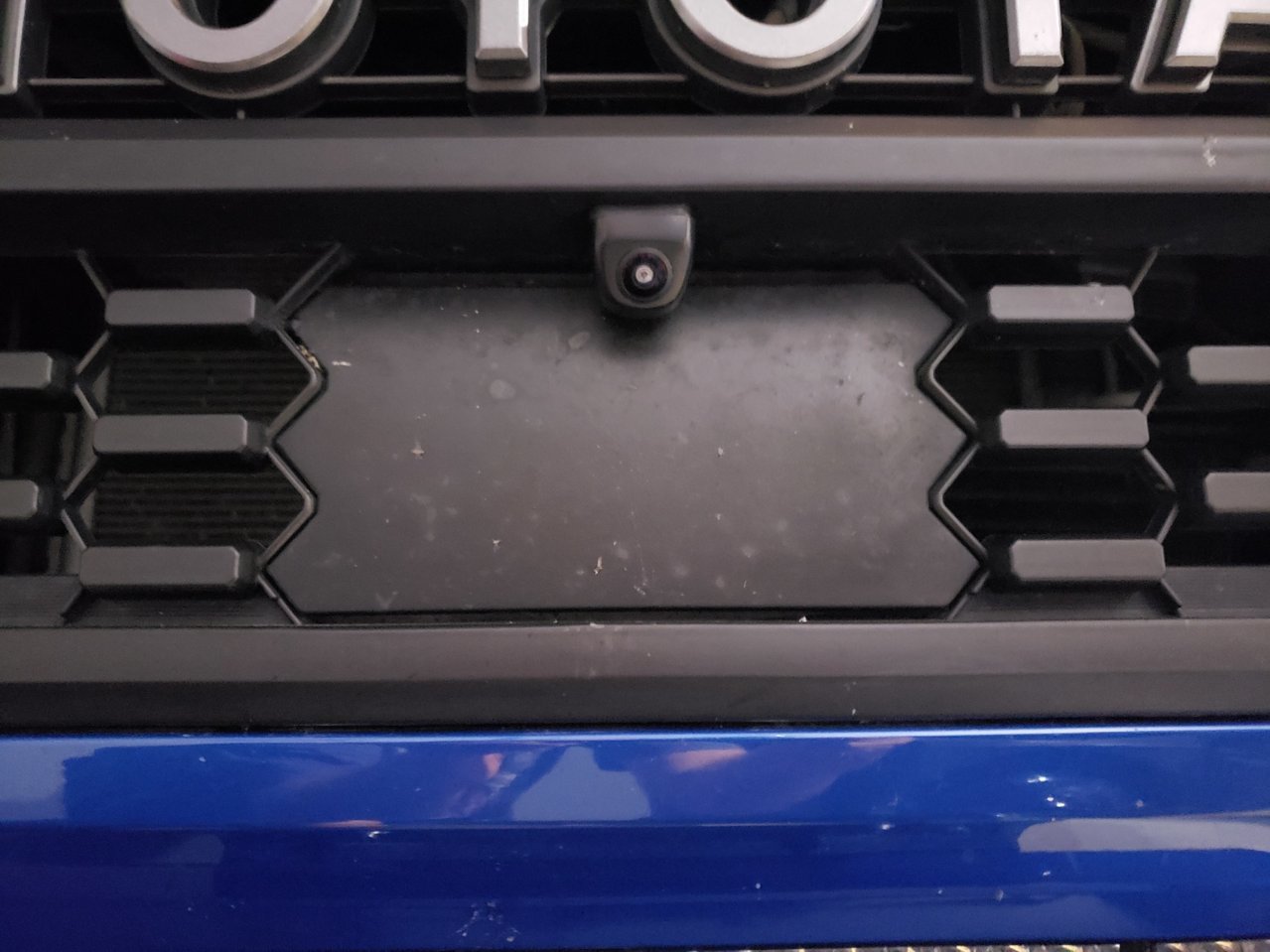

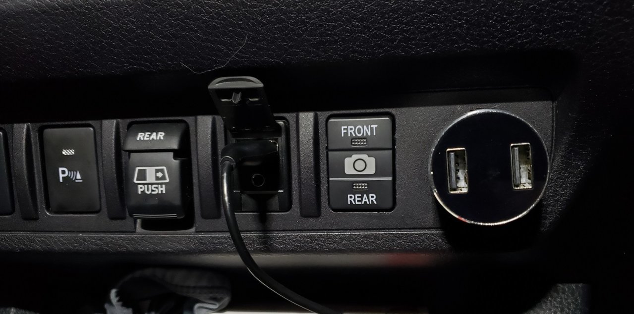

    A friend of mine Installed this for me today ( I was the designated gopher ). He pieced his together on his '16 and liked the convenience of this kit and was impressed with the upgraded Nakita camera. He got it working on his first try, slow and methodical approach.
    A few notes on my install...
    We snipped the white wire to mirror the image. We left the lines in place since I like those to assist with lining my tires to correctly go over obstacles. We removed the Qi charger button and used that slot for this switch, but we had to splice/extend the wire about 12". We put the camera as close to center in front of the TSS as possible without any TSS issues that we could detect for now.

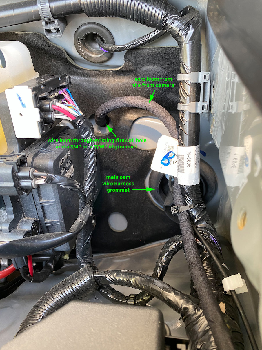

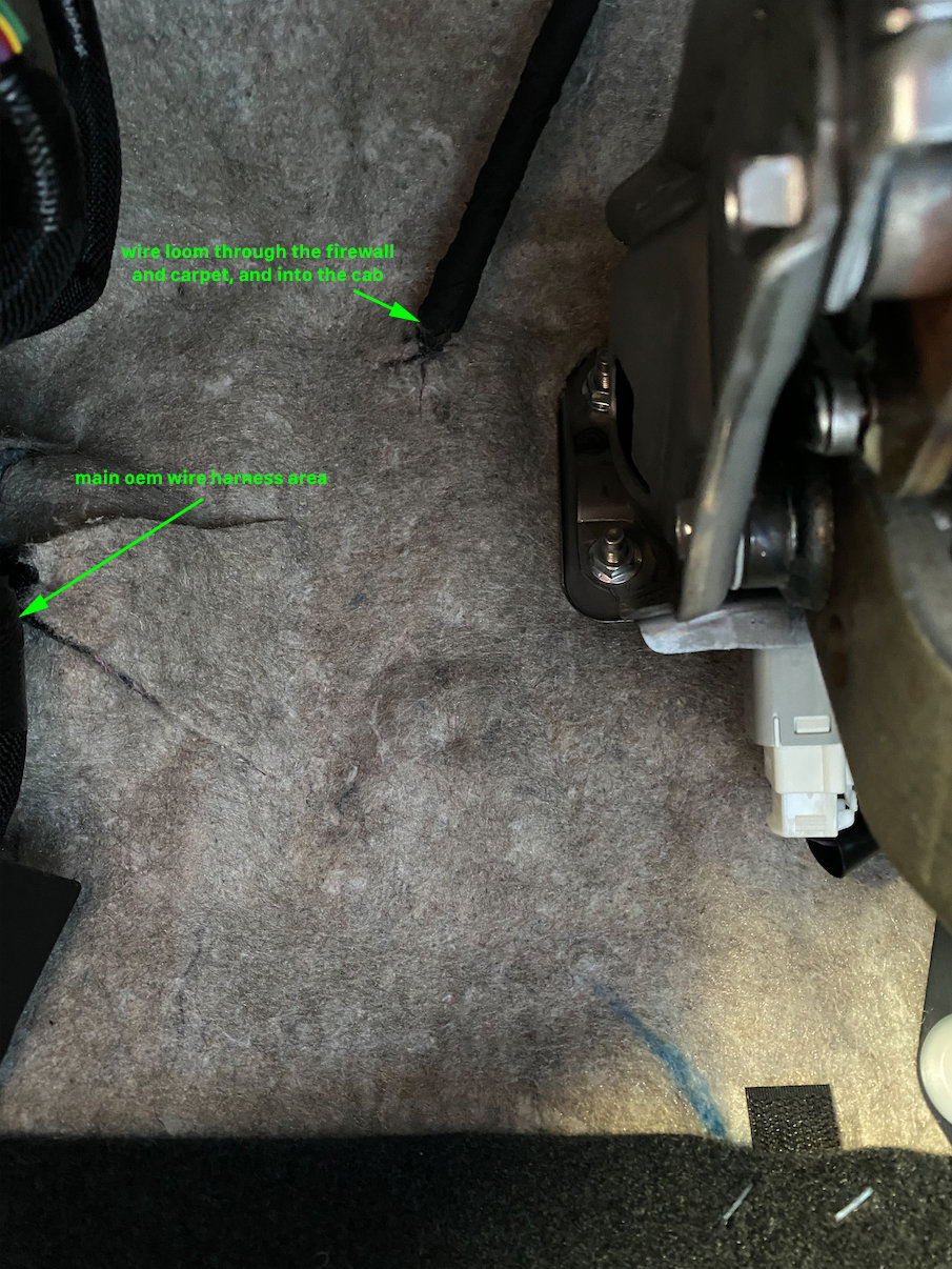

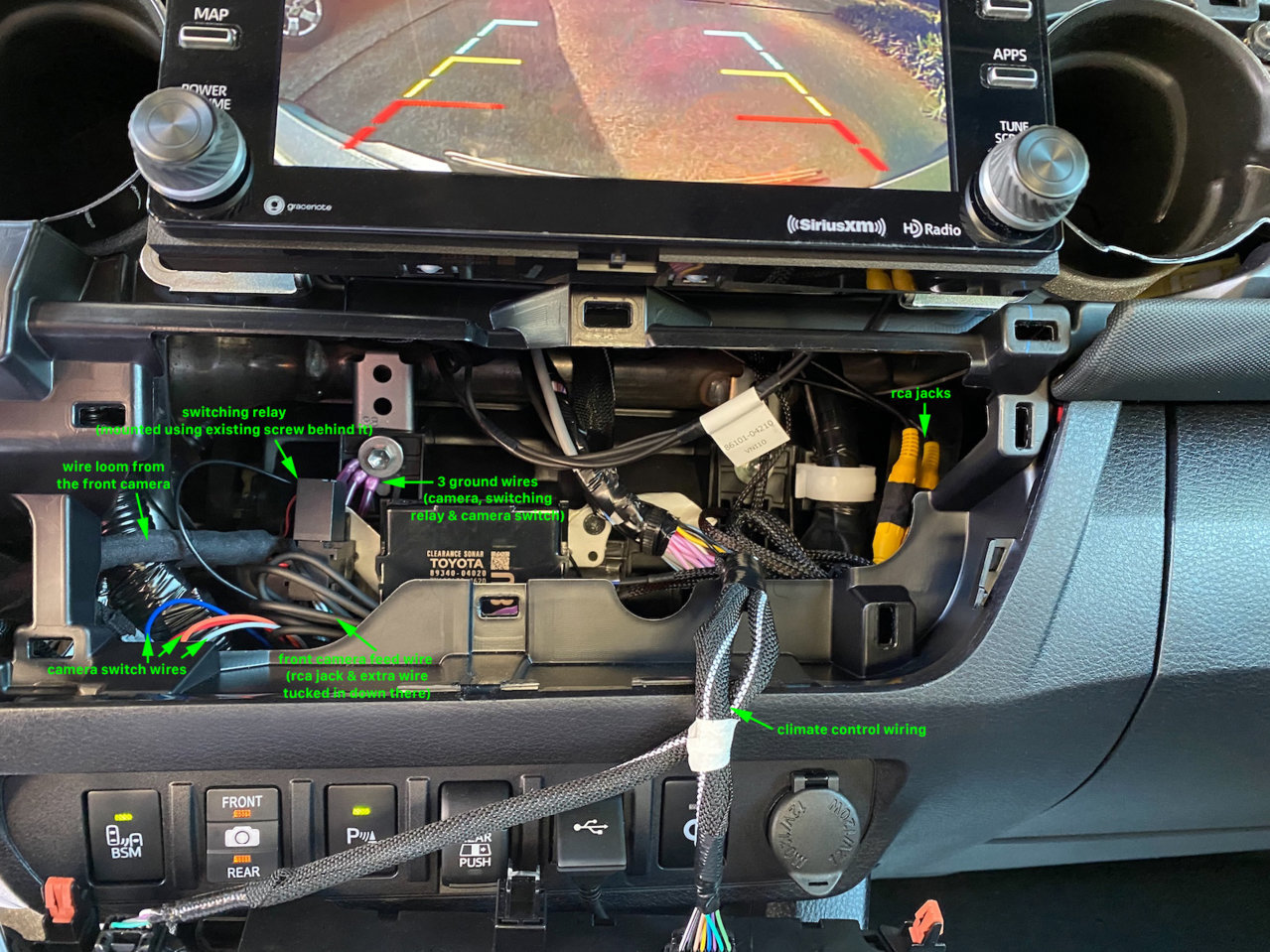

    here's a few pictures of the anytime camera install i did yesterday. hopefully they might help someone that's planning on doing this mod... :)
