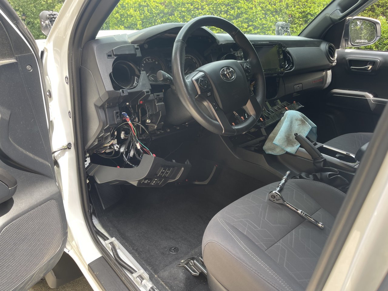

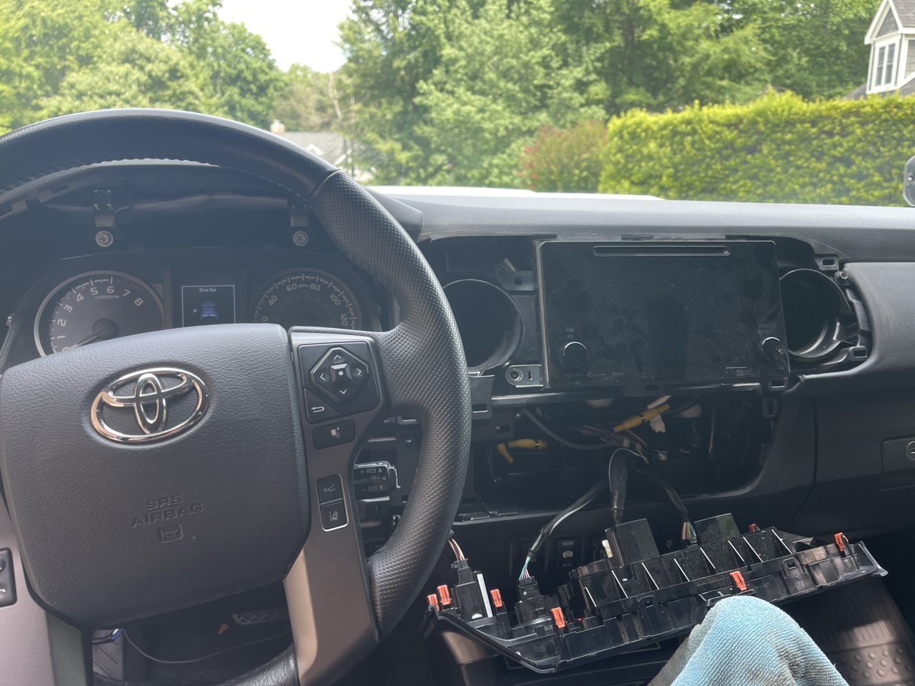

    Actual update: took the whole dash apart just to find out that the bolt holding the ground terminal came loose. Turning a bolt is easy, putting this crap back together isn’t

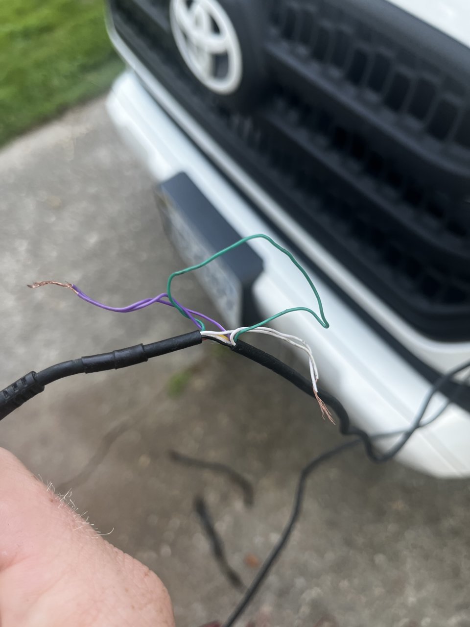

    Without digging through 87 pages…I just wanted to ask about a bizarre issue in having. I picked up my truck from the body shop after replacing my damaged tailgate and bed. Now the front camera is mirrored 180 degrees..
    I’ve had the camera for close to a year and it’s been working fine since. I got it cleanly installed, oriented correctly and have enjoyed it on the trail.
    Very confusing. I have the standard front camera and had already cut the green wire to show correctly. I taped up all the wires with electrical tape.
    Without disassembling the entire cluster of wires, anyone have any idea about what they messed with in the tailgate/backup camera that could be causing the front camera to show upside down?

    Camera physically mounted upside down?
    Repair shop thought green wire was cut in accident?

    What colored wires do you have? Check your green and/or purple wire. White is for lines. If you don't have purple then it'll be what ever color thats not green or white. If that doesn't work try contacting the company and see if you can get a replacement.

    It's the weirdest thing. For some reason as they were repairing the driver door, bed and tailgate, they pulled apart the front camera bundle I had cable-tied under the hood and lazily spliced the cut wires together.
    I do have a premium camera apparently. But I just pulled the wires apart, re-taped everything and it's good as new.
    Why would they go through the hassle of un-taping that bundle, "repairing" the cut wires, re-taping and putting back if they were repairing the driver door and rear end?

    That is VERY sloppy work. At the very least they should have used butt connectors on the wires but ideally they should be soldered together and shrink tubed to seal them.
