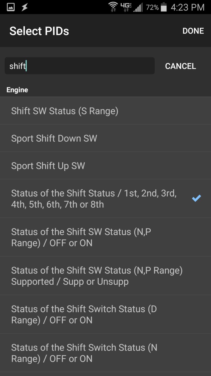

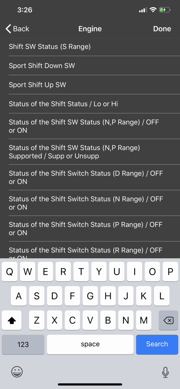

    I have Status of the Shift Status (LO/HI), I assume for the tcase and I have a few Status of the Shift SW Status (N,P,Range) but not status with numbers after it.

    That sucks. Mine looks different.

    Go to the Toyota/Lexus/Scion add-in, Engine section, and search "Shift". That's where it is.

    And those were all the choices I had. Nothing was hiding behind the keyboard.

    I did, I just didnt post a pic quick enough. There is one now you can see.

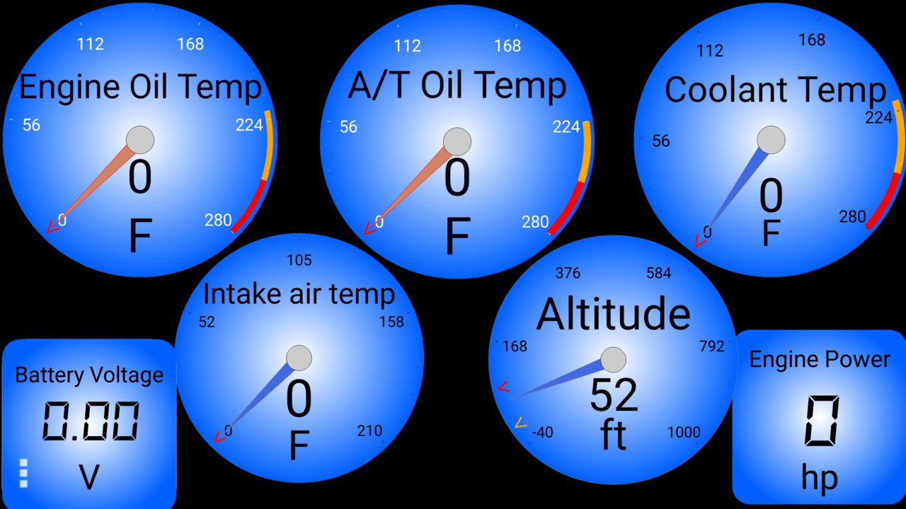

    ak-kev
    ak-kev Well-Known Member
    Jul 18, 2015
    #159727
    79
    Kevin
    Lakeland Florida
    2018 MGM TRD OffRoad 4X4 with Premium and Tech
    Tint, LED interior lighting, LED low beams, Homelink, A/C drain mod
    I'm using the OBD Fusion app with the Toyota add-on and the VeePeak mini wifi scanner. All is good. I really like all the extra info, although it's kinda useless. This is how I have mine set up at the moment...still playing around with it. I've only had it for 45mins. I tried to match the factory interior gauge colors.
    Wow, I just noticed I need to correct the needle colors
    Sorry about the ginormis picture. Not sure how to reduce it down.

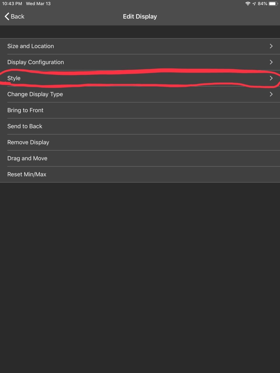

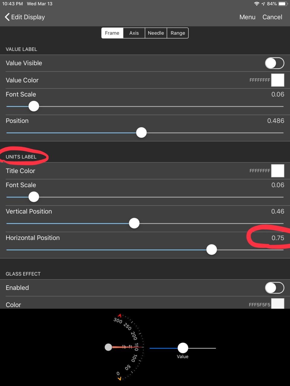

    Hey man.....how did you get the HP and ft lbs off to the side of the gauge.....I can only get them to move up and down. Thanks!

    Press/hold the gauge to enter edit mode, select style, scroll down to units label... move slider for horizontal position.

    Thanks.......it's a bummer, mine only has "position" which moves it vertical, no horizontal.

    I think I had the same problem. My solution, though not perfect, was to edit the title and add spaces on either side of the text in that field to move it right or left until it was where I wanted it.

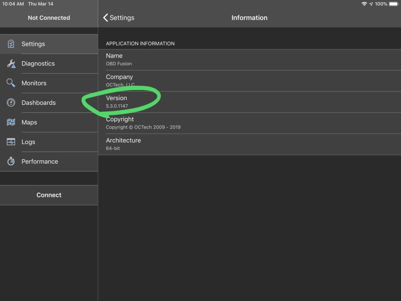

    Hum, my “value label” only has a position slider... that’s why I turned it off. Check for app updates, if you’re on an iPad there is no reason for a difference on that page (strange).

    I use it on my pixel phone......maybe that's why. Says version 5.3.0
