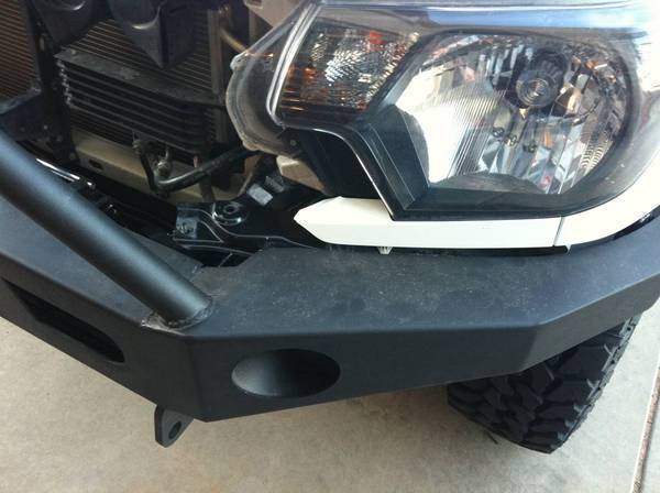

    No rubber gaskets. You really can't close the gap and retain flex. The bumper and body can twist at different angles so you must have some room for the body to flex. I took some close ups yesterday, I'll post them up soon so you can see in detail.

    From the pic you posted above it looks like something is between the bottom of the grille and bumper. That same spot looked different in Demellos pics.
    You might want to lower your bumper a little more. Unless its just the picture. There doesn't look to be much of a gap under the headlights. That small plastic trim just under the headlight will pop off when the body flex's. I had an FJ with a Fabfour bumper. I needed a 1/4" of gap for it not to hit when flexing. Unless the body mounts don't flex as much as an FJ. Don't know yet. Only had mine for 3 days.
    Thanks for more pics. Demellos front bumper is my top pick so far.

    Yes. The thing under the grill is the grill/headlight support. It starts under each headlight and meets in the middle, this is different because of the model year (2012). All the pics demello has out right now are of 2011 and older. My plan is to hit that support with Bedliner to make it match the bumper. But I guess it won't matter when I mount a 20-30" led bar right in front of it.
    Regarding the flexing; I installed the bumper very tight to the body and took it out for a shakedown and I was getting rub on the fender and the bumper was metal on metal under the head light. I lowered the bumper about 1/3" and trimmed the bumper under the headlight. I also removed 1-2 inches from the front of the center support for the grill/headlight support. It was a small section that was sticking out below the support you can see in the picture.
    As of right now there is no rubbing from the bumper. The trim under the headlight is actually set back from the bumper and not directly over the top of it, as it may appear in the picture. I'll get pics up soon.

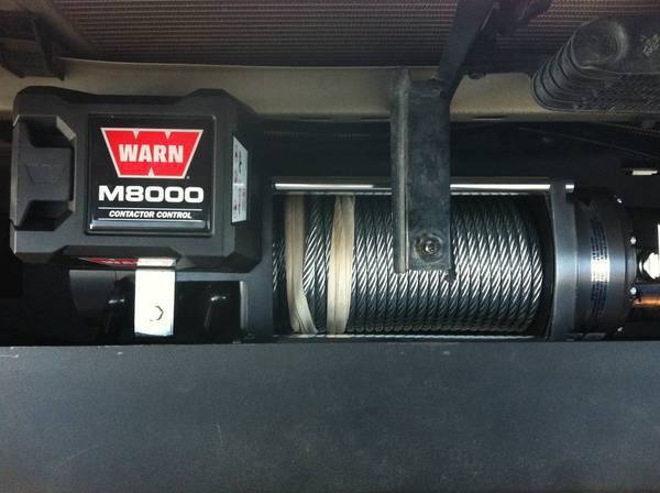

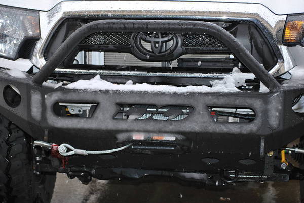

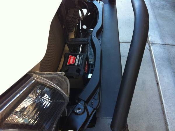

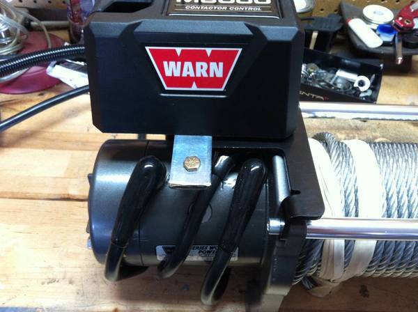

    Here is a little info on the mounting of my Warn M8000 on my Demello bumper. This should give everyone asking a good idea of the gaps between the body and the Bumper. Since i took these pics i lowered the bumper another 1/3" and now i have zero rubbing issues and zero bashing of the bumper into the body, it has been tested off road.
    I started by Modifying the mounting bracket for the control box. I moved it back about 3" using a flat piece of metal from HD.
    Then i trimmed the center grill support. I removed 1 of the 2 screws so the support does not protrude. I also trimmed a little from the horizontal support under the headlights, just to clean it up a little.
    Then i hit the horizontal support with a little bit of bed liner. Previously the support was hidden behind the stock bumper. Now that it is exposed i wanted it to match the bumper a little more closely.
    Added a Warn Hawse fairlead that is rated for steel cable. Also, notice the lower portion of the grill was hollowed out to allow for easy access to the control box.

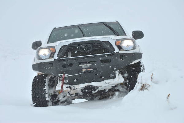

    Then i took the mother F'r out in the snow to make sure nothing would fall off.
    There a more pics in my gallery if you are interested.
