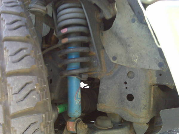

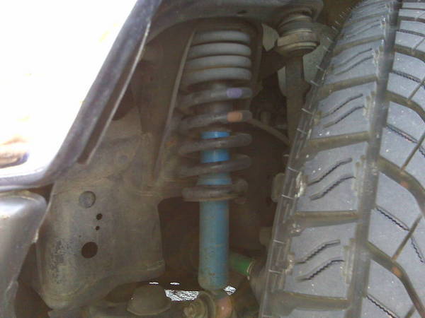

    Here are the front coils still good?
    Drivers Side
    Passenger Side
    Thanks,
    Golfman
  12. Nov 14, 2010 at 3:53 PM
    Trapper6speed
    Trapper6speed Hacksaw engineer
    Mar 7, 2010
    #32752
    871
    Stock
    Front springs look pretty done too. We don't get the best springs from the factory.

    The front is shot as well as the rear.
