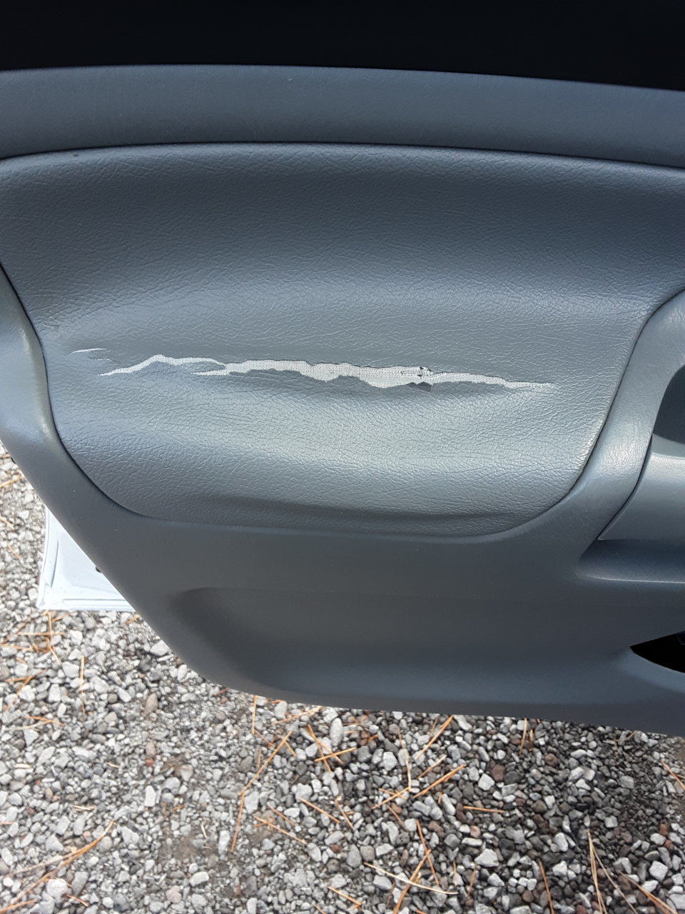

    I have a 2006 base model Tacoma and the armrest on the drivers side has a crack in it below the surface, like the plastic below is cracked. I'm wondering how to fix this. Do I need a whole new door panel or can I replace just that part? I'm attaching an image. I see on ebay they sell these leather arm rest replacements, but I wondered if that was just the cover of it and not what is below, the hard surface, you know. [​IMG]
    I've included an image of what is broken. thx.

    Go to a junk yard also called auto recyclers.

    Yeah, this is a common issue. Mine cracked 6 years ago and I’m just careful now to not put too much weight on it with my elbow. The crappy part is you have to take the entire door panel off to get to it . That’s why I just left it

    You only have to take the door panel off to repair it. Watch the video.

    Someone on here did a great writeup on how to fix it. Do a quick search and I'm sure you'll find it. He did a really good job.

    conflicting info on door panel removal...
    for what its worth, i side with @Muddinfun, door panel removal is quite simple.

    How's that conflicting? Remove door panel - from the door frame - fix broken part.

    20191119_085224.jpg here's my beauty mark

    Originally his post stated “take entire door off”.
