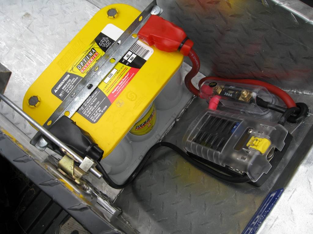

    Nice install. I have a Snugtop shell on the truck so that will not work for me.

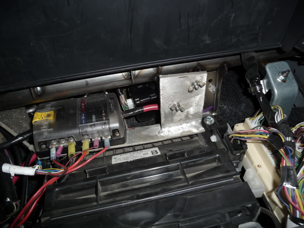

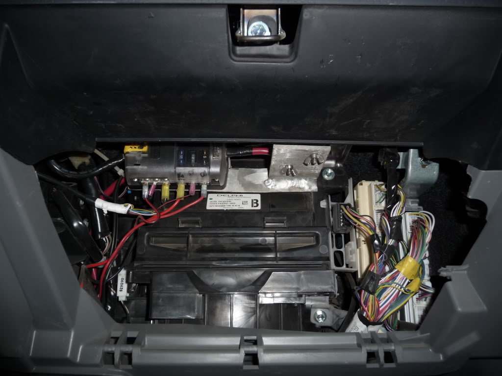

    I dont have pics now, but I was able to fit the Blue Seas fuse block behind the glove box on a bracket I made. Keep in mind that you will still will have to get a good size pair of cables to it depending on what you want to distribute to. I think I ran 2 or 4 ga. cable to it. I will see if I can get a pic or two in the next few days.

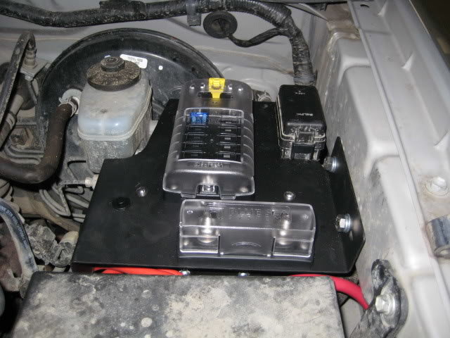

    I have mine under the hood at the moment on top of the stock fuse block. It doesnt get too dirty. It is high enough for water to keep out of it.

    Here are a couple pics of one behind the glove box. The mount and block come out by removing the wing nuts then you can pull it out for easy access. If you have it out when you wire new stuff there will be enough extra wire slack to pull it out again and work on it.

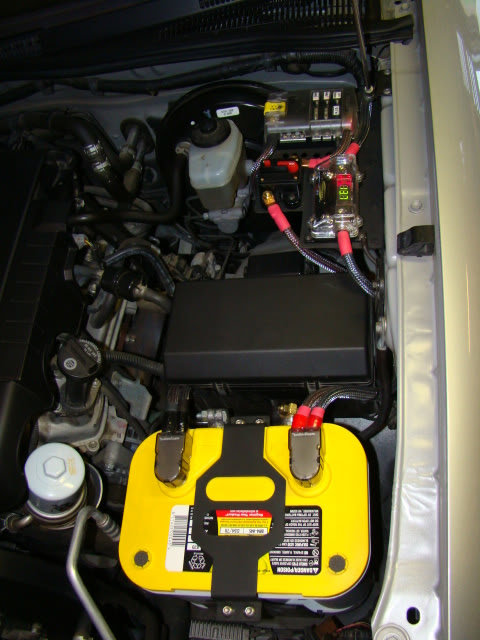

    see my build thread in my sig...looks much like the other blue sea installs

    That's where mine is. Problem is that if I have to get to the stock fuse box, it can be a pain in the ass.
