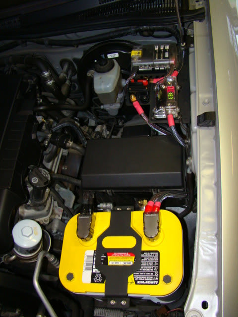

    Those look like the Hella Relay holders and fuse blocks. Where did you buy them? The relay holder seems to always be on backorder...

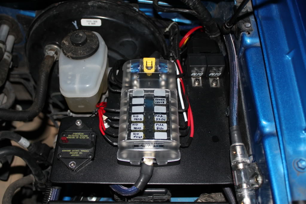

    Here's mine, been going strong for well over a year.

    Yes, nice bracket, but with a 6 speed I have a clutch fluid reservoir mounted there and will have to mount an Aux Fuse Block on the passenger side...

    Thanks for the words dude! I like the relay blocks for sure. The cleaner the better!

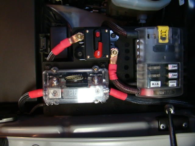

    Here's my set-up...I've had it covered with mud and used a garden hose to clean it off. I have never had any issues, I just made sure to completely dry it off.

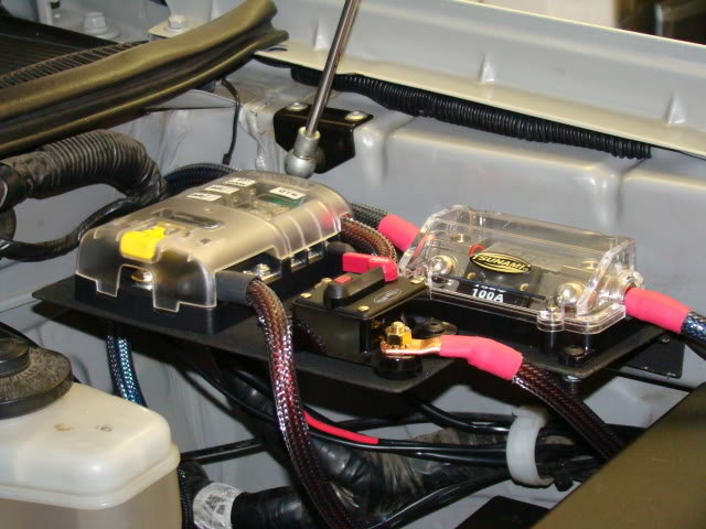

    Thanks for the ideas guys. I finally got around tofabricating a mount and installing my fuse block to get everything off of thebattery. Thanks!
