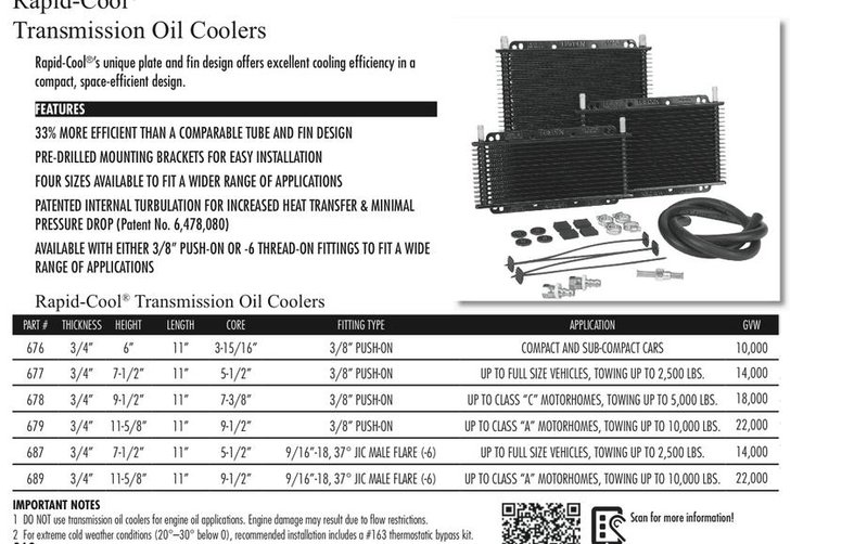

    Well, if i put it in front of the radiator then you could fit the largest one they offer i believe.
    But then you could overcool it.
    I think i'll get the 14,000 GVW one and if it ever runs above 190* i can add a smaller cooler on a thermal bypass.
