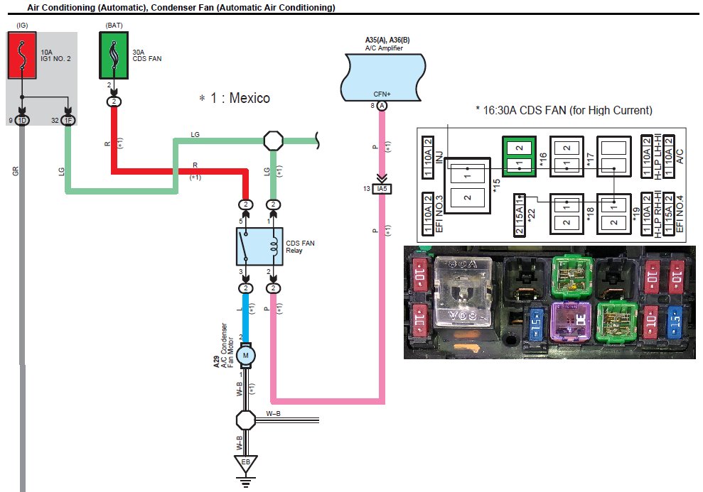

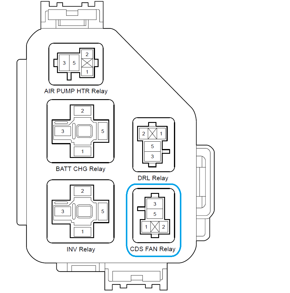

    That's a helpful diagram & image @caribe makaira. Do you know where the CDS fan relay is physically located?

    Your taco most likely doesn't have it or the terminals to attach the relay.

    You are probably correct that my Tacoma won't have the relay or the terminals to attach it. I will look later. At best I expect to find a blank spot.
    The elegant solution is to run a set of wires and terminals that duplicate the OEM setup. It can be done, and I have some similar things on other vehicles. It is usually easier to install a separate circuit with its own fuse and relay. That's probably what I'll do. Even easier would be to install a dashboard switch that turns the fan on and off, maybe with a pilot light.

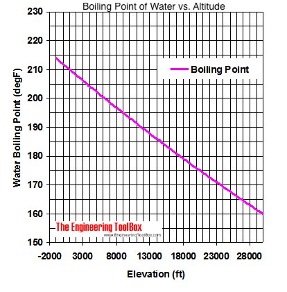

    I installed an electric fan in front of my condenser operated by a 6-auxiliary switch panel in the cab. It does help the AC and the engine temp quite a bit while driving slow. Turning on your heater works well in a pinch also as mentioned.
    There’s also another reason why you may have boiled over, depending on the elevation you were at, and if you’re running the right ratio of coolant and water in your radiator:

    As caribe pointed out, it won’t have the terminals in place. The CDS fan relay is in the little box hanging off the side of the main box. Terminals could be added and wires run out through the bottom of the box. I just added the TSB condenser fan (for AC, not for any sort of added engine cooling and MT so no transmission cooler), and I found it easier to use my own relay located elsewhere. I would have definitely liked to run it exactly like stock but the juice wasn’t worth the squeeze.
    Controlling the fan like stock is quite easy, two wires in the cab to do it like the TSB if that’s what you’re after. The TSB controls the fan like the stock Mexico-destined trucks, it just doesn’t use the exact same ign circuit for the relay activation. But it functions the same using the same output from the AC amplifier to control the turn on.
