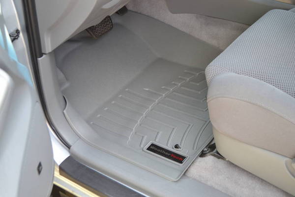

    Weathertech's (Digital Fit)- Grey front and back

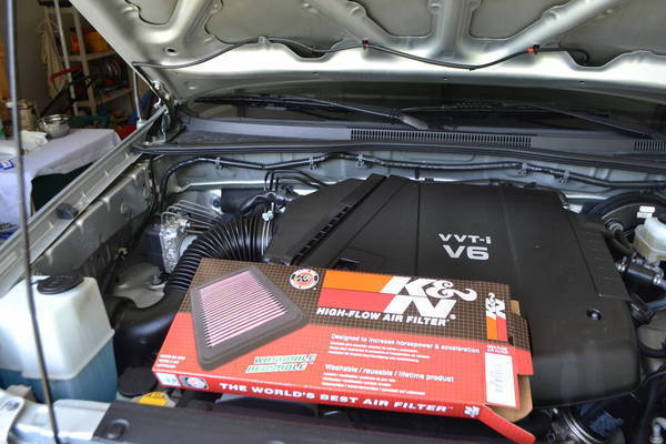

    K&N Drop-In Filter

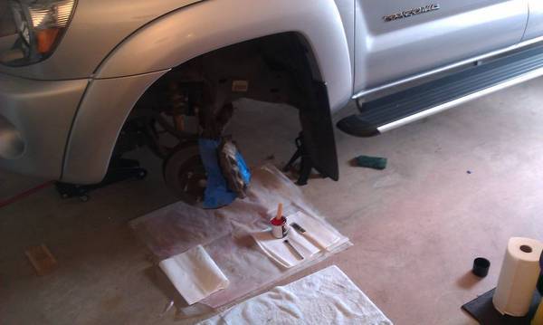

    Red Caliper Paint Kit

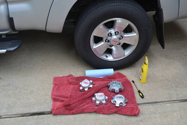

    Red "TRD" FJ Cruiser center wheel caps

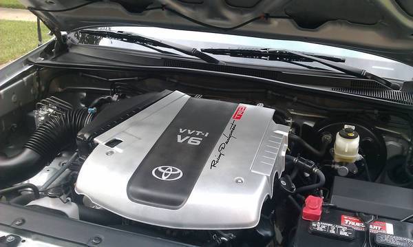

    Painted Engine Cover and added decal

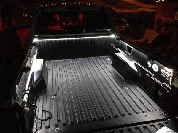

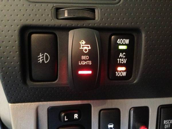

    Bed Lights switched from the cab via a custom Otrattw Carling Switch

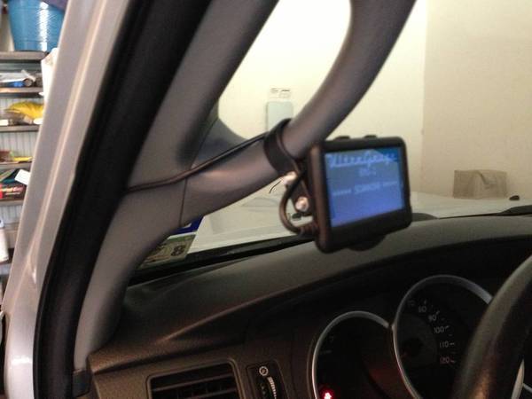

    Ultragauge and "bike reflector" mount

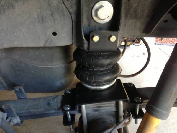

    Picked up some Firestone Ride Rites for towing, carrying heavy loads. Stay tuned for updated install pics.

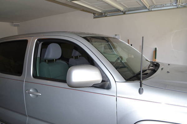

    Added the shortie antenna:

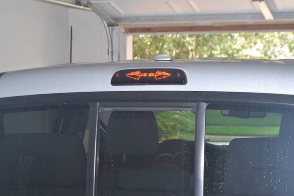

    Next the Sockmonkey 3rd Brake Light Decal:

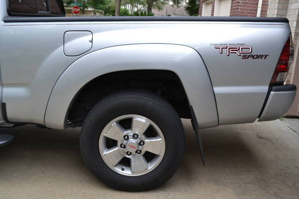

    Before caps:
    After caps:
    During the process. Very easy to switch out with no extra mods needed:
    Sorry for the lame picture of the K&N box, just don't have much to add right now. ;)

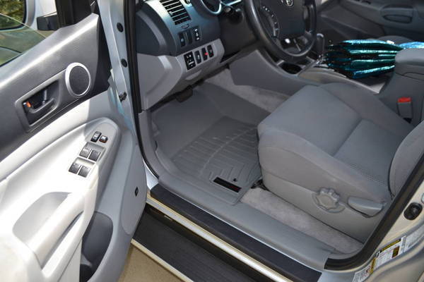

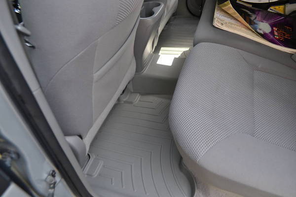

    Next are the Weathertechs. Went with the grey ones front and back. Love them!

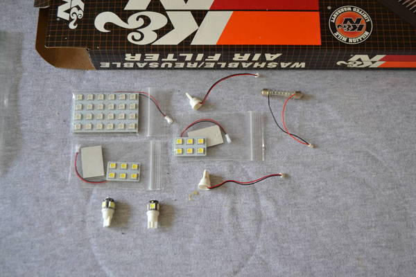

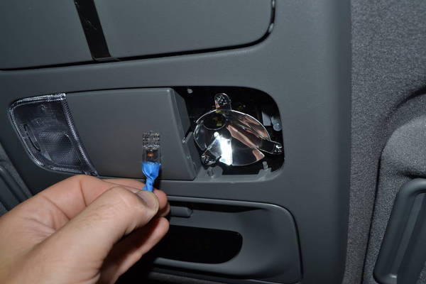

    Next was the interior LED lighting! Definitely an easy mod with great results. I went with two white led's for the map lights and one red led for the dome light as well as the license plate two white led lights included in LEDsolutions stage II package.
    Edit: The map lights have completely stopped working. Replaced with Superbrightleds.com's.
    Here is LEDsolutions stage II kit:
    This is the method I used to get out the map light bulbs....tks to SalmonTaco for the idea:

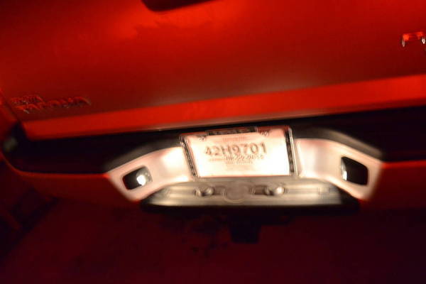

    Before of License Plate stock bulbs:
    After License Plate Led's:

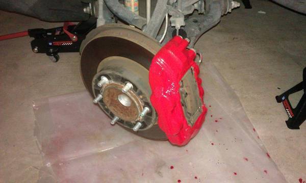

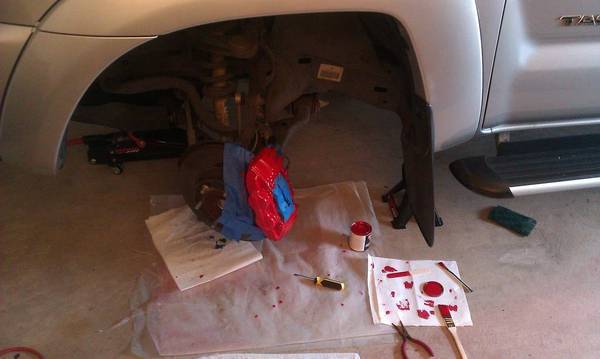

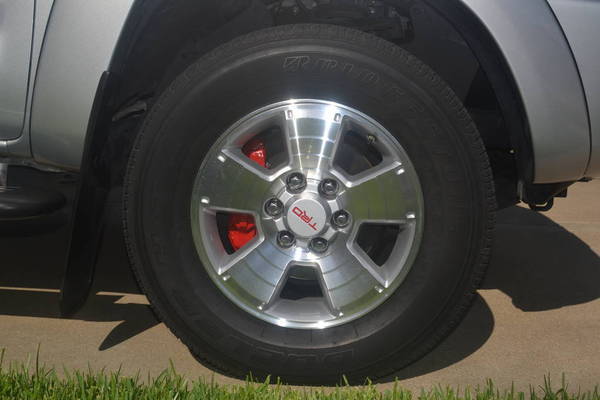

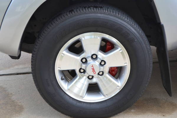

    Next came the red caliper paint kit. I know it's ricey and I don't care. I liked the way the red ties into the trucks stock red/black badging and pin-stripping as well as the red center caps and interior lighting. Silver truck with hints of red throughout is taking shape.

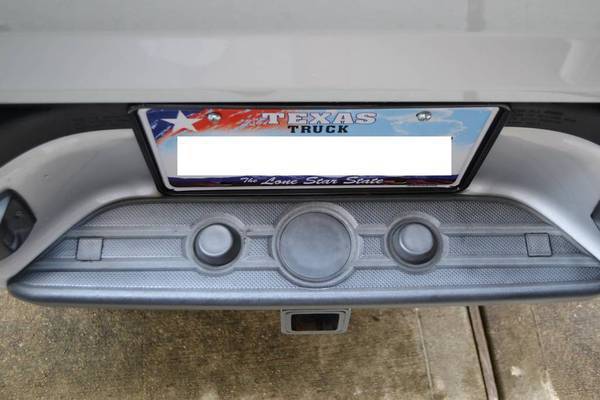

    Next up was the high performance, fuel efficient "sticker" mod:

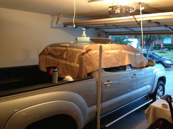

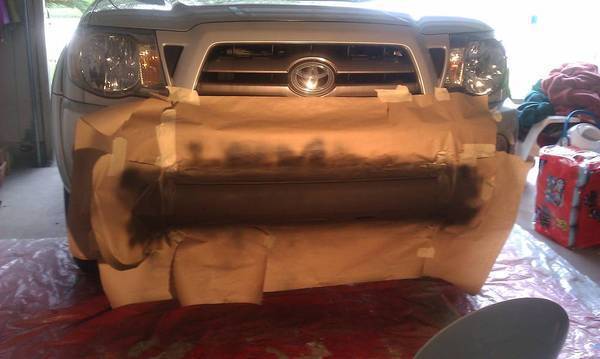

    Plasti-derped the front valance:

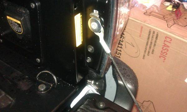

    Next up was the Tailgate Lock mod including the dual washers on either side of the tailgate supports:

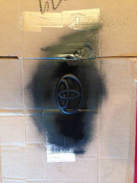

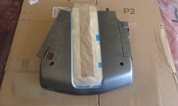

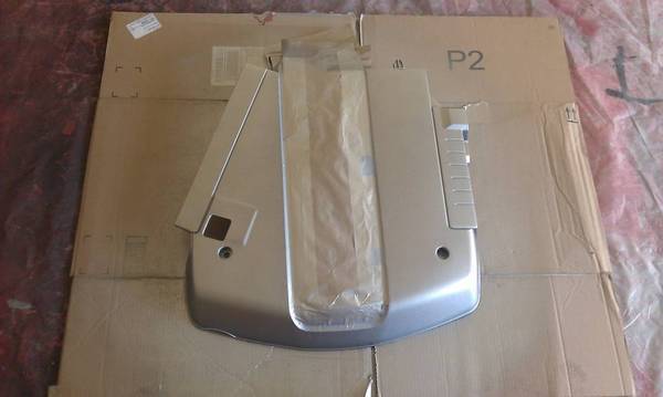

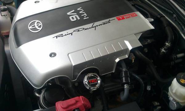

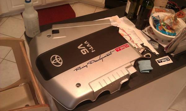

    So after my wife accidentally ran over my first painted, finished and drying engine cover, this was my attempt at number 2:
    Added a new Oil Cap:

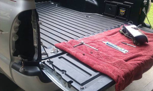

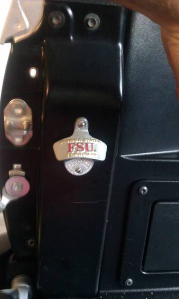

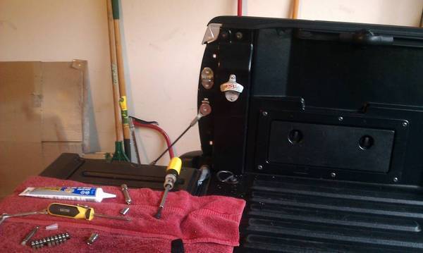

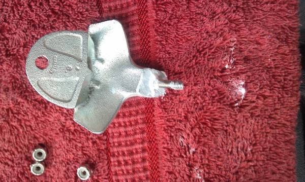

    Next was the Bottle Opener in the bed addition:

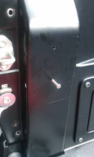

    removed the tail light for access to the back of the post so I could install the hardware:
    Used some silicone to seal up the new holes/hardware:

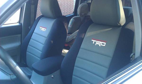

    Added some Wet Okole's!(black and charcoal)

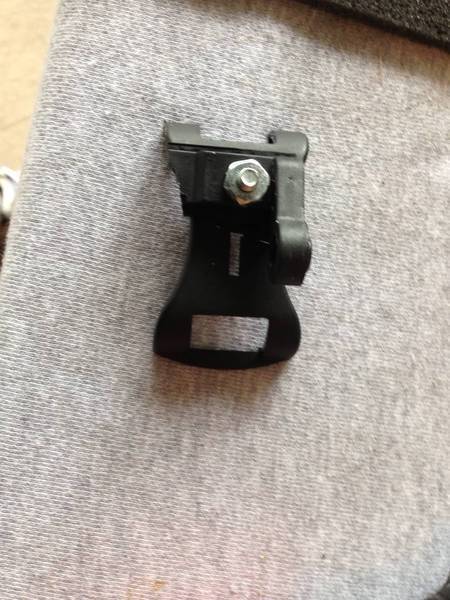

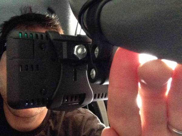

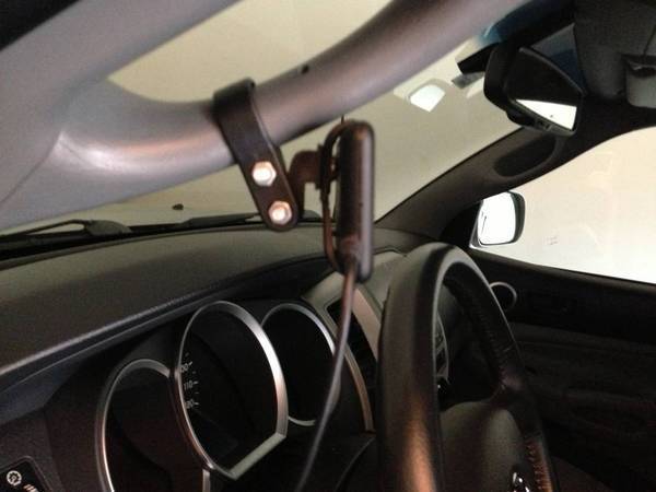

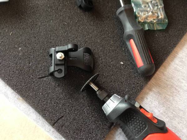

    Next was the UltraGauge addition with modded bicycle mount. Here's a link (12/11/2012) to the hardware I used which includes the appropriate horizontal side-loaded mount for our Tacoma A-pillar's: http://www.amazon.com/Sunlite-Piece...e+4+Piece+Bicycle+Reflector+Set+with+Brackets
    The standard bike reflector mount (as shown) didn't work right due to the pitch after attached to the A-pillar. I got lucky because included in the package was another horizontally based, OFFSET to the right mount instead of this vertically based one:
    This is the offset or horizontally based mount which allows clearance between the hardware elements to enable the ultragauge to be tilted up to the correct viewing angle:
    Had to do some cutting with the dremmel to clean it up and get rid of the excess mount portion which WILL block one of the buttons on the back. Very easy to do though. You can see the initial cut line:
    Cut flush with actual UG bracket:
    Here it is mounted but prior to running cable clean. Because the hardware was side mounted, the UG is able to be angled correctly:
    Next was to run the cable down the A-pillar rubber protector and down to the OBD port. More than enough cable length and then wire tired up under the dash out of sight:

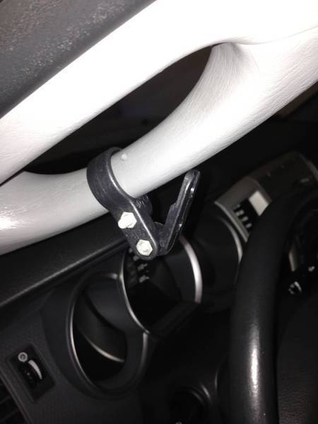

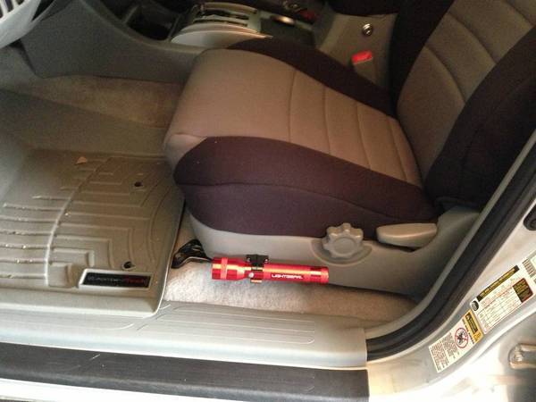

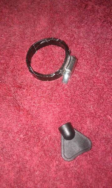

    Next up was the flashlight mount:

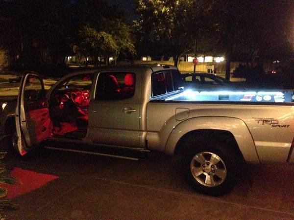

    Next up was my "Bed Lights Project". Click the link to my write up page if interested. http://www.tacomaworld.com/forum/2n...ed-lights-project-heres-lengthy-how-post.html

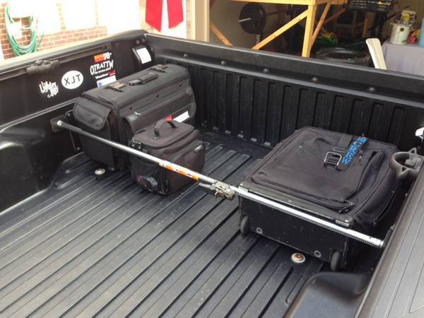

    Added a "cargo bar" so my bags don't slide around on the way to/from work. Worked out great for what I needed. $20

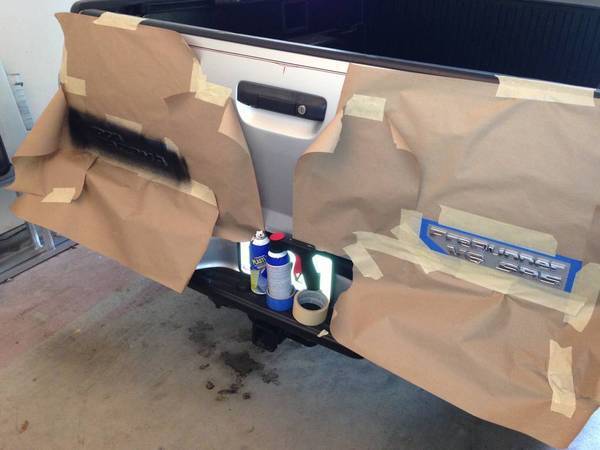

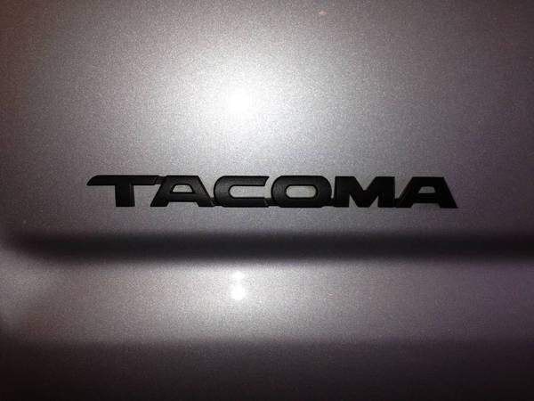

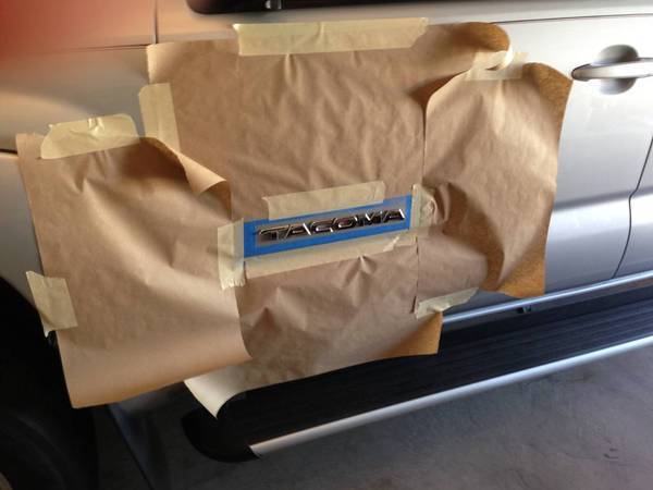

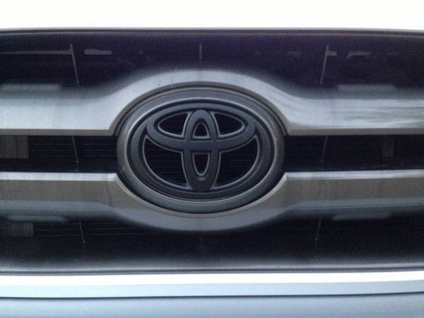

    Plasti Dipped Emblem, Badges, and Roof:

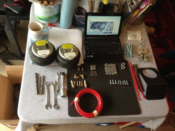

    Installed my Firestone Ride Rite's. These airbags will be great for towing. They added about 3/4 to 1" in height in the back with the min 5psi. With higher psi it raises the rear end significantly higher until a load is put in bed or towed. Looking forward to towing boats and travel trailers, etc. with these!! Knuckle busting install but easy none the less.

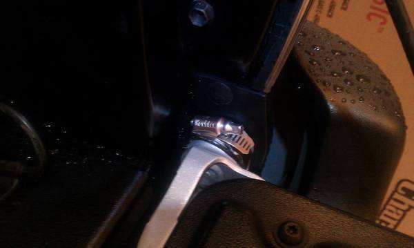

    De-badged, Painted grille emblem, Tonneau cover, Loud horn mod, Hose clamp mod

    when you did the badges did you tape in between the letters as well? Or just around? Started this project but taping between the letters became a PIA in the cold weather. Is it not necessary?

    As long as you are using plasti dip you dont need to tape in between

    is there a trick for removing the plastidip from the areas in between the letters....or do the raised letters naturally cause the dip to tear at the right spots when you remove.

    Monster nailed it. Be sure to use plenty of coats of the plasti dip. My brother in law only did two and had a nightmare trying to get it out of the letters. I overkilled with like 6-7 coats and it was easy peasy using toothpicks for the tight spots and tweezers for the semi-tight spots. The majority comes off due to exactly what you said, the natural tendency of the lettering. The thicker it is, the easier and more uniformly it removes.
    I actually have a video of me pulling it off for my brother in law. I'll post it later today when I transfer it over from my phone.
    Good luck-
