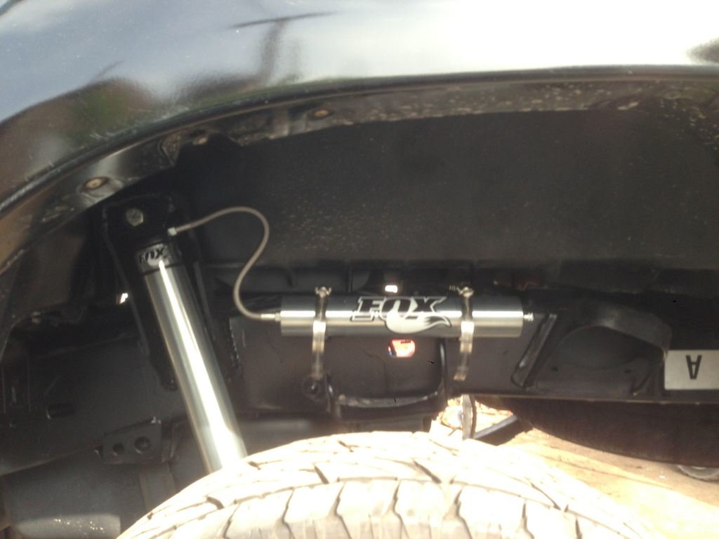

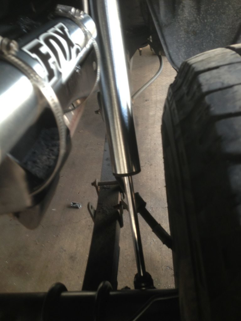

    Yeah I (Robert @ North Vegas Truck and Motorsports) was able to get the 2.5" Kings in there with a little modding to the bucket... A hole had to be cut in the top to allow the shock to move up and the bolt fit through...
    Added the Spidertrax to the just installed B.A.M.F. Shock relocation buckets, 2.5 King 12" stroke remote resi's and Deaver custom 5" lift pack

    If thats all you had to do to make them fit then i dont see why anyone cant get them in there. The truck looks bad ass by the way :thumbsup:

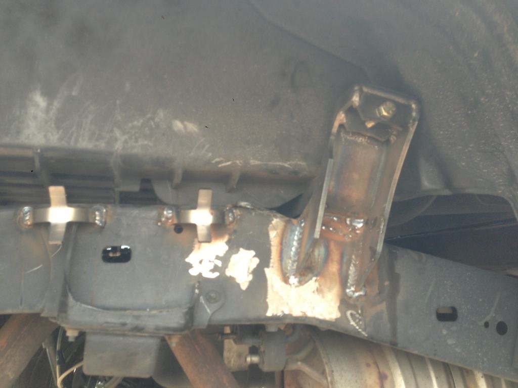

    This is where the mount had to be cut to be able to fit the 2.5's
