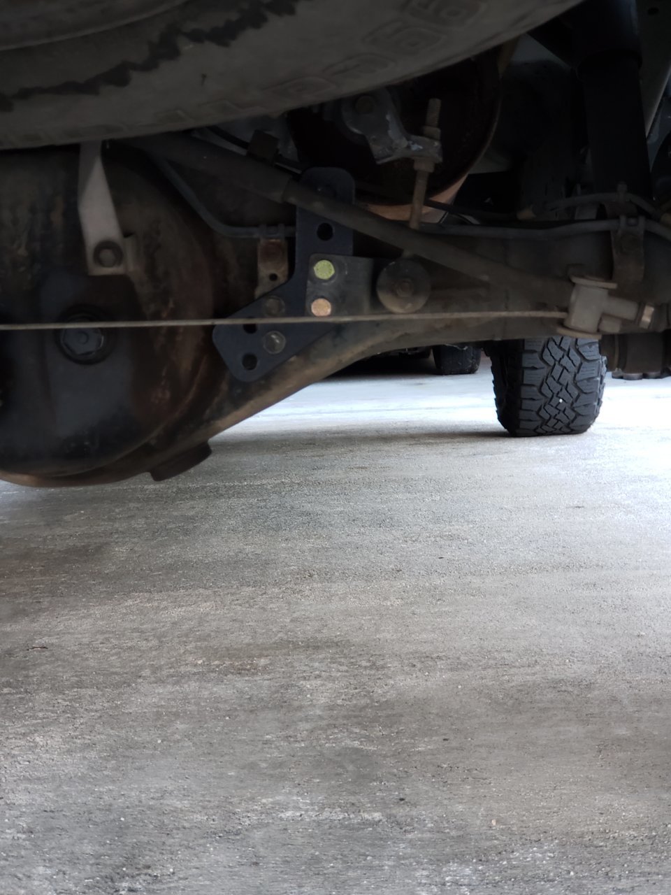

  13. Apr 26, 2019 at 1:21 AM
    #373
    trdproven
    trdproven Well-Known Member
    Sep 26, 2010
    #43834
    112
    20190426_182259.jpg Just installed my 3.5. Seems like the 1" setting needs to have the bpv installed in front of the bracket. If its behind, the bpv component is touching the axle and seems like the bolts are touching. I just wonder though so I have it on the front of the bamf bracket. There was some tilt to install the bpv with the bolts. That's ok yes? Not sure if the bpv is that sensitive or needs to be flat and installed in the back of the bracket which is its original mount location.

  14. Jun 17, 2019 at 11:46 AM
    #374
    cobes
    cobes habitual line-stepper
    Apr 12, 2019
    #289935
    376
    cobes
    slc
    2000 XtraCab TRD 3.4l Auto
    Random/dumb question. I'm having a 2" OME kit installed on my truck. Will I need something like this? And does it need to be done right at the same time as the lift?

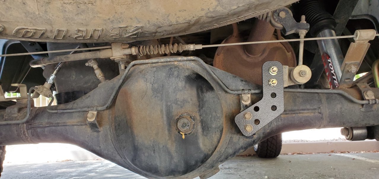

  16. Aug 10, 2019 at 3:49 PM
    #376
    itsmerandy
    itsmerandy Well-Known Member
    Dec 3, 2017
    #237599
    56
    Kentucky

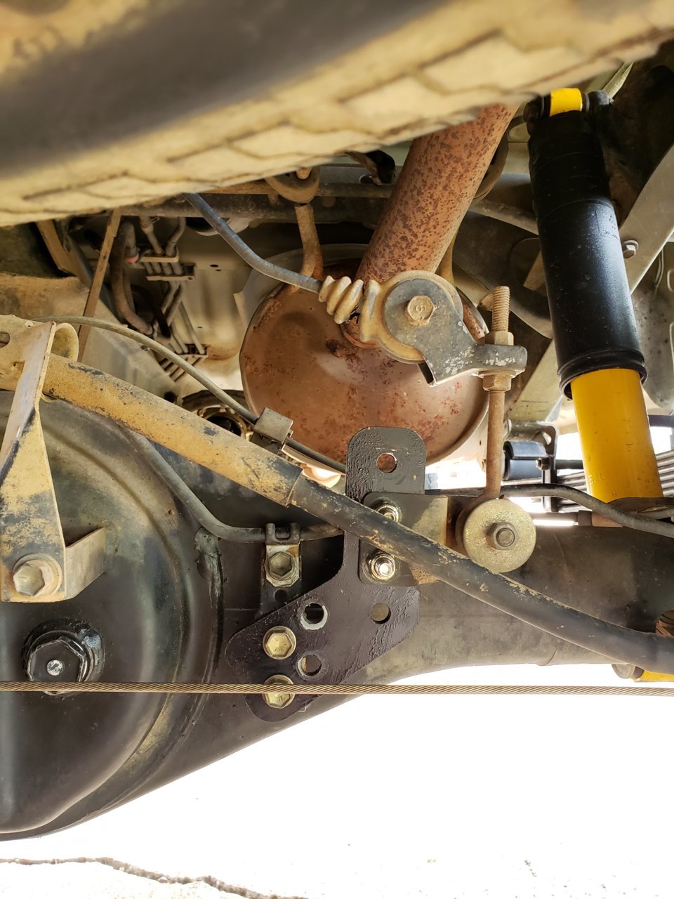

    Am I correct that this is set up for a 2.5" lift? I couldn't use the upper set of holes where the bracket mounts to the axle because the bolt rubbed against the hard brake line when I used the top set of holes for 3" lift. I have OME nitrochargers with Dakar leaf packs with an add a leaf in the rear. Distance from ground to center of fender is about 38" on both sides.

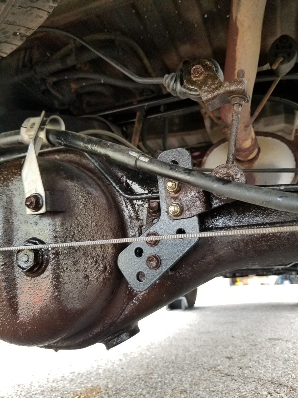

  18. Jul 18, 2020 at 6:08 PM
    #378
    jaywill808
    jaywill808 Well-Known Member
    Feb 6, 2016
    #177304
    69
    2001 Tacoma
    Just installed mine today. Not sure what setting to use or how to test that its correct. I essentially lifted the arm till it was topped out. Wouldn't this 'simulate' load in the bed causing more rear brakes? My tires definitely aren't locking up when I brake.
