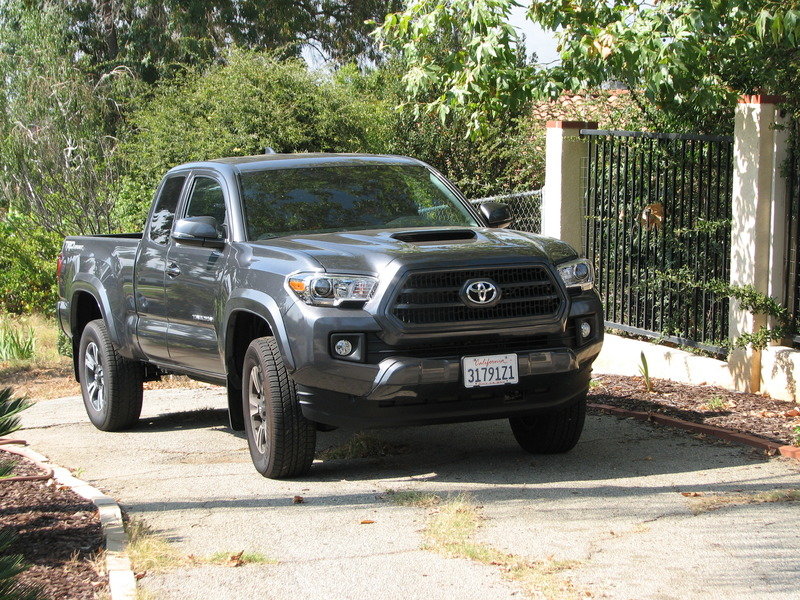

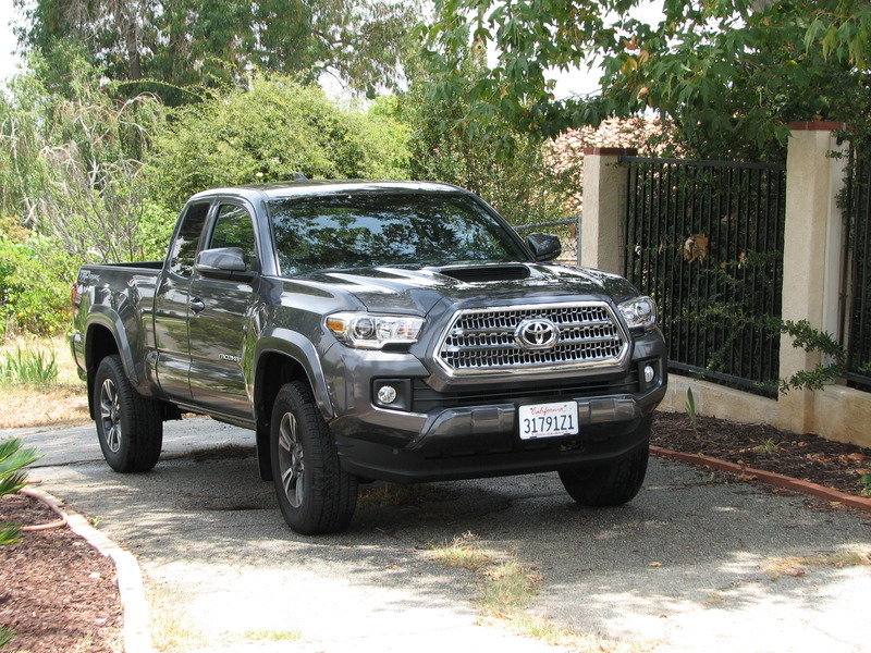

    My sincere thanks to @3dBdown for starting this thread and documenting his process. After some life delays I finally got around to painting my Sport grill black with MGM trim. I purchased the same products, followed his methods and the results turned out great. I am very pleased.
    Pics or it didn't happen...
    Before:
    After:
  10. Jun 13, 2016 at 10:22 PM

    Looks great. Added your pic to the OP. Also, nice looking truck! Something about the access cab stance makes it the most truck looking of all the configs.
